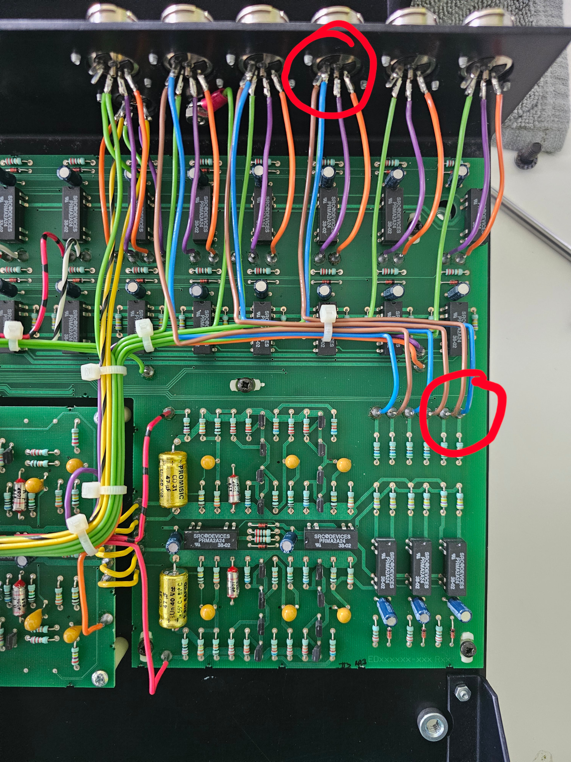

As for having your 252 serviced, personally, I wouldn’t bother. Mine is circa 2002, so a really early one. I had it serviced this year, after 23 years. I had Naim change the volume pot and logo (bleeding) as part of the service. But to be fair, I can’t say I can hear any difference. But at least I know it is done.
Naim didn’t spot an original wiring mistake. Apparently, it couldn’t have passed testing as it was. But it did, twice.
