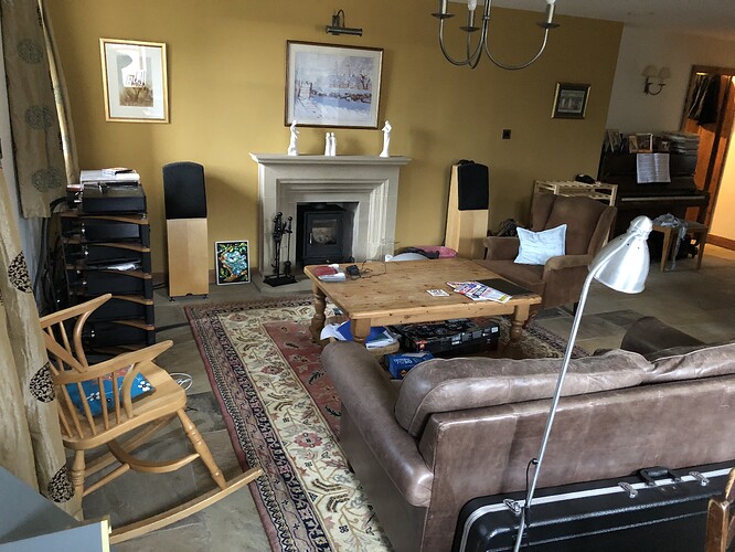

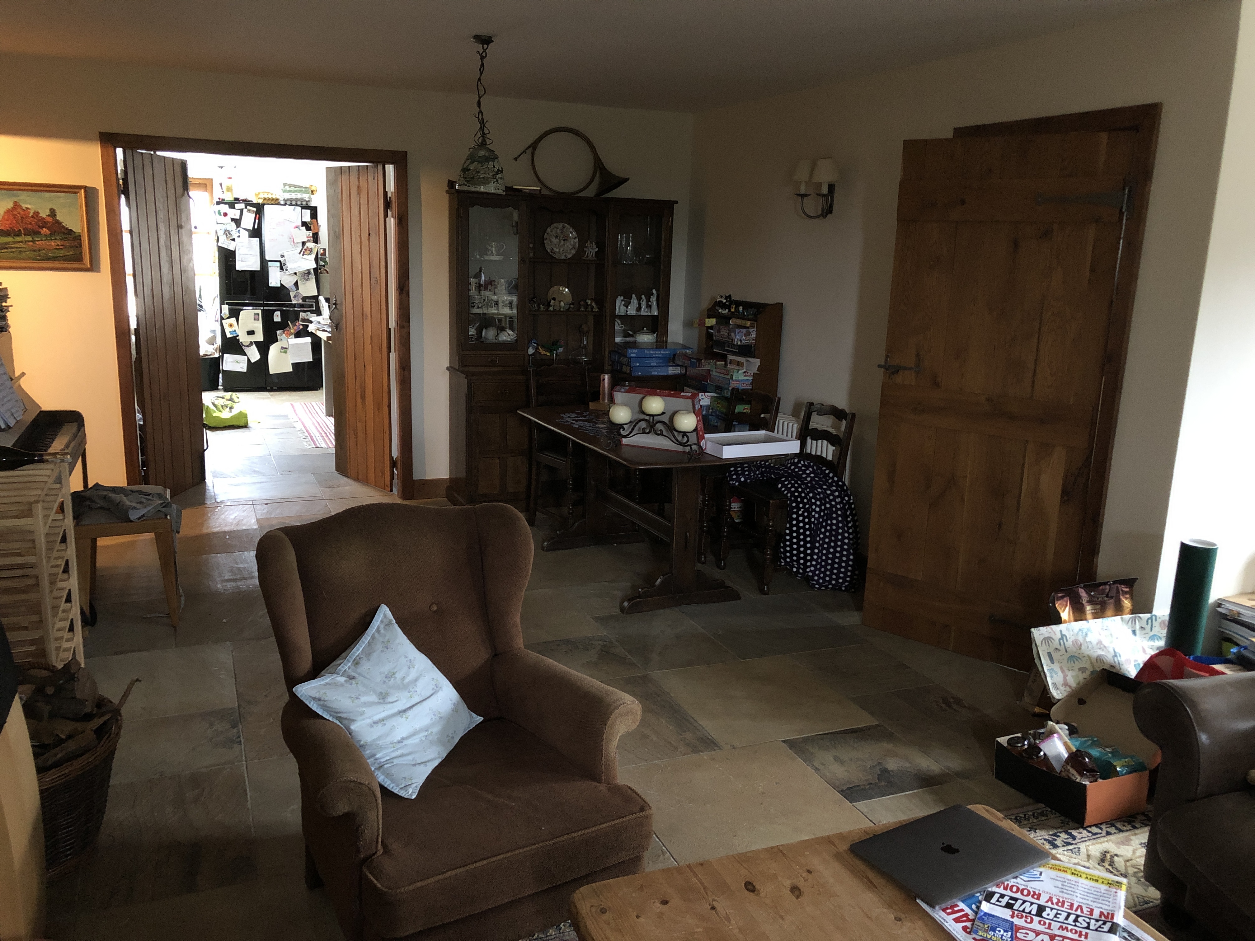

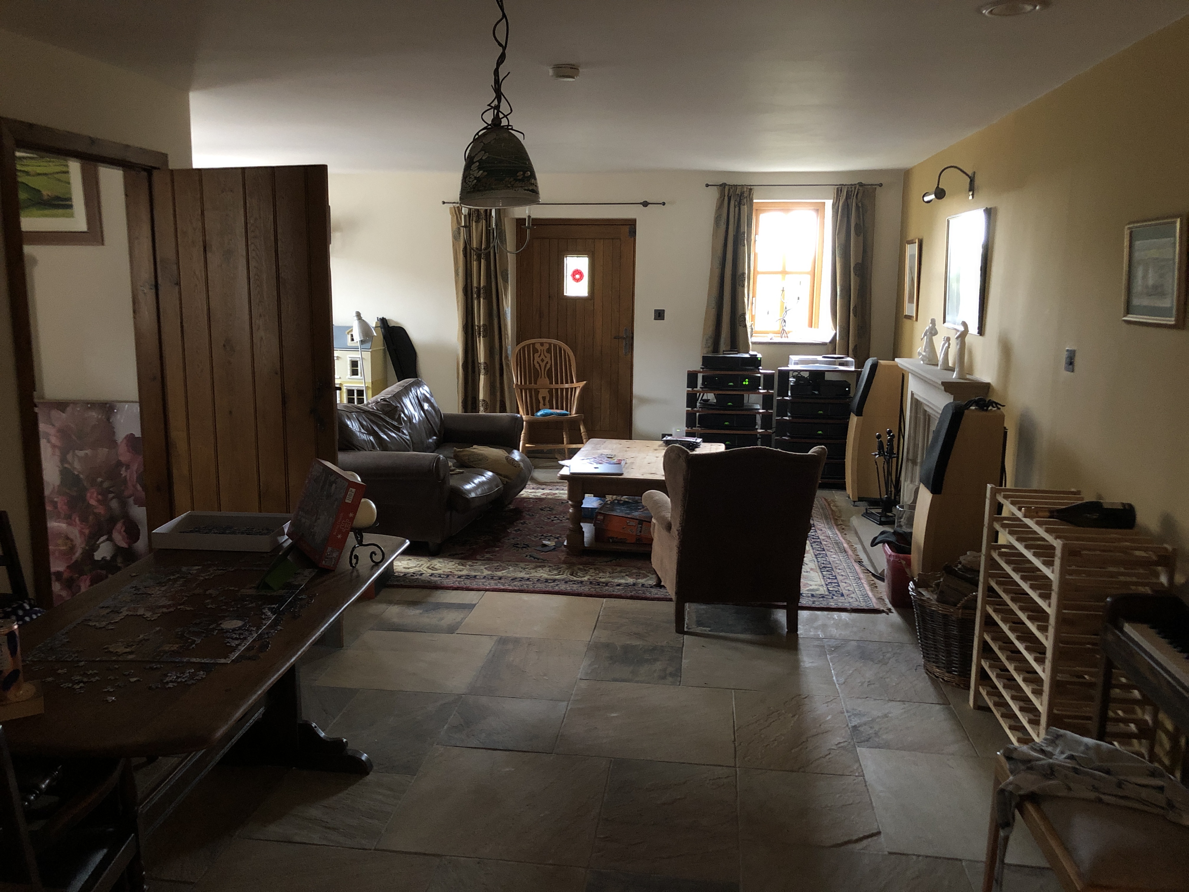

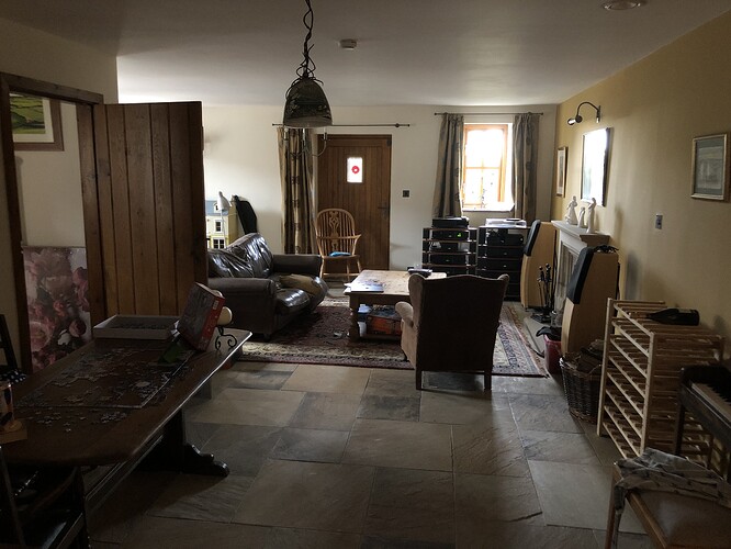

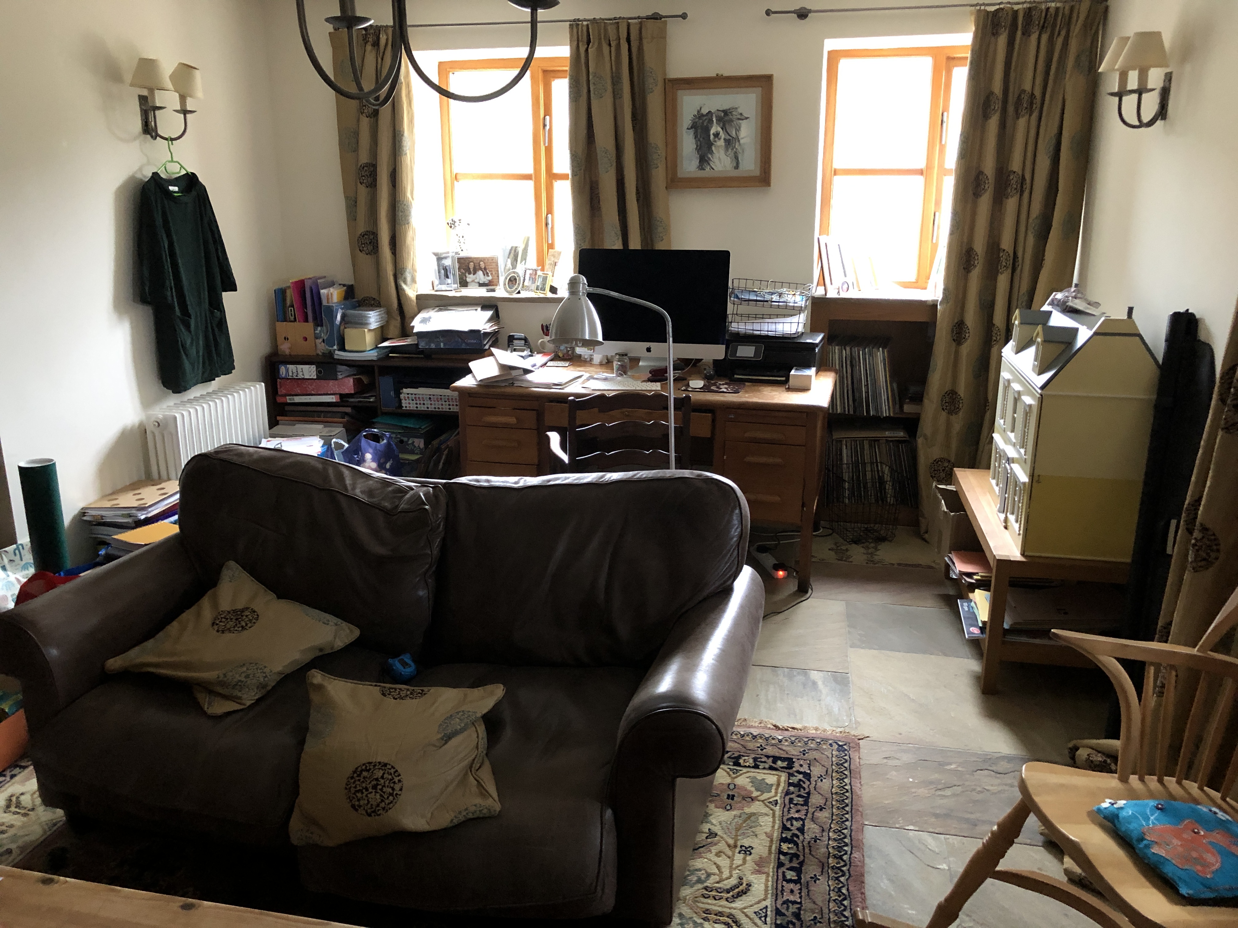

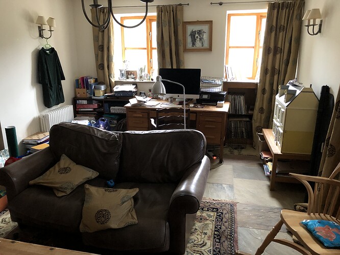

Hi Tim, how big is your room and how are the penguins playing into it, also any acoustic issues worth mentioning and also how far are you sat listening from them? ATB Peter
Hi Peter
The room is L-shaped, or perhaps it is easier to say that it is about 25 feet x 19 feet with the staircase nicking a corner (12 feet x 6 feet). The speakers are on the long wall firing in the 19 feet direction from the heel of the L.
It seems pretty good acoustically despite the stone floor tiles - the irregular shape helps and there is a fair bit of furniture and heavyish curtains. At the moment the my ears when sitting on the listening sofa are about 10 feet from the front of the speakers. There is a bit of scope to move the sofa back a foot or two but then there is a desk
Hope the photos help and that it’s self evident what is where
