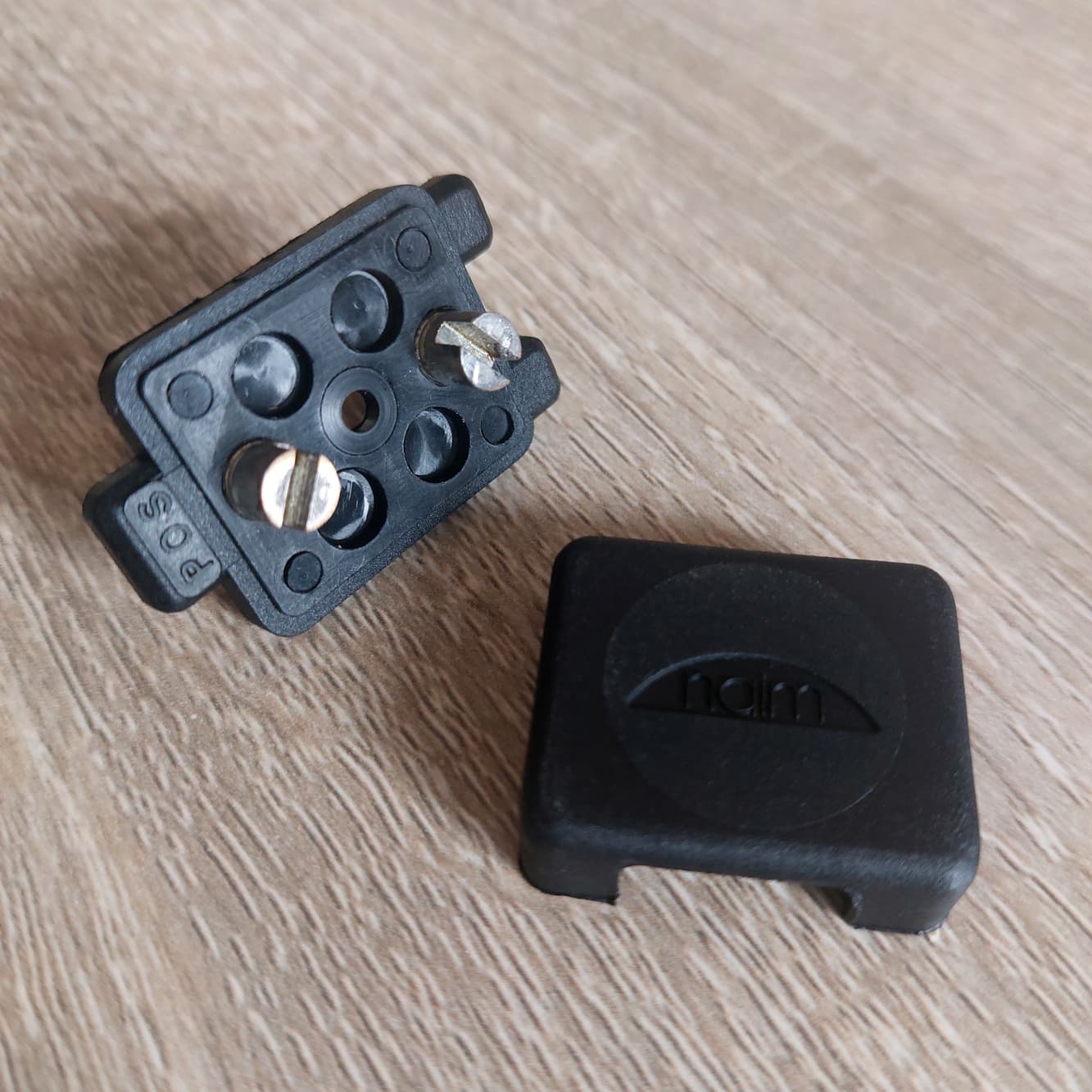

A big advantage of Naim’s own SA8 plugs is that the sticky-out bit always goes on the outside, so you can connect by feel in situations when the back of the amplifier cannot be seen, and you can’t get the speakers the wrong way round.
Hmmm, two of my SA8s (on my 250s) have the single sticky out bit facing outwards, and the other two have them facing inwards. OTOH, the ridges on all four cables are on the outside, i.e +ve, and they are correct at the SBL ends.
Excellent tip thanks HH!
Still confused. So does the double sticky out bit point outwards, or single, or is it just a piece of plastic and doesn’t really matter as long as the polarity is correct
The single bit should be on the outside. From memory it has a + on it.
The back part of the plug shows POS for the positive + (red) side of the cable. The design allows it to be flipped 180 degrees for the other cable connection where required.
Very useful for amps sitting on the bottom shelf of the rack where NAC A5 just doesn’t want to bend easily. Of course it can be forced into a right angle but I find a nice arch much more satisfactory.
