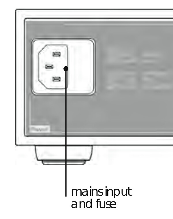

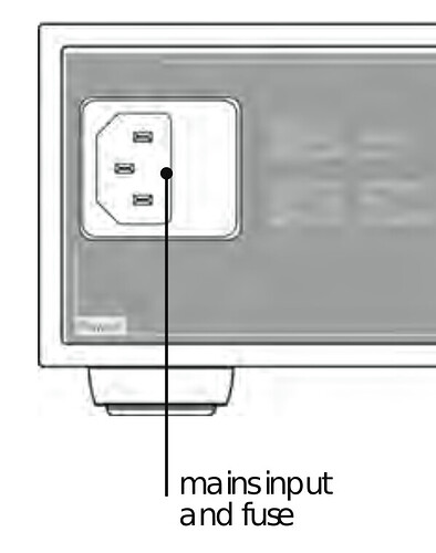

Hi @Guinnless, thanks for your help. I wasn’t aware of any other fuses, is the pop out on the 500 main body or it’s ps and do you know what type of fuse it uses, I’ll have to order one in pdq.
It’s on the PS next to where you plug the mains cable in. There should be a spare in there too.
The label will tell you which fuse type it is.
What Guinnless said. To the right of the IEC socket where the Powerline goes, there is a plastic cover that you can slide out.
The fuse values are printed onto the cover. After sliding out, it contains two fuses, the live one (which is the one further inward) and a spare. Also see FAQ https://community.naimaudio.com/t/equipment-fuses/7998
I don’t know which fuse value the 500 requires, but the fuse is most likely as follows:
Manufacturer: Littelfuse
Series: 213
Type: Antisurge (“T”), slow-blow
Rating: Not sure as I have no 500. It is printed on the fuse cover and stamped onto the fuse itself. Probably 3.15 Ampere like the 300PS and 555PS, which would be Littelfuse part number 02133.15MXP.
(Smaller units have 2.5 Ampere like the XPS and SuperCap, which would be the Littelfuse part number 021302.5MXP)
Your Naim dealer can supply (or there are shops like www mouser dot com). Get a bunch as backup
