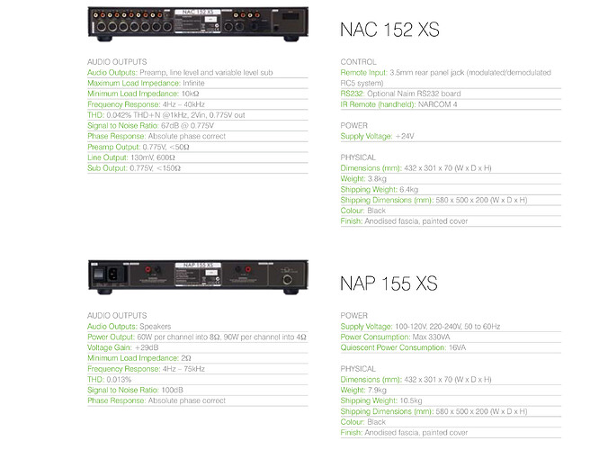

When looking up specifications of the 155XS (noting it too is 2 ohm stable) I noticed that both it and the matching NAC are referred to as ‘Absolute Phase Correct’ in the XS brochure. See the screen shot below. Interestingly, the XS integrated is not referred to as phase correct in the same brochure.
I also noticed this being referred to in a review of the 5si when it was measured (possibly by John Atkinson). This led me to wonder if being phase correct is a feature of all Naim amps?
I’m well aware of the potential impact of phase shifts as a feature of passive crossover slopes in loudspeakers so does the same apply to amplifiers? If so, and assuming that Naim amps are all ‘Phase Correct’ (non-inverting) does this help explain their timing abilities and also their ability to present instruments as a cohesive whole within the soundstage?

Hi @AlexP and @Christopher_M ,
All Naim sources, pre-amps, power amps, etc., are absolute phase correct — i.e., they do not invert phase.
When a positive sound pressure wave is recorded (e.g., from a kick drum), the entire system will reproduce a positive pressure wave, rather than a rarefaction (negative pressure).
Rooms, acoustic instruments, and ear canals are not perfectly symmetrical in their response to positive and negative pressure waves. Some listeners are sensitive to this asymmetry; others are not.
If you’re curious, it’s easy to test: choose a live recording (not synthesised), listen normally, then reverse the polarity of both speakers — red to black, black to red. This will cause the speaker cones to move inward instead of outward, and vice versa.
Other subtle effects may also influence the sound, such as even-order harmonic distortion from the speaker interacting with the amplifier’s distortion phase — potentially cancelling or reinforcing.
A small minority manufacturers have absolute phase inversion, possibly due to circuit simplicity. i.e. their circuit may inherently phase invert. Rather than adding a second stage to correct phase, they leave it inverted. Some reverse speaker terminal colours to compensate. About 30 years ago, phase buttons were common on DACs.
Note: absolute phase is distinct from phase shift with frequency (caused by filters). Absolute phase refers to a full 180° flip — not a gradual shift.
