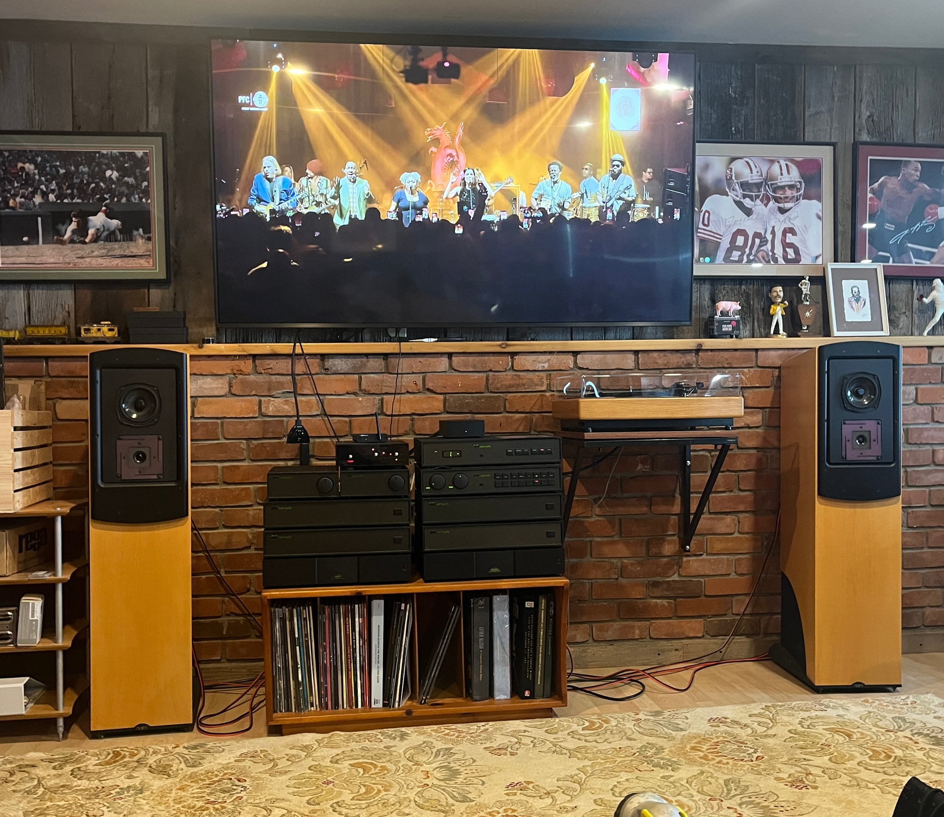

When it comes to Active are the NBL’s closer to the SBL’s or the DBL’s in sound reproduction? I’m asking this because I loved my two way active SBL’s but I sold them for a three way active NBL’s setup. Had a very difficult time getting them to sound right. Unless you’re touching the back wall the base is pretty well non existent. Are the DBL’s as finicky as the NBL’s when setting up?

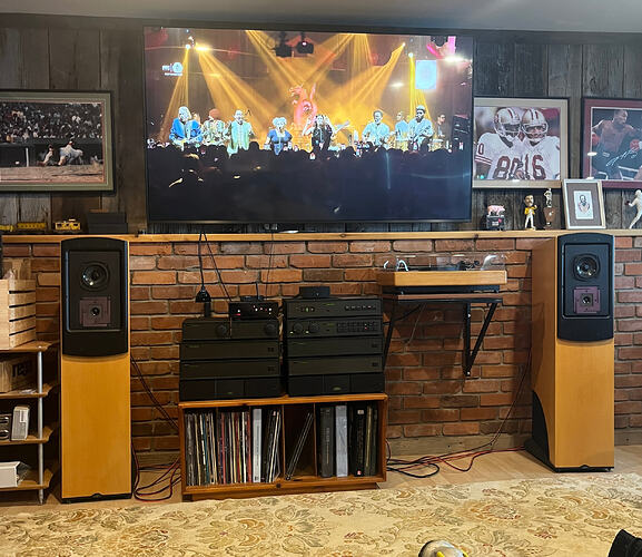

If your photo is representative of your installation, then I would be concerned about the side-firing bass being lost into your hi-fi racks, especially on the left hand side.
