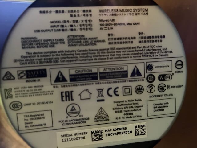

Here’s the information for my Mu-So Qb 1st generation.

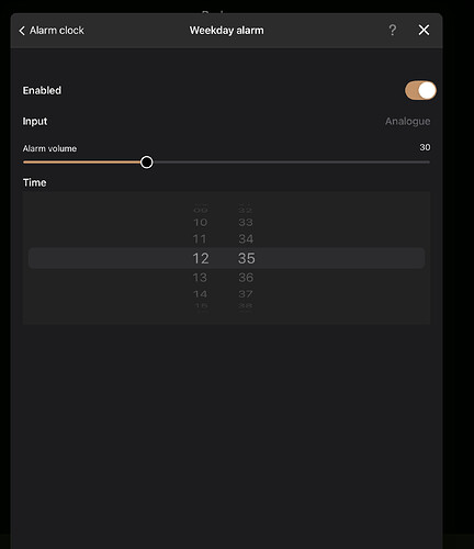

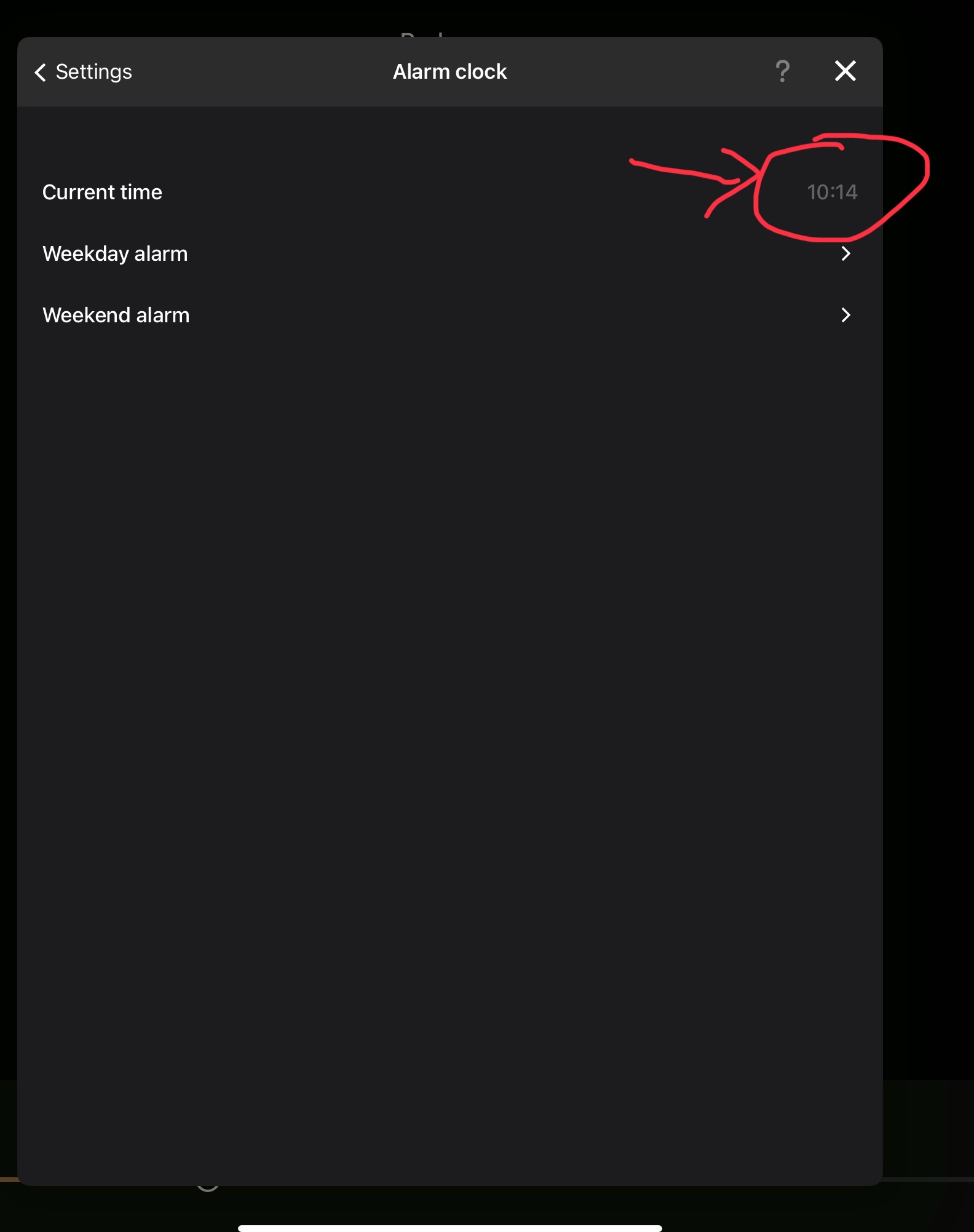

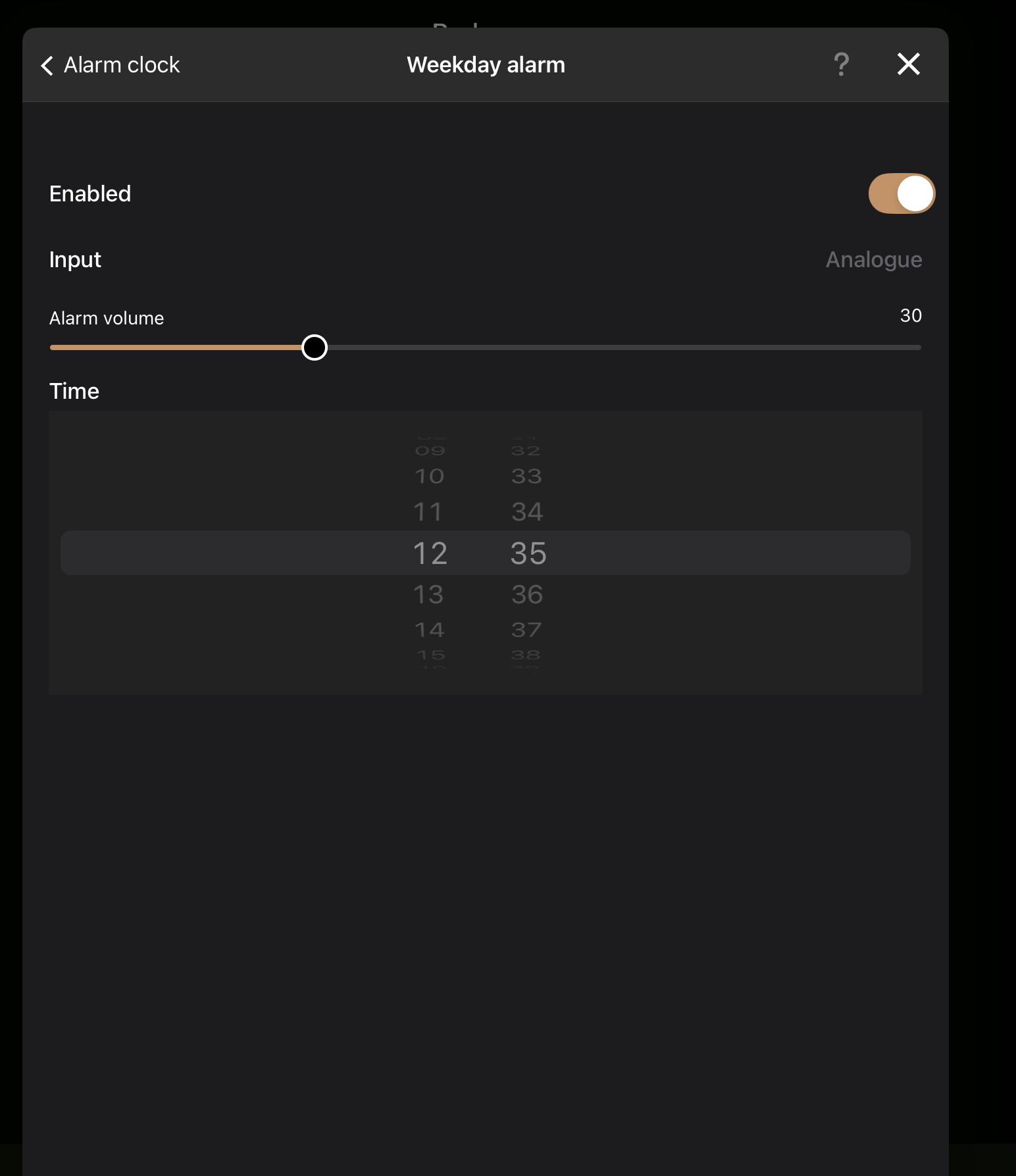

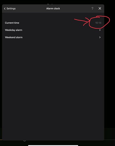

  1. In the app ->settings → Alarm Clock, make sure the correct time is shown:
Next up, check the alarms (weekend and weekday) and make sure they have a valid time + the radio preset used is valid. As we switched radio service it coukd be a case that its attached to a broken vtuner radio preset

Great, the alarm is working properly! It was when I changed the Vtuner that the problem was impossible to fix. But the time is displayed correctly now, and everything works.
