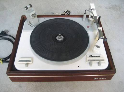

And beware idler wheel turntables. The work of the devil I tell ya.
