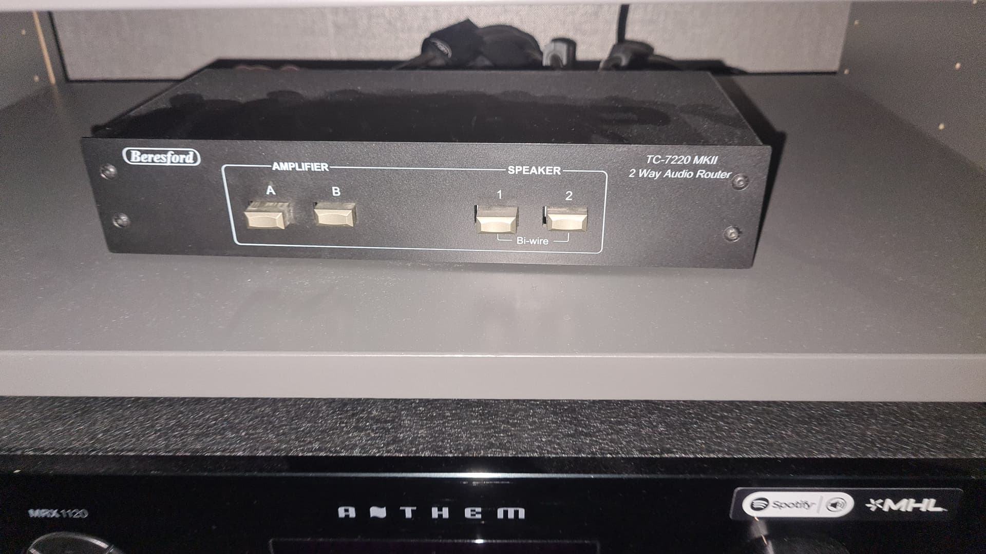

I use a Beresford switch. I have two sets of speaker cables from amps to switch. And then two sets of speaker cables from switch to speakers. It means I have two sets of Superlumina speaker cable. I have another set of speakers in the conservatory.
It gives me flexibility: it means I can use an AV amp and my 500DR in the listening room and then listen to music in the conservatory.
The Beresford switch is not powered. It is just a switch box.

The Beresford switch is unpowered and just joins cables together, allowing you to manually switch between two sets of speakers and two amps.
It works well for me and I cannot tell the difference.
