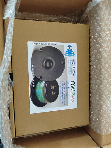

Following a tweeter problem (out of order) on one of my Allae speakers, I decided to replace the pair. Since the Scanspeak D2008/851100 was unavailable, and not wanting to modify the flange of a new Scanspeak D2008/852100 tweeter, but rather wanting to try a pair of Hiquphon tweeters, I embarked on this adventure. The replacement was very easy.
However, after a few hours of listening, the enjoyment is still lacking. Yes, they work, but I no longer recognize my speakers: they lack life, bass, airiness, liveliness, and definition, and the sound is ā€œdullā€ (dark). It’s the complete opposite of the Allae’s character. On paper, the Hiquphon OW2-90s are supposed to be better than the Scanspeaks, but in reality, it’s quite the opposite. It makes music: it’s very textured, with a very dense, refined, and precise midrange, but the soundstage is barely higher than the speakers and wedged between the two towers. The listening experience is bland, lifeless, flat, and linear. Nothing extends or rises in the treble. Have any of you experienced this with these replacements?
