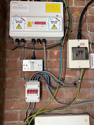

Please forgive me if this is too much of a diversion, but I thought people may be interested, and it’s not worth its own thread.
When the solar was installed, the work was inspected by an extremely thorough gent from Napit. He picked up a few things that needed changing, the biggest change being us getting a new current spec consumer unit. We were told there were a ‘couple of bits’ to finish off, including a full electrical test to enable certification.
Those ‘few bits’ were done today. One thing I wasn’t expecting was removal of my antique Henley block, installed over 25 years ago to split the tails when I had a dedicated consumer unit installed. Apparently because we now have Solar, the Henley at 100A is insufficient. It’s been replaced with a splitter/isolation switch thing, which looks very flimsy but is rated at 125A. New regs will require this, if they don’t already. It means we can isolate the whole house with one switch rather than two. It seems totally unnecessary, but is needed to get the official sign off. How electricians keep up with all of this I’ve no idea.
I’m not sure quite which but you mean and I can’t find the photo you posted before after the installation had been done.
But assuming you mean the grey box with what looks like four red switches on the front, another reason for putting a switch in like that is that it completely enables the consumer side to be turned off when subsequent changes to your electrical installation are made. Electricians are not supposed to touch the main fuse for the house and it’s obviously inconvenient booking the DNO to come and pull the fuse, then come again later to plug it back in and seal it again.
I only have the one consumer unit and no solar installation or heat pump, but I still got the electrician doing my consumer unit upgrade to put in an isolation switch instead of the Henley Block (which was no longer needed anyway).
Apparently a switch should have been installed in the meter box when the smart meter was installed by the DNO but wasn’t. When the consumer unit was done a few weeks ago, and again today, the electrician pulled the main fuse. It’s just not worth the risk working with a live feed. The new box has one big switch that takes everything out. It’s good to know that we now have a way of turning everything off; we now have so many isolation switches it’s unbelievable. The new switch replaces the Henley block at the bottom of this picture.
Yes I see. The electrician pulled the main fuse but he shouldn’t have done because it isn’t permitted.
Anyway that’s why they fit these isolation switches now. An electrician will never need to pull your main fuse ever again, unless he’s working on the meter, in which case he’s trained and allowed to pull the main fuse.
You can’t safely disconnect a cable from a Henley block that’s live, is the point.
