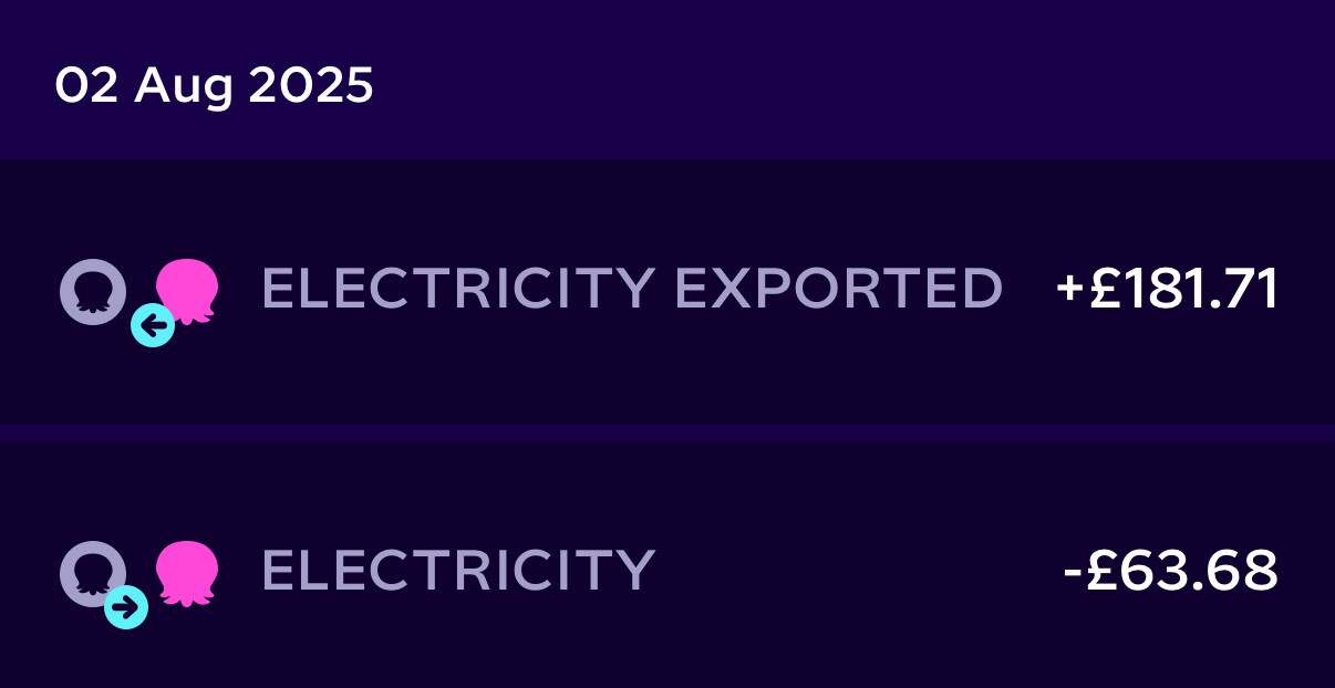

Our best month’s net surplus yet. It’s like putting on fat to get through the hard times of winter.

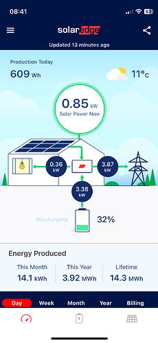

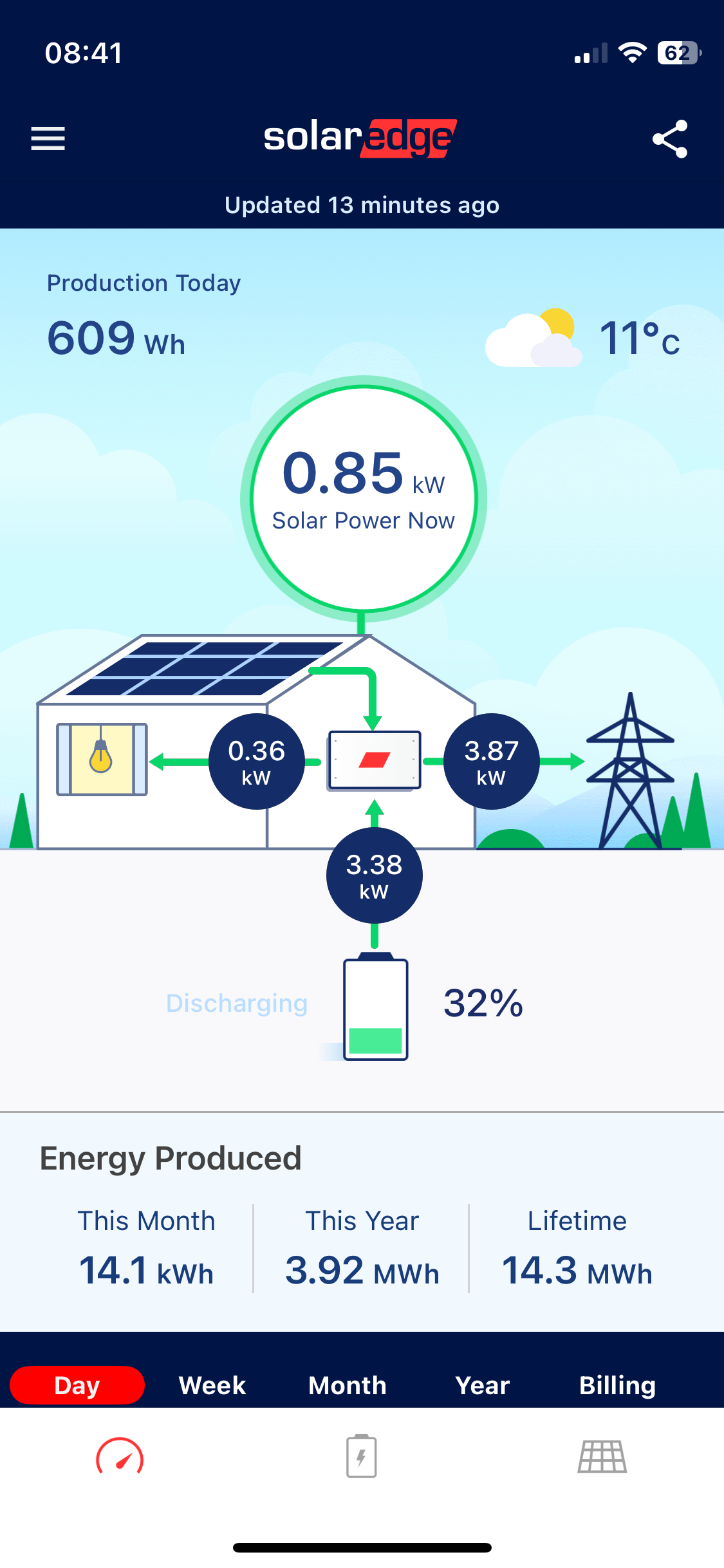

Yesterday after 27 days with a faulty inverter the new one was fitted. This morning I was able to control the battery to charge from and discharge to the grid.
Probably cost about £150 in higher cost imports and lost exports :disappointed_face:. The upside is that I have an inverter compatible with the backup interface allowing me to be off grid. I could also build in some redundancy with a follower inverter. I’m told the manufacturer changed its ERP system affecting business logistics for parts. Hopefully the delays will be shorter if it happens again.
