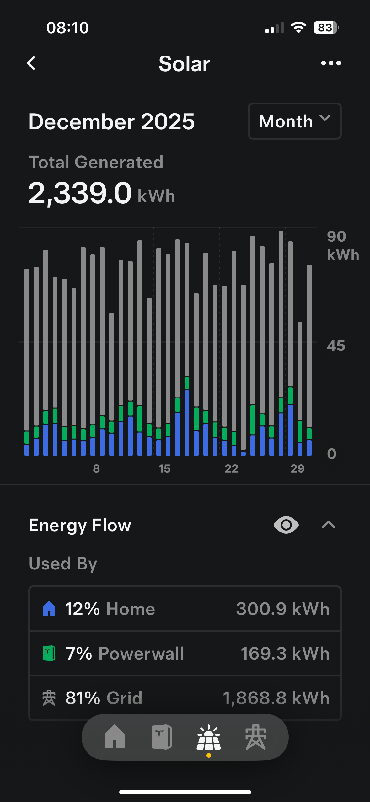

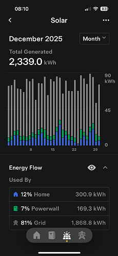

This is how December looked like for us, with a 14kW system.
I’ll report back after June (dead of winter here) for comparison.
Out of interest, how does it work in Oz? How much do you pay for power, and get for power you export? We pay 8p per kWh for six hours off peak (which we use to fill the batteries) and 33p for the rest of the day. For export we receive 12p. Prices have risen recently due to the Middle East shenanigans.
The 5p went to 8p overnight, but the 12p ( export) didn’t go back to 15p. I read the argument buy it didn’t make much sense.
We are not importing anything (single powerwall3 battery), except for when the system decides to “calibrate“ and depletes the battery on purpose. The price we pay then is $0.4/kW. We do export though, a MW a month on average. And we sell that MW @ $0.02/kW or for 20x times less than we buy for.
