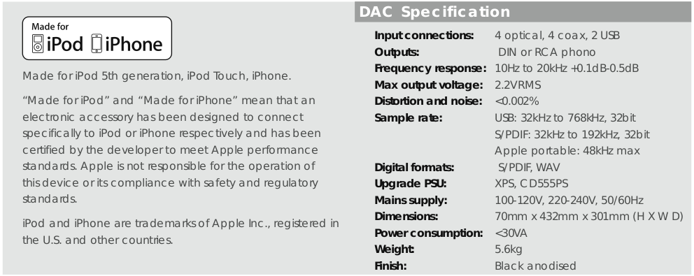

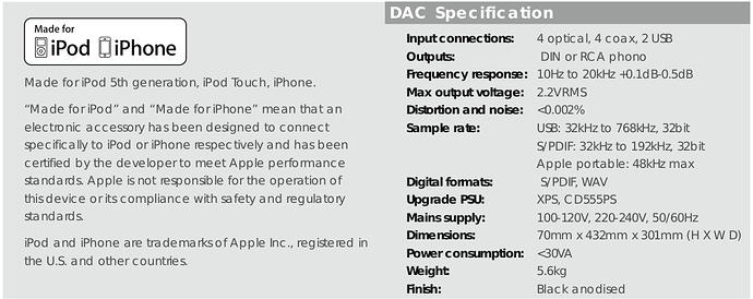

Only when connected to an Apple device, in which case the sample rate is constrained by the Apple device *, unless you work around it, as pointed out above by No Quarter, or as discussed here.
Otherwise, the DAC supports up to 768kHz / 32bits via USB.
* At least that was the case with USB via the Apple 30 pin and Lightning connectors. I’m not sure if things have changed with Apple USB-C ports.

The port direct connect to Apple USB is definitely constrained to 48kHz in the same way as AirPlay (by Apple).

Correct. From the nDAC manual…
High definition is defined as any data stream with a sampling rate above 48kHz
When connecting an iPad directly by USB, output is limited to 48kHz so the second LED will never glow as the nDAC does not consider the stream as HD.
Adding the SMSL into the chain removes this limitation.

It’s an Apple thing, the 48kHz limit. Same limit as Apple AirPlay.
From USB stick the nDAC will read very hires files, as posted specs above by @Tamarin

The older generation Naim devices, including your NDAC, support the old (now deprecated) “Made for iPod” certification, thus acting as digital docks for iDevices. It’s not as general as a USB input DAC like your smsl, and the data rate and bit depth were built into that protocol - typically CD quality 44.1kHz/16bit. The new devices support AirPlay for modern iDevices, and the ports only support USB sticks.
Apple itself supports at least up to 192/24 via the USB interface - I drive a few DACs this way and it sounds rather good on the more recent iPads.
I am, afraid I can’t confirm anymore what the USB interface on the nDAC supports when connected to Apple, but I’d be surprised if it also is not 192/24, and I am fairly sure I drove hires from my iPad via USB into my nDAC when I owned it … we are not talking AirPlay here which is limited.
The iPad can certainly transmit higher bitrates than 48kHz via USB, but not to gen1 naim devices which use an older protocol for the comms - which is limited to 48kHz.
This is why adding the SMSL removes the limitation as it takes whatever the iPad provides and concerts to S/PDIF (and I know for sure you can get Tidal 24bit/192kHz content into nDAC this way).
