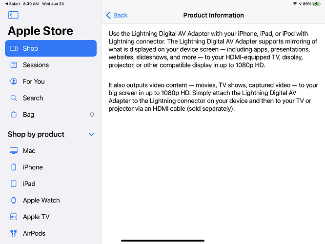

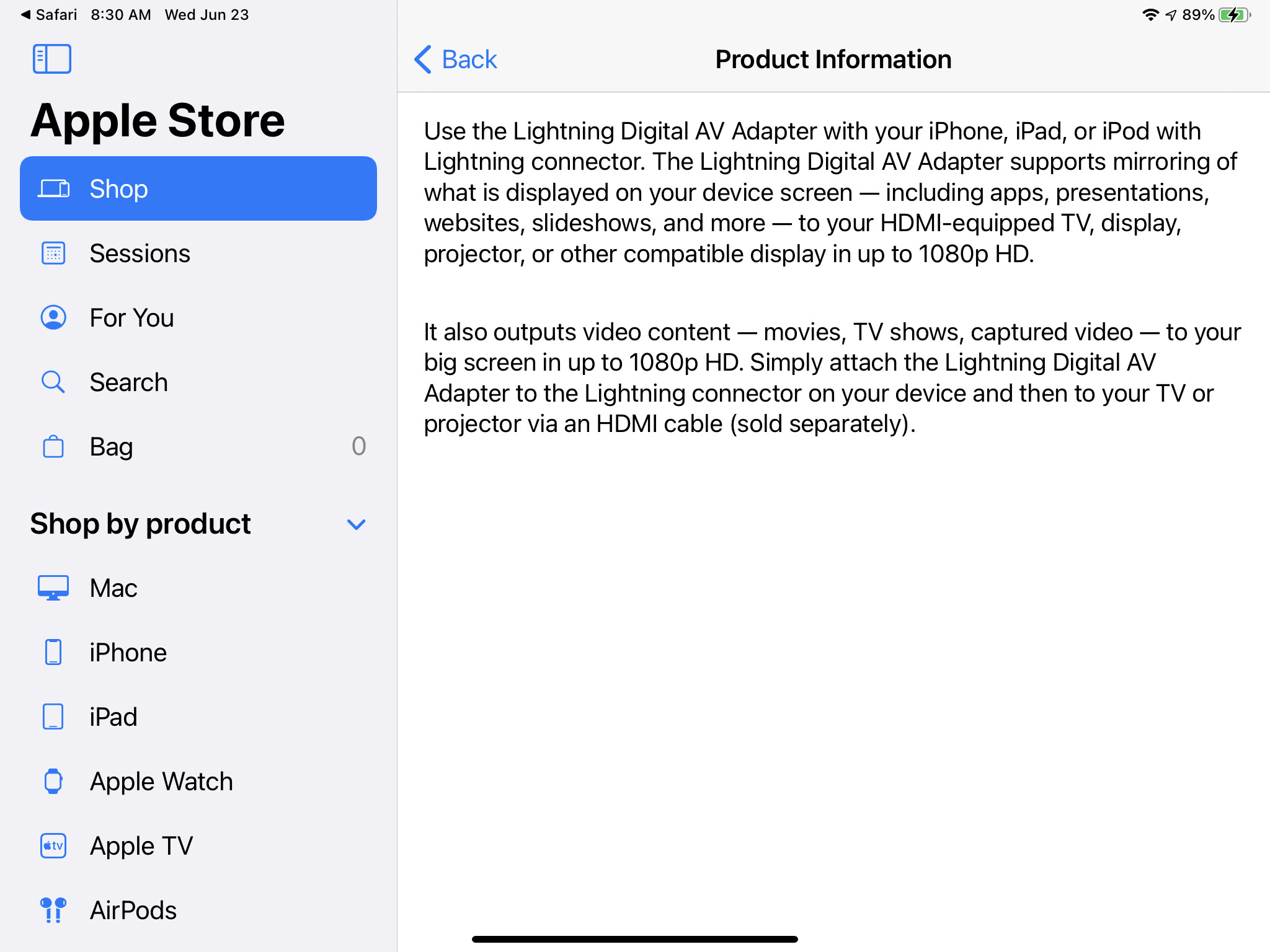

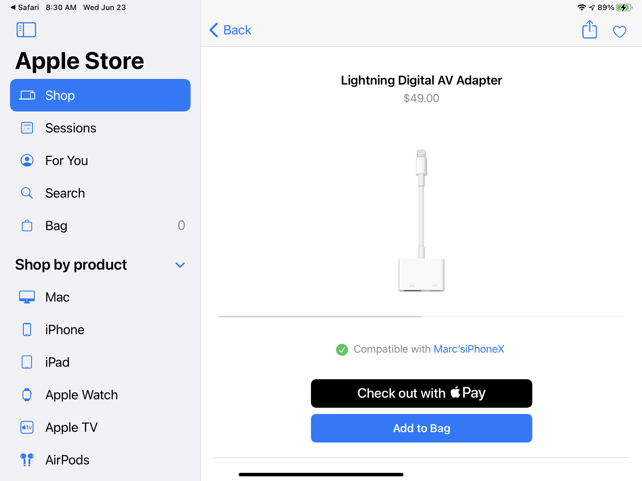

This is what I currently own for my iPhone (my iPad has a different plug/ the USB-C.) Will it be what i need for Apple Music to the Nova?

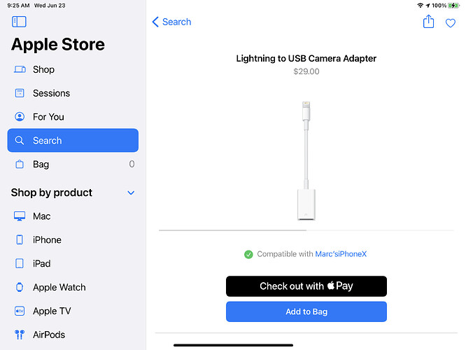

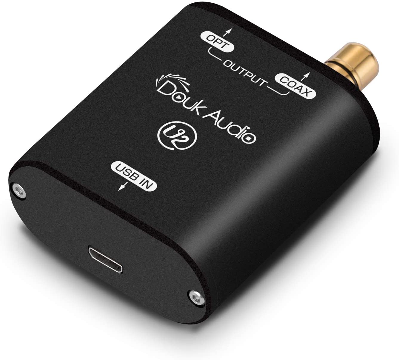

To connect your iPhone you need an Apple Lightning to USB Camera Adapter. To connect your iPad use an Apple USB-C to USB Adapter. You then need a USB to Coax/Opt converter such as the Nobsound Douk Audio U2 USB Converter:
So this would be plugged into the iPhone…
So with this camera adapter I’d need a usb to usb to connect to the Douk, and then an optical cable to connect the Douk to the Nova?
The Douk should come with the appropriate USB cable. That would plug into the camera adapter. Then an optical cable is needed for the Nova.
One thing that hasn’t been mentioned I think, is that the optical input on the Nova and Atom only go up to 24/96. To go higher, you need to use the coax inputs.
There is another version of this, slightly more expensive, that has an additional lightning socket which allows you to charge the phone while it’s connected. You might want to consider that as if you use it for any length of time you might drain the battery in your phone.
There have also been suggestions made elsewhere that you get slightly better sound quality through the other one, but I can’t substantiate that.

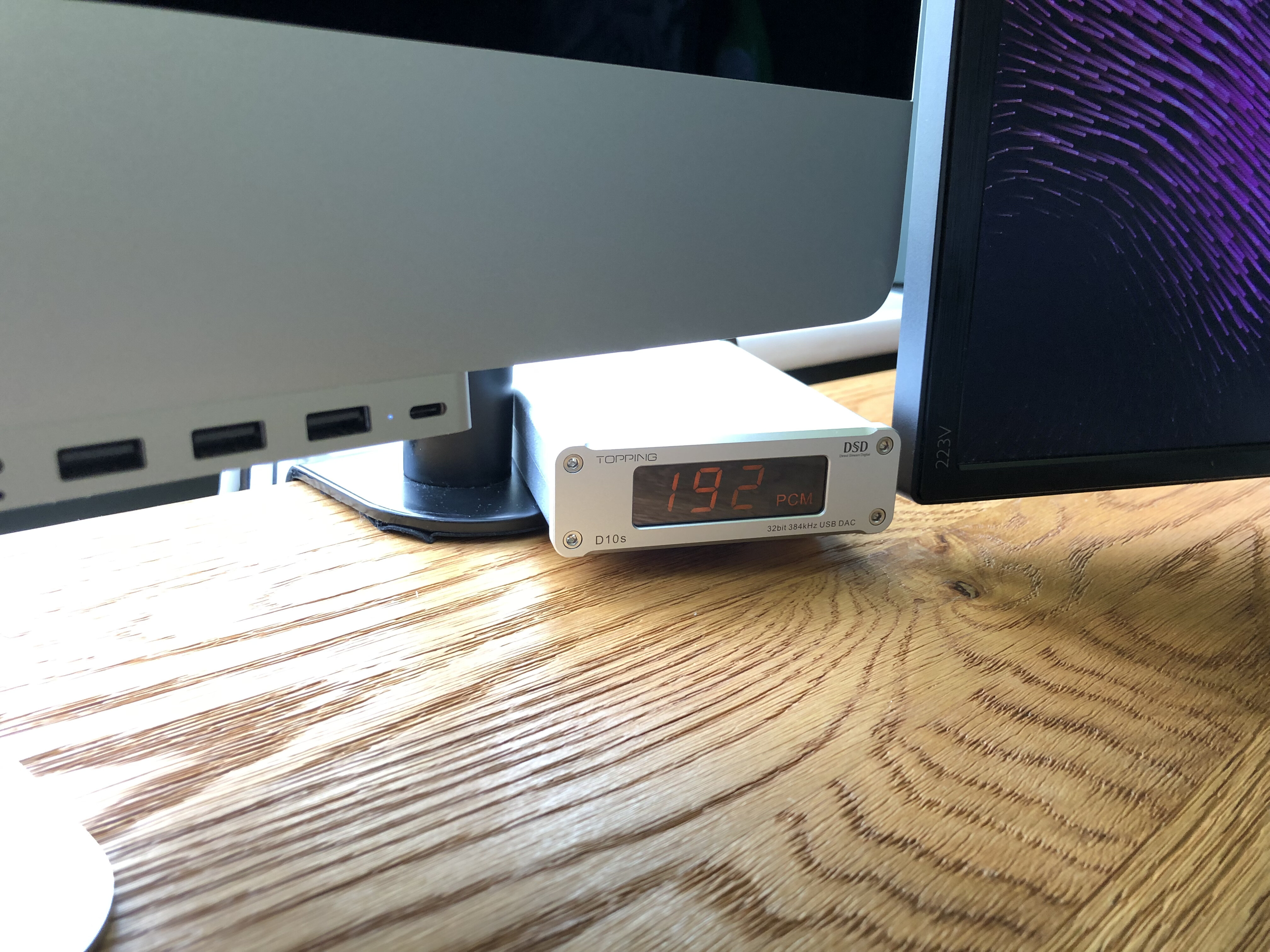

Just got this all set up:
I’m using coax and it’s claiming 192 rate
Yes, I have it set up like that. I think, that until Apple and/or Naim are able to update or integrate something, that is the simplest way of doing it. At least for a desktop audio set-up. It’s just a shame that MacOS doesn’t currently provide automatic rate switching.
It a really lovely little unit tbh. I am not sure what I was expecting for the price but it looks and feels really well put together.
For everything no doubt. It will be upsampling none 192/24 to that. To have bit perfect you need to change the Macs settings for all the different source material sample rates as it doesn’t automatically do it. If you use iOS it will.
