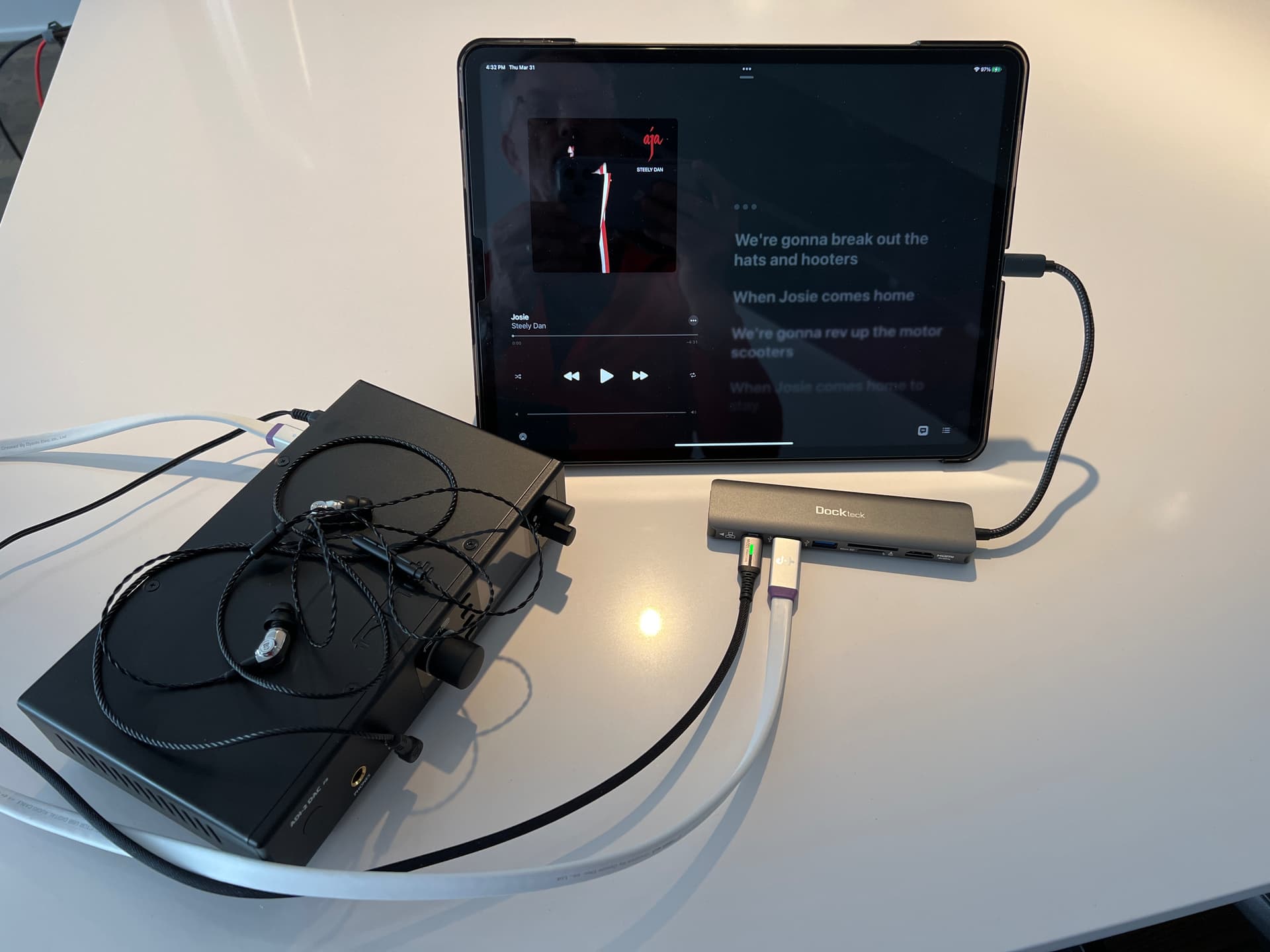

I’ve just ordered a USB C hub / multiport adapter for a similar purpose. I have a 12.9” iPad Pro 5th Gen.
The feature you need is called PD for Power Delivery, available through a second USB C port (or a first such port if the hub has a fixed USB C cable to attach to your computer or iPad). It’s not so common, and when I was reading reviews, many people were upset that they did not get this specific functionality for charging their laptop or iPad (as well as the hub itself and potentially the attached USB A peripherals). There are not all that many such hubs with USB C at the moment, but they are out there; I did not find an obvious USB C version of the Apple Camera Connector and the one with HDMI out is not necessarily fit for this purpose, so I didn’t bother getting one to try.
The one I’ve ordered (from Amazon; arrives tonight, all going well) is by Dockteck and is described as follows (and I hope searching on these terms helps you find it):
USB C Hub Multiport Adapter, Dockteck 7-in-1 USB-C Hub with 4K 60Hz, 1Gbps Ethernet, 100W Power Delivery, SD/TF Card Slots, USB 3.0 5Gbps Data Ports, for MacBook Pro, MacBook Air, iPad Pro, XPS
I can let you know if it works as I hope after I’ve installed it. I’d like to try it both with my RME DAC (which has its own wall wart for power) as well as with a MOTU M2 digital audio interface (takes power from USB-A to USB-C cable).

Works exactly as expected, very satisfying. It’s a nice quality, lovely little thing. Initial impression: recommended, no hesitation.
Excellent! Glad it worked for you. Now seeing it in context it is smaller than expected, which is a bonus.
