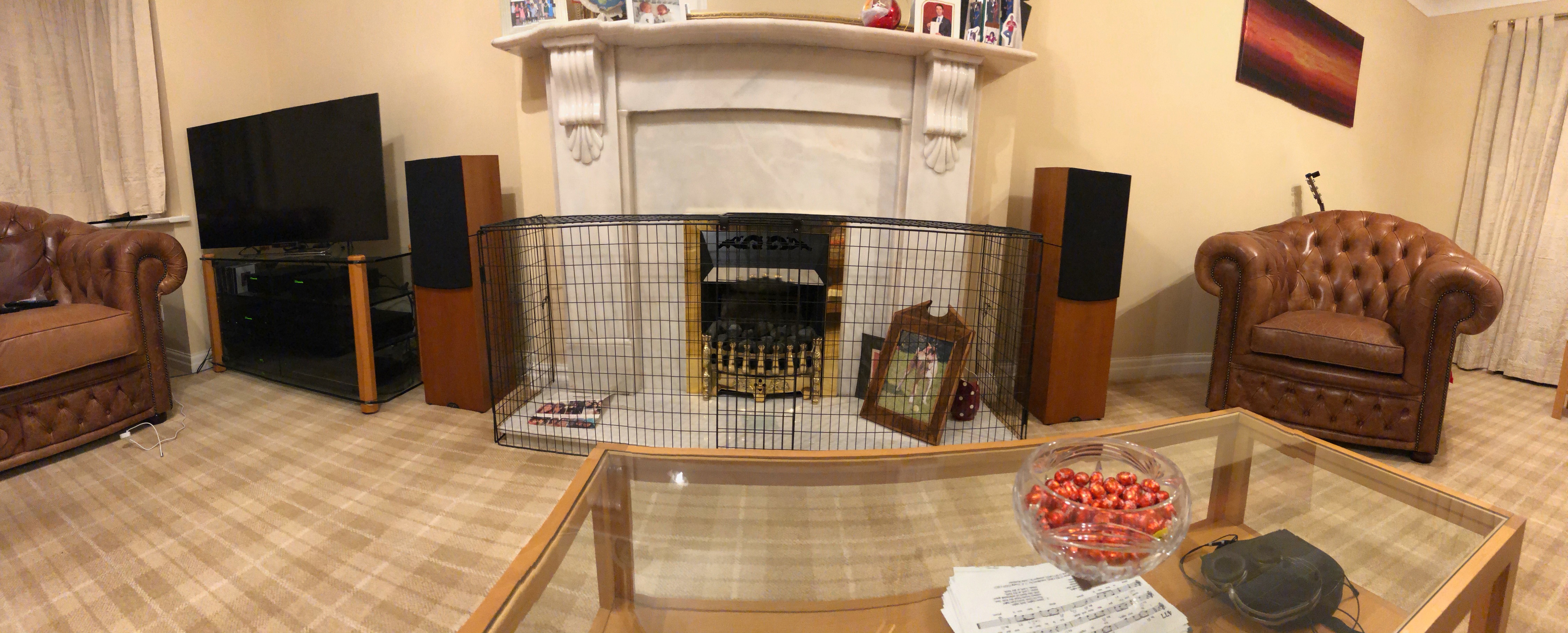

As you can see in the photo below, it’s all rather tight on the LHS so will need some forgiving speakers. I can probably bring any speaker out up to 65cm (measures from its front) but that’s probably all I can get away with. Although if they are too large, then I may be in trouble :wink:

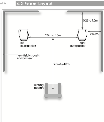

Worth having a look at the online manual imo, if you have not already done so. Naim give placement guidelines for Ovators, including the space around them.
Thanks Chris, I did do that, and it would just about fit. Listening position is 2.1m, so just fits in. Fireplace not ideal though, or is the Rack being so close, but of course there are always sacrifices when you have a multi purpose room, that others share, who are less passionate about your hobby.

It’s hard to tell from the picture but it looks as though they may obscure the TV. There is nothing worse than speakers that look like they have been shoe horned in and just look wrong. They need space to breathe. I’ve had quite a few Naim speakers and Allaes are the only ones that didn’t work, with horrid chuffing bass from the ports between the two boxes. SBLs, SL2s and nSats all worked perfectly but then they are not ported.
