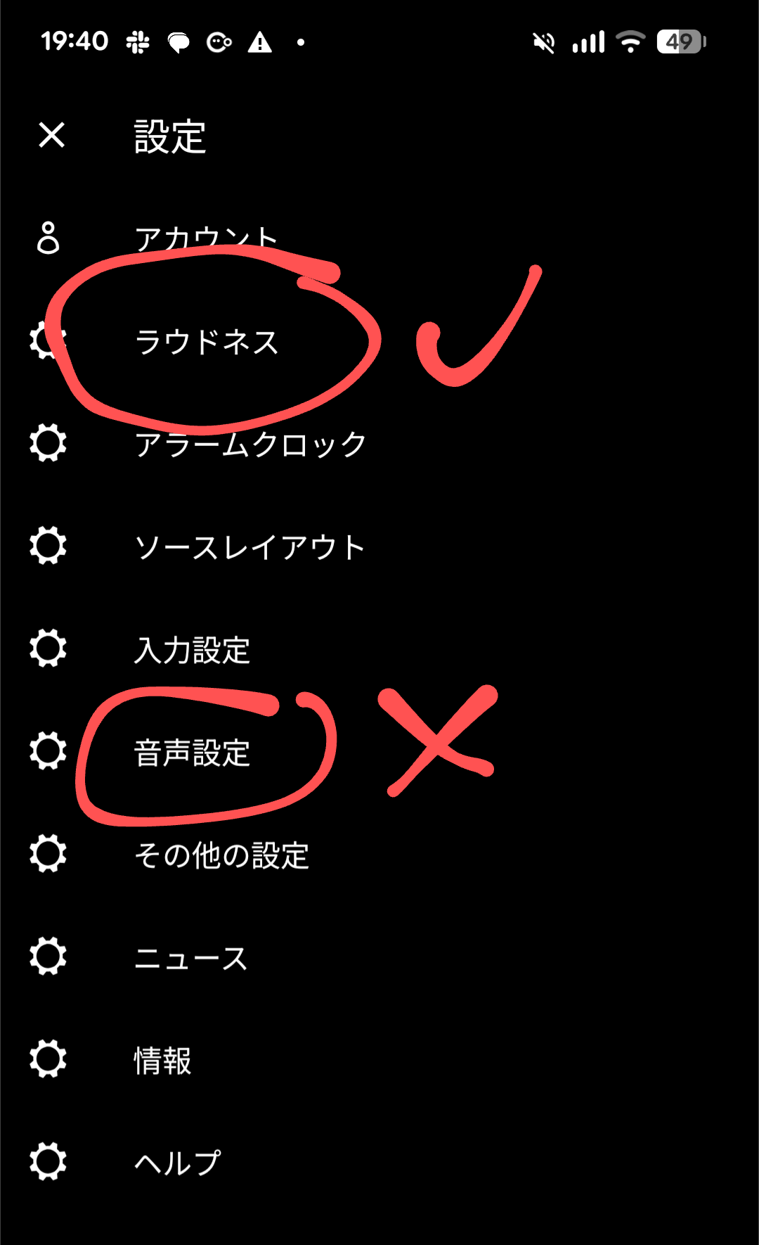

I’m honestly not sure exactly what you want to know. It’s either set to on or off from settings in the Naim app. Though the 1st gen Uniti could also set this via the green screen. But like I said, it is either “Loudness = on” or “Loudness = off” in the speaker settings. With my small speaker nearfield desktop system, it absolutely needs it set to on to sound normal.

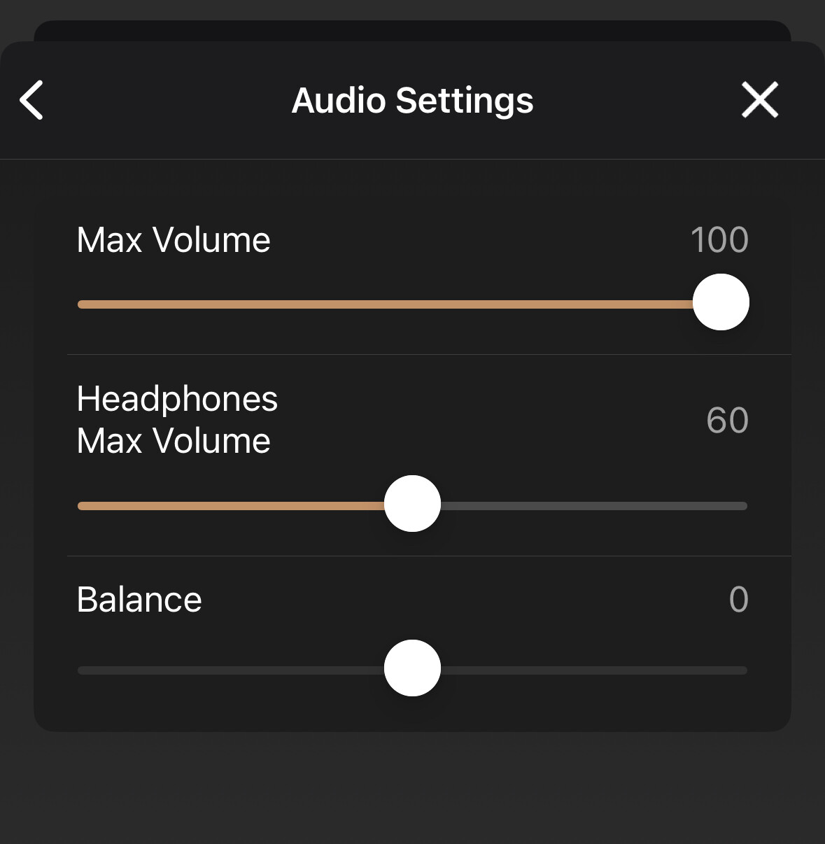

I must be missing something. Only in your older Uniti models, maybe?
You’re in the wrong place. It’s on it’s own menu. Excuse the non English interface.
You were looking in audio settings. It’s on it’s own near the top.

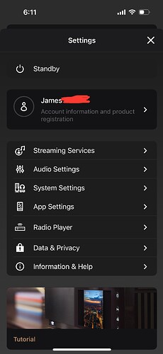

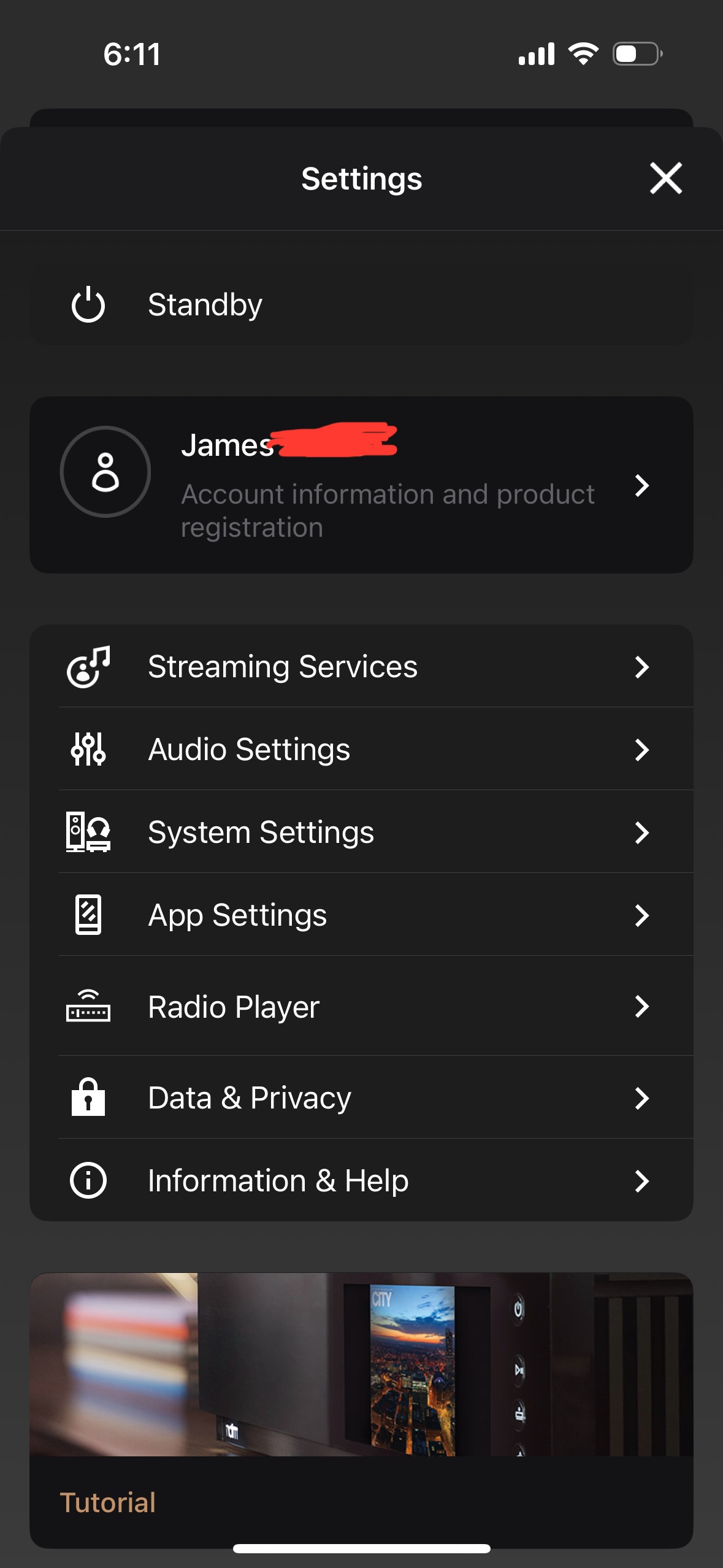

How strange, this is what I see:

:person_shrugging: With no meaningful manuals anymore, we may never know. I have this loudness option on my UQ2 (gen 1 platform) and Qb2 (gen 2 platform). I know it’s not relevant to streamers (sources) only Uniti. What box are you looking connecting to?
