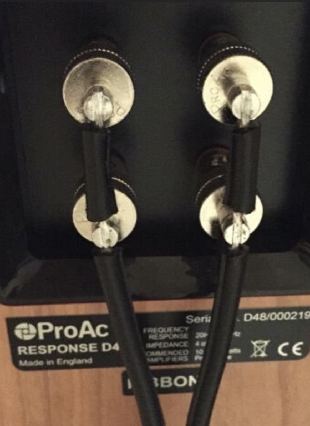

F connection is a way of terminating your main speaker cables so that additional jumpers or bars are not required. Something like this:
Naim right angled banana plugs are ideal for this.
Think of a capital letter F with the lower “horizontal” section going to the bass terminals and the upper section to the mid/treble. It uses the same cable throughout.

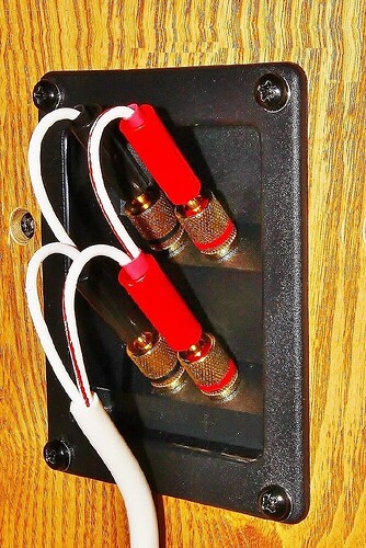

Here’s another picture courtesy of @Mike-B.

Great thanks for clarification, I totally understand it now
However I don’t want to mess with my lovely pair of NACA5 cables in any way so I think I’ll make my own NACA5 jumpers… I have a good soldering iron and somewhere I have some silver solder and suitable spades & banana’s for the job
