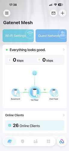

FWIW: I use Tp-Link Deco6 mesh wifi. I have three units. The base unit fucntions as the router for my LAN, and I put the internet provider’s modem/router in passthrough/bridge mode. The two remote mesh units are connected via ethernet backhaul to the base unit. This all works quite well and is very reliable.

Although I have Deco 6 Mesh with three nodes, I hardwire as much as I can to ethernet switches around the house.
The only thing I really use WiFi for is mobile devices (iPhones, Apple Watches, MacBook Air laptops), the Mu-so Qb2 mentioned earlier, and IoT devices (e.g. doorbell camera, garage door opener, refrigerator, thermostat, etc).
Desktop computer, Roon Nucleus One, the DAC on my HiFi, the Atom in my home office, TVs, AppleTVs, and even my Wahoo stationary bicycle trainer are all hardwired to ethernet. The mesh nodes are also all connected via ethernet back haul.
My internet service is AT&T Gigabit fiber to the wall.
