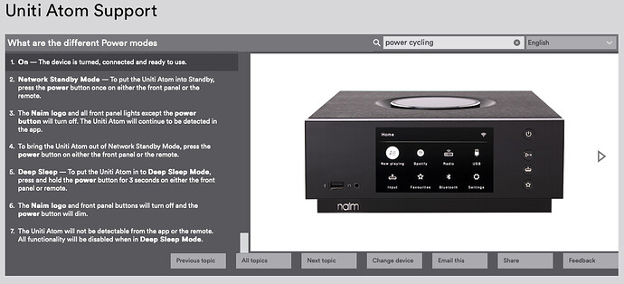

Is it being put into deep sleep mode somehow and the DHCP lease for the IP maybe getting lost?
Equally if not might be worth trying deep sleep then powering on via the power button rather than unplugging the mains lead.
