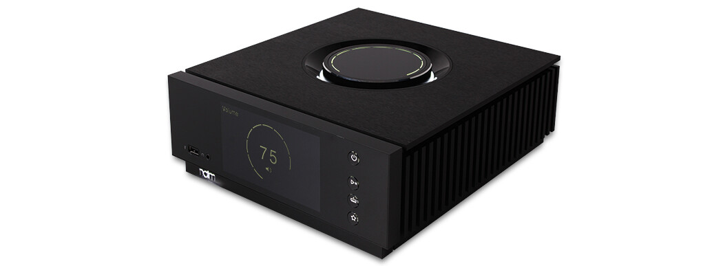

Following the latest firmware update my Atom now has terrible distortion on the right hand channel and comes up with a message “ amplifier over-current condition detected “. Nothing else has changed and I’ve never had an issue with it before. I swapped the speaker wires over to see if it’s a speaker issue (PMC twenty5 21i with Chord speaker wire) but it’s definitely a right channel problem with the atom. I’ve carried out a factory reset but it’s still the same issue.
Does this sound like a return to Naim problem?
Sounds like it. Probably best to disconnect and take to your dealer.
Bevor you should try a factory reset
  1. Firstly unplug any connected speakers and the power cable.
  2. Press the Play/ Pause and Input buttons on the front panel while powering up the Uniti Atom.
  3. Continue to hold for 5 seconds.
  4. Release the Play/ Pause and Input buttons.
  5. Wait for the Uniti Atom to complete the factory reset and go into Stand-by.
  6. Press the Power button to power up the product.
Thanks for the reply, I have tried that and still the same issue.
How old is it @Dalmatian
Return to dealer.
Martin
I bought it pre owned, it’s about 2 1/2 years old.
