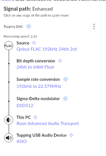

Your understanding is correct. The SACD format uses DSD64 (or single rate DSD) to store music, although not successful. The people who decry DSD will rave about SACD, kind of an argument for its widespread further adoption, although it may be niche? I convert all my digital rips and streams to DSD512, using Roon, and then play it back on a DAC that uses the infamous ESS DAC. Roon is like marmite; you love it or hate it.
What is there to gain from converting a PCM source data to DSD?
The higher definition PCM files have very little, if any difference; however, the lower rate (44.1 kHz or 48 kHz) has a noticeable uplift. A lot depends on what you are playing and through what?
