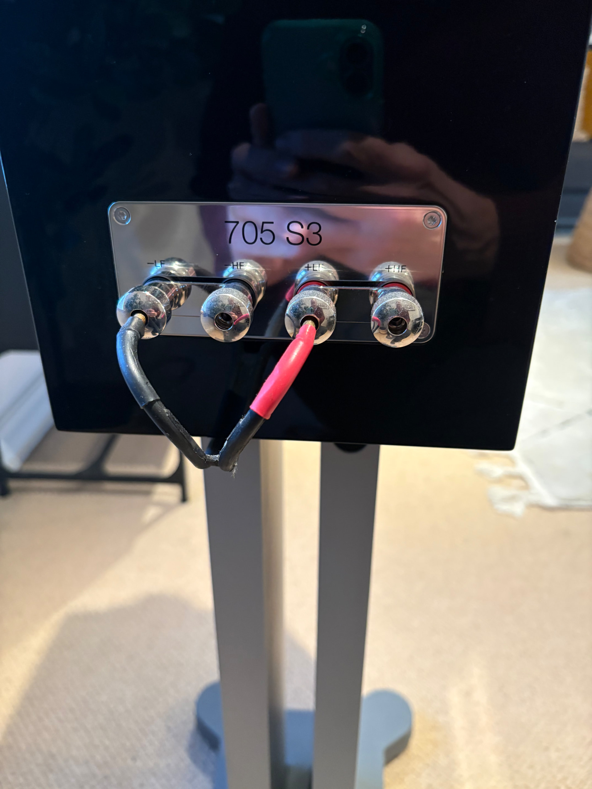

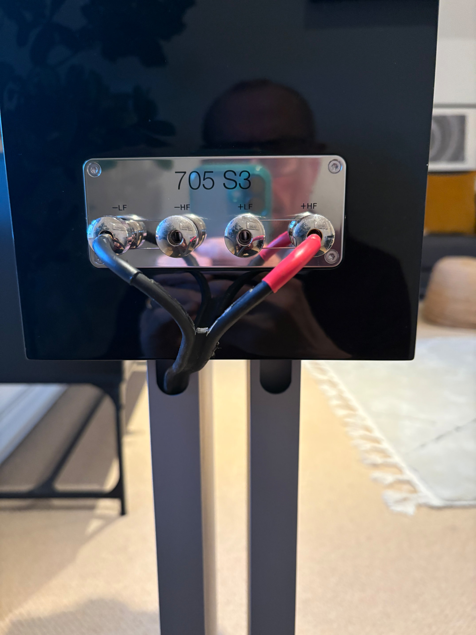

I’ll post a pic of before and after to make sure I get it right when I’m home after work.
Many thanks.
Before
After
@Skeptikal does that look right?
@MarkL3w
That’s it mate :+1:

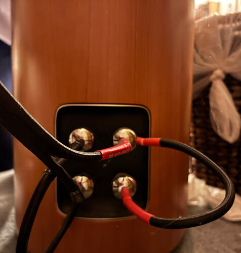

Next step is to replace the link plates with short ā€˜jumper’ cables made of NACA5. Here’s what mine look like:
