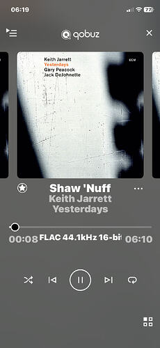

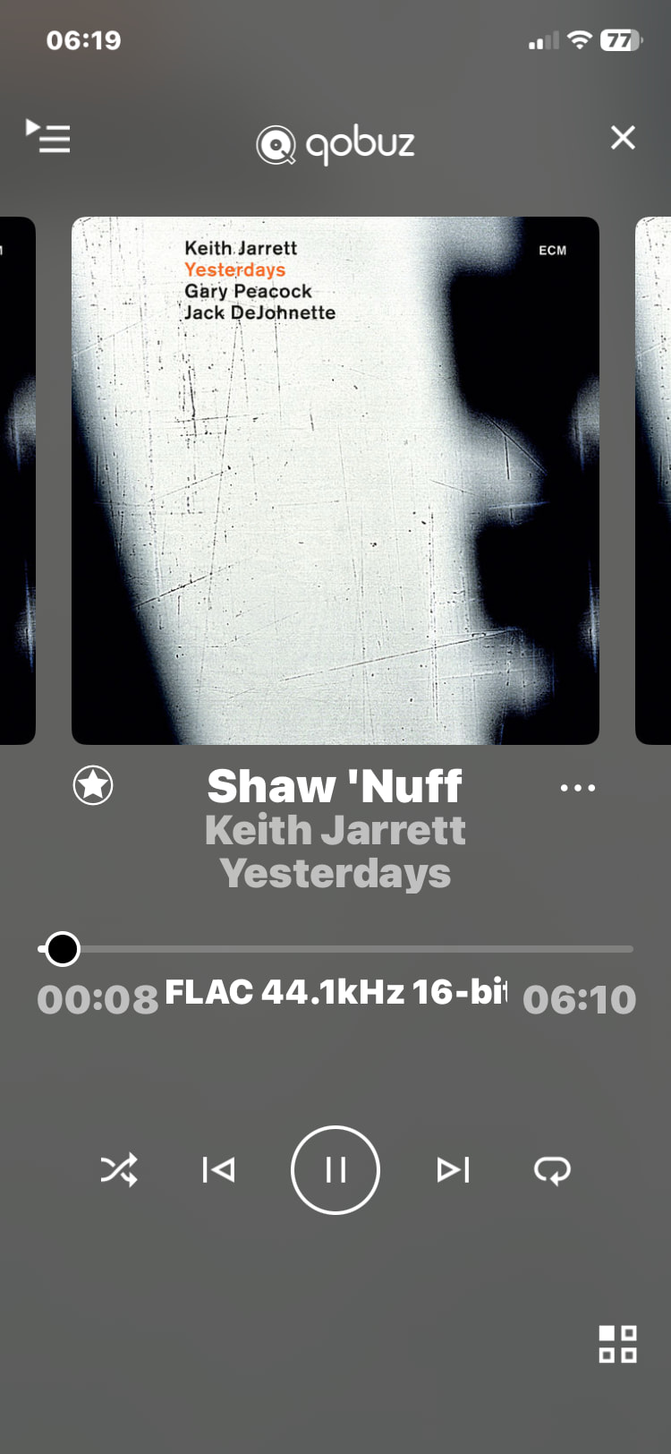

Listening to the system now in the early morning in the UK, it sounds sublime!
Clean as a whistle.
If somebody said I could always have this sound quality, never better or never worse, I would not be at all unhappy.
It’s the kind of sound I’ve always dreamed of having: enormous in scale and delicate in reproducing the sound of real instruments in real rooms.
