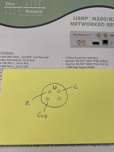

All thing being equal is the pin out on the uniti likely to be the same as a supernait, the manual has a nice diagram for supernait, not so for uniti?
Standard DIN4 output - so yes.
Yes that is what I have done, I am going in wish me luck (Lucking I have shitty pair of actives that I cannot even give away on freecycle, these will be for testing :slight_smile: )
