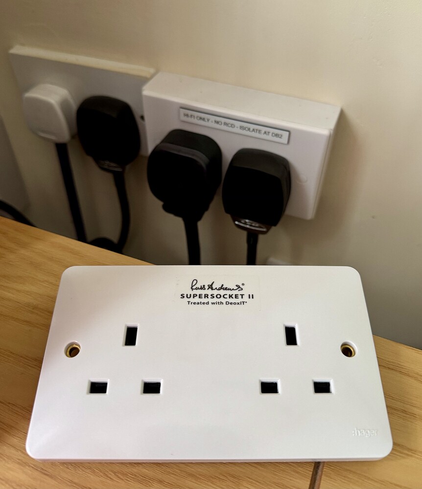

Morning Dan. I bought a RA Super socket to replace the double unswitched socket my electrician fitted when he installed my dedicated radial.Nice tight clamping pressure on the plug pins and takes the 10mm2 T&E cable without any problems. I had a voucher so it worked out around £25 or so.

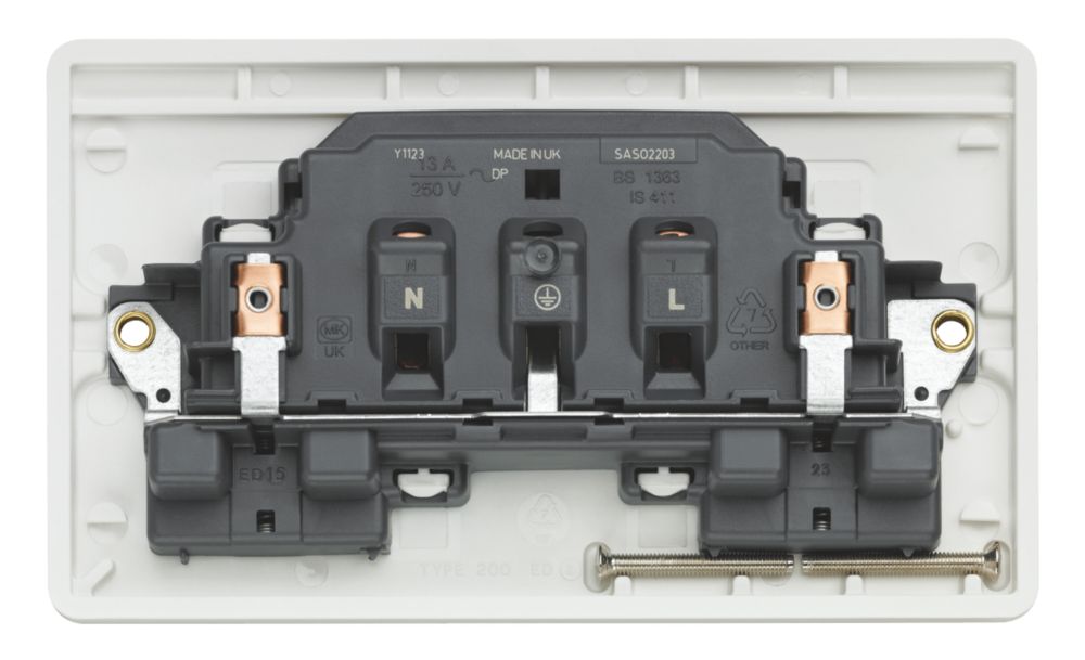

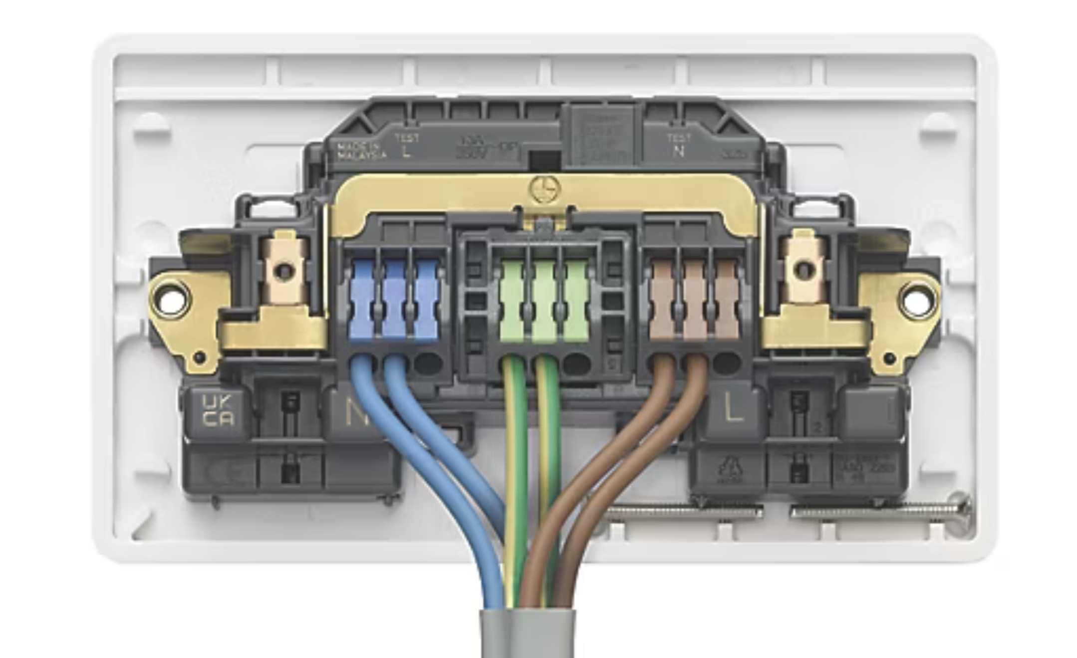

Before we dismiss MK with long time term changes the ranges do continue to offer great quality.
The problem seems to crop up is that there are many variations of double sockets the item identification is crucial to get the best sockets.
MK has had manufacturing both in Malaysia and UK since 1978 and it’s often thought the company changed completely when acquired in the Honeywell group of companies in 2005.
Just buying an MK double unswitched socket isn’t assuring you get the right one.
I’ve attached photos of two below but to get the best one for hi fi large cable termination it has to be the top one.
MKK0781 13 Amp 2 Gang Double Unswitched Socket - White
