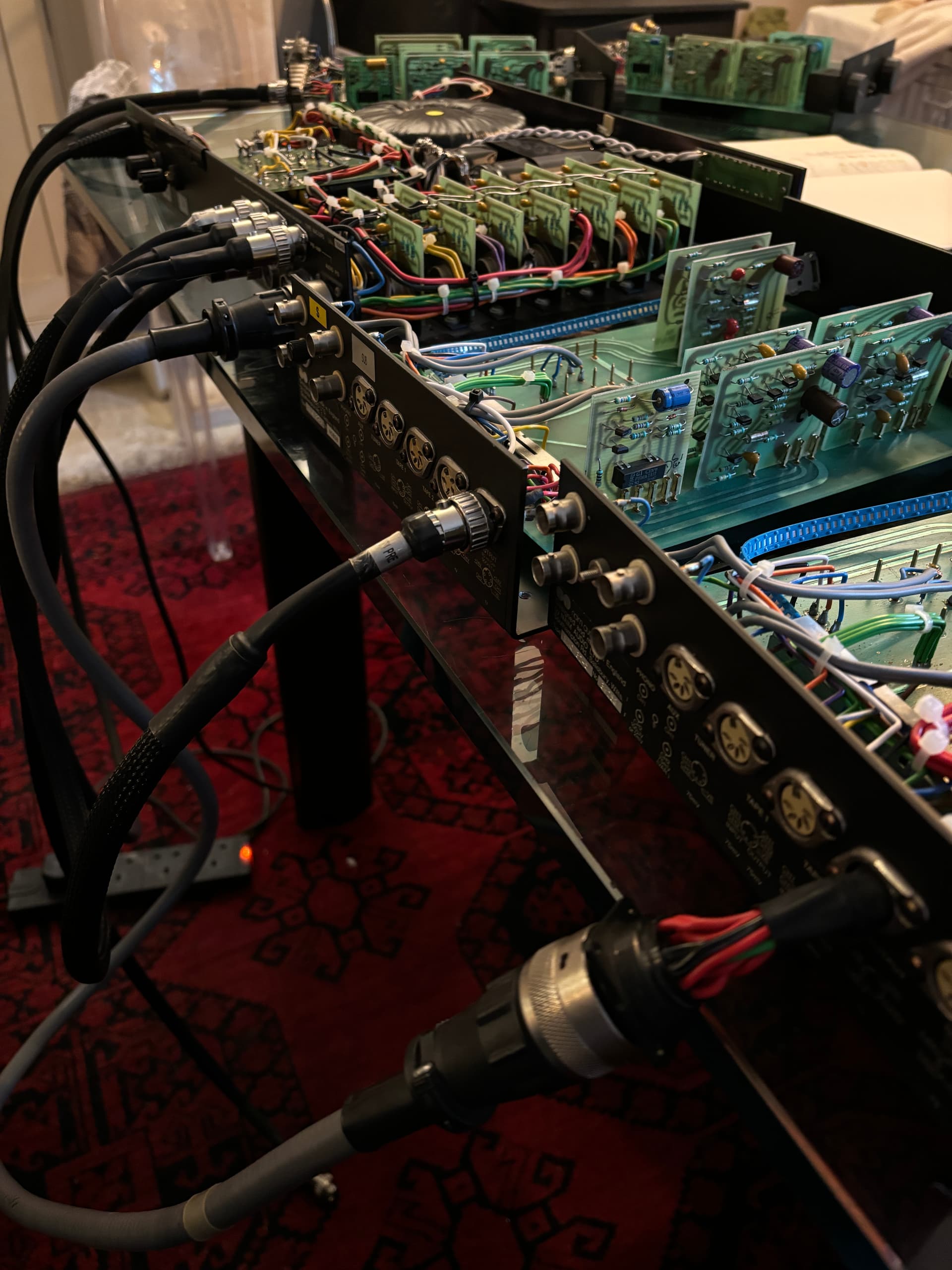

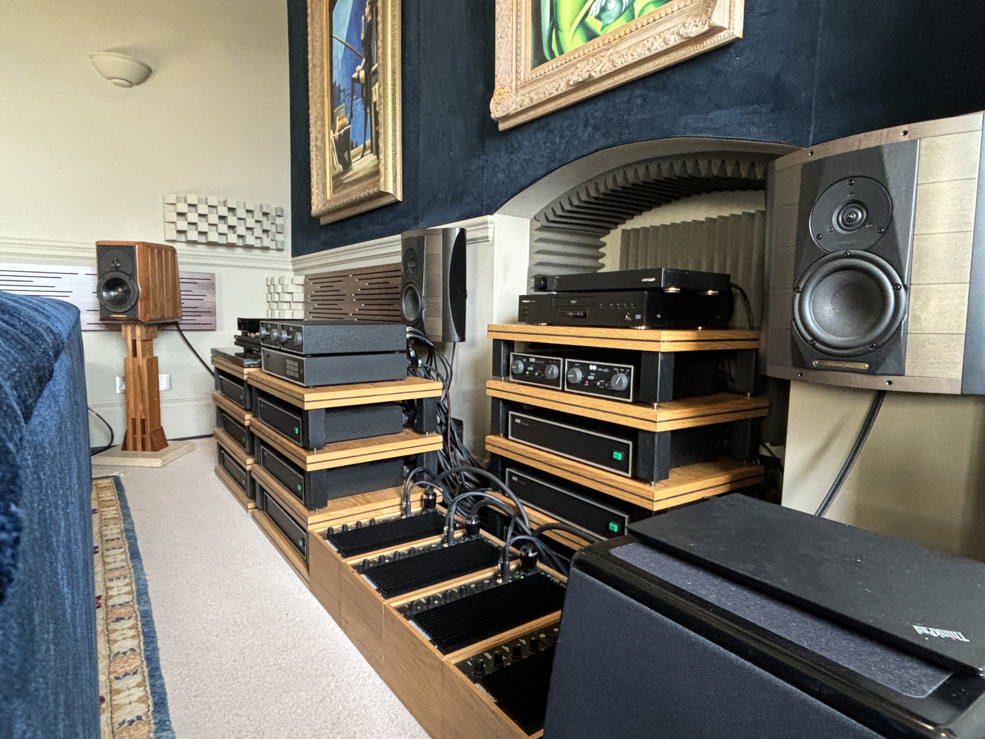

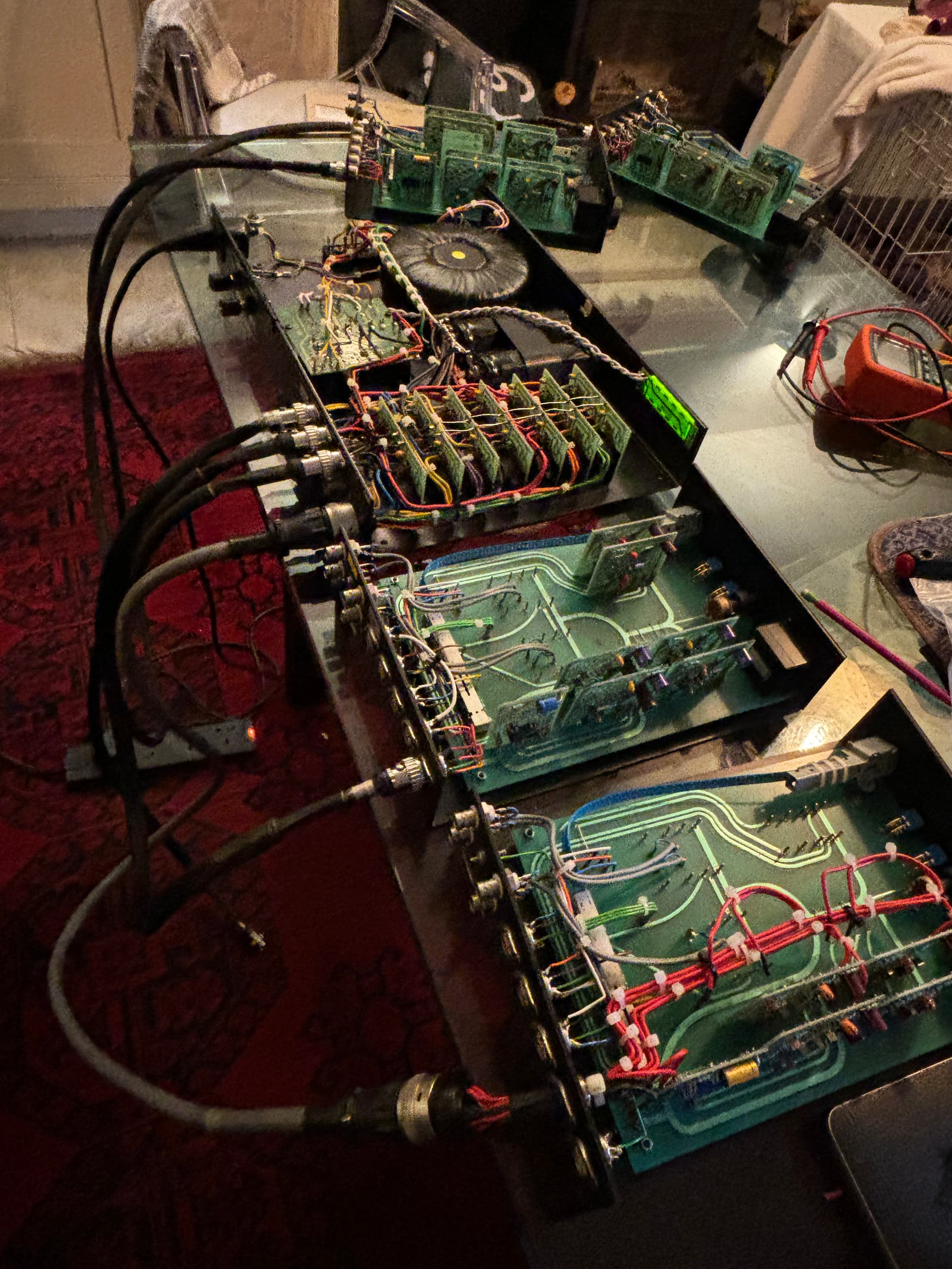

I run analogue out from the 9000 Blu-Ray for audio (Quite heavily modded) and HDMI for picture (Lumagen then projector) A supercap has been used to feed power to the 4 32.5’s I trim volume in the player so each wheel is matched and then have 4 volumes for 8 channels. Bass is more complex as I run 5 subs and only EQ and align those subs, no EQ on the 7 bed later channels
So for each channel they run from player to 32.5 to power amps (in my case 135’s) then speakers
The supercap is wired like 4 HiCaps
