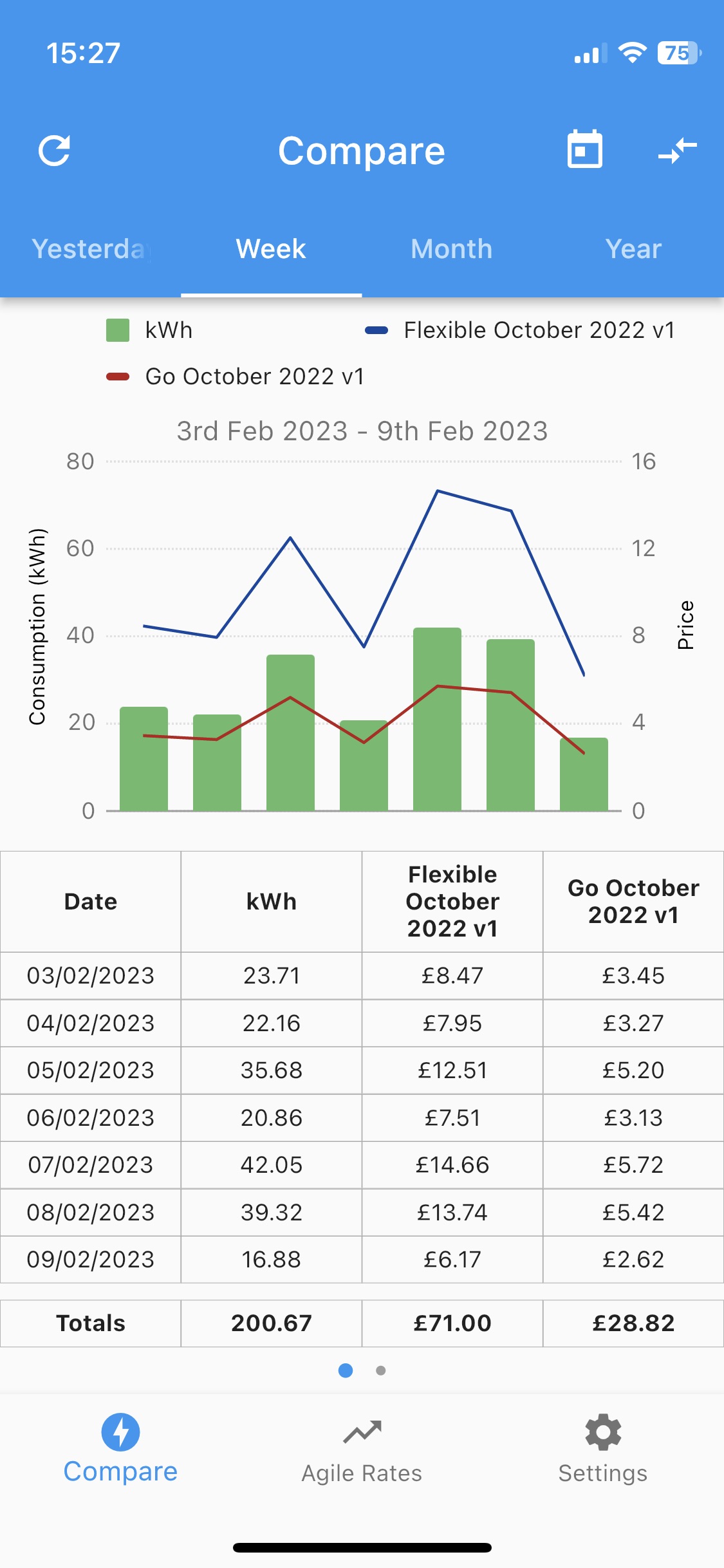

Personally, I had an Air Source Heat Pump installed last May. I also had all the radiators upsized. They reach 36c and do the job. In colder weather I might need to increase the water temperature. I now have Solar + batteries (20kWhs) and with some overnight charging on GO the bills including EV charging are modest.
The recent cold weather has been accompanied by lots of sunshine. The solar (6300p) peaked at 27kWh. I have heated the 300m2 house using 30kWh almost entirely on solar.
Alas the capital costs are a bit higher than a replacement boiler.
Phil
