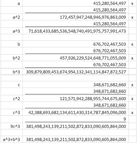

I have a free add-in to Excel, called XNumbers. It gives extended precision way beyond Excel’s 15 digit limit. It proves the answer is valid:
Clearly, doing this arithmetic by pen and paper would be rather tortuous!

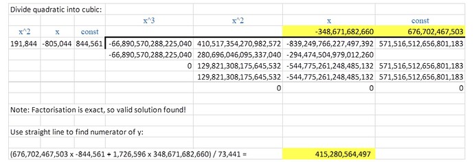

Dudeney’s Final Step
I finally got the method to work. Outline approach for the final phase of going from point R to the solution S (actually I flipped x and y):
Find the equation of the straight line of the tangent at R (needs differentiation etc).
Substitute this into x^3 + y^3 = 9 to give a new cubic (eliminates y).
Create a quadratic from the x values of the two known roots, both at R.
Divide the quadratic into the cubic to give the missing root (thanks to Mrs R for giving me a free 5 minute tutorial on polynomial long division).
Find the corresponding y value from the straight line equation.
Here’s my solution for the last two steps:
Whilst it is still rather complicated, at no time does Dudeney need to work with 36 digit figures. There are two divisions of 18 digit by 6 digit figures. Remember of course that this is to both generate and validate the unknown solution whereas previously we have just been validating a known solution.
Wonderful.
Well done Ravvie !
(and Mrs R for her polynomial tuition)
