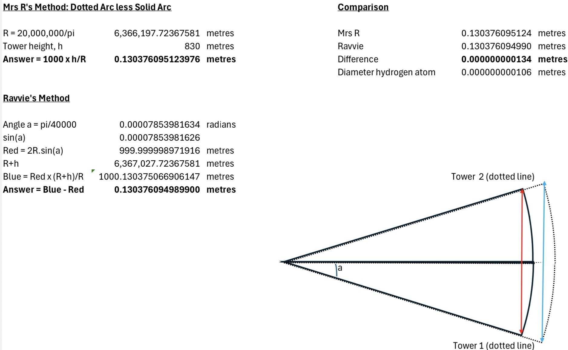

Also, for the purpose of the teaser, lets assume the Earth is a perfect sphere, circumference 40,000km and the Burj Khalifa is 830m tall, from the earth’s surface to the tip of the antenna.
Assume an identical tower is constructed one kilometre north of the Burj Khalifa. Both towers are perpendicular, ie they each project along an extended Earth radial.
Clearly, the two towers are not parallel to each other. How much further apart are the tips of the antennae than the centres of the two tower bases.

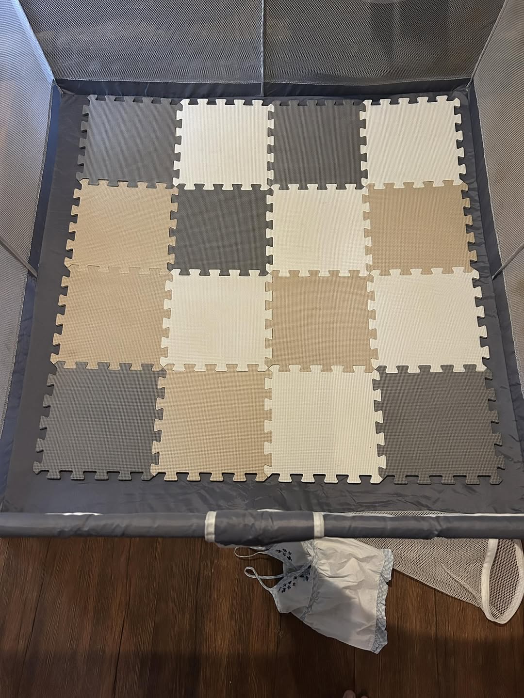

Hi everyone. I have these fabric tiles and need a way to arrange them so it looks more aesthetically pleasing. Can you help me ?
Thankyou.
How many do you have? Is it just the 16 small squares or is that just a sample of a much larger area?

Yes just the 16. Thankyou
You have 6 light, 5 medium and 5 dark squares.
Mrs R suggests using a diagonal pattern. She (a mathematician) used numbers of course. Something like:

Mrs R gave an answer of just over 13cm.
My answer is very very slightly less.

Anyway, the best ‘exact’ answer that I can produce at the moment is 83 x Pi/2.
This approximates to 130mm (just over) depending on how accurately you specify Pi.

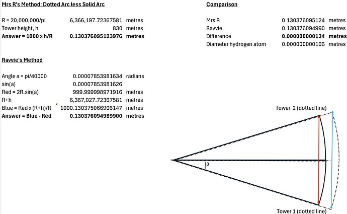

The teaser specified perfect assumptions, so I took this literally.
Mrs R’s solution was the same as yours. It measures the difference between the 1km on the Earth’s curved surface and that of a corresponding curve at an altitude of 830m. I suppose it is “as the crow flies” though.
My method measures the straight line distances between the two buildings at the top and bottom, say if measured by a laser.
When I worked out the answer it was almost a case of splitting the atom rather than splitting hairs. My answer is less than yours by slightly more than the diameter of a hydrogen atom!
