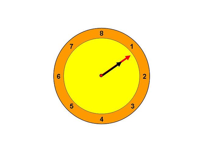

The picture above illustrates the time that we are seeking

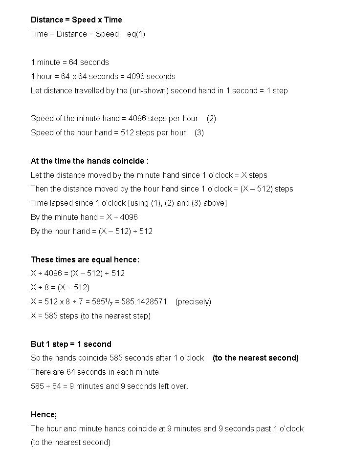

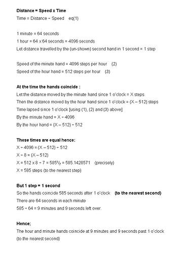

The arithmetic below shows one way of deriving a solution.
Looks like you might have to click on the bottom of the arithmetic section to enlarge it to make it readable - depending on age/eyesight !!!

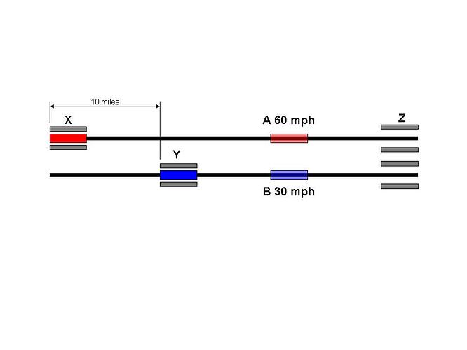

These “clock” teasers are no more complicated than “overtaking train” type questions involving relative speeds – using Newton’s ideas and ignoring Einstein’s refinements !!
So, in the diagram below, two trains A and B leave their respective stations X and Y at precisely the same time, travelling towards Z.
Stations X and Y are 10 miles apart. A travels at 60 mph and B travels at 30 mph
How many miles beyond station Y will train A overtake train B ?
Let the required distance = d miles
Distance travelled by A = d + 10
Distance travelled by B = d
Time taken by A to travel = (d + 10) ÷ 60
Time taken by B to travel = d ÷ 30
But these times are the same
Hence: (d + 10) ÷ 60 = d ÷ 30
d + 10 = 2d
d = 10 miles
Train A overtakes Train B 10 miles beyond station Y
