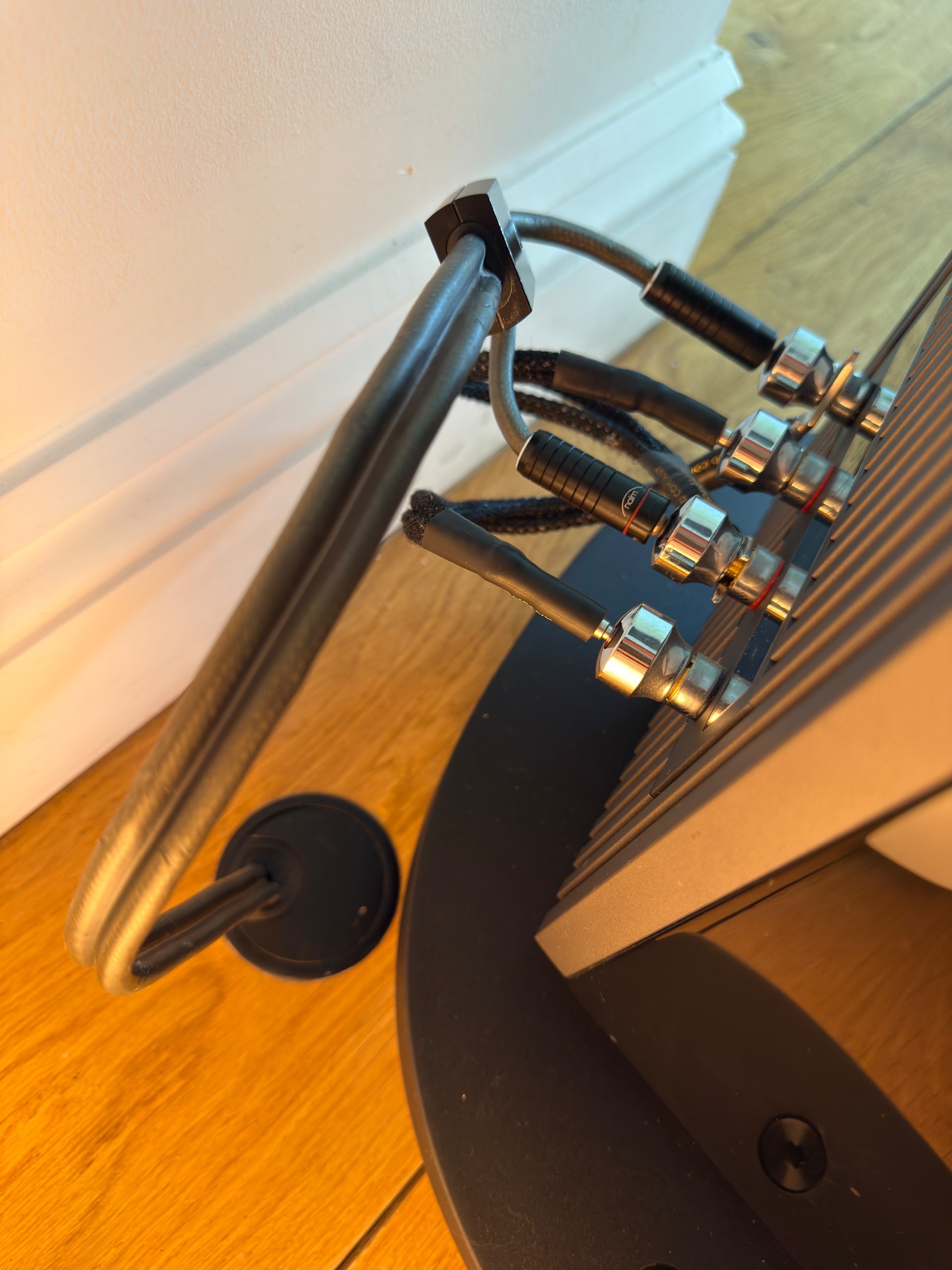

Hi guys - I’ve just moved house - and during the move, one of the speakers got twisted with the SuperLumina speaker cable still plugged in, and the metal pin (the actual “banana”?) broke off one of the cables.
Disaster - as id just had a guy in lifting the oak floor and installing them underneath.
So one of the cables is broken and sealed within the floor!
So - options to repair probably don’t include sending it back to Naim - will need to be a repair in situ I think.
Has anybody repaired or replaced one of these plugs before?
I’m pretty handy with a soldering iron, and I’d hope that in the circumstances Naim might let me have a replacement plug - rather than insist it goes back to them - or I could “just” solder the broken pin back on with some high quality silver solder but it’s a daunting prospect nonetheless.

It’s completely snapped off at the base of the pin - the pin was inside the speaker terminal socket :person_facepalming:

Hopefully there will be a pragmatic solution. That said, can you not attach a piece of string to the cable at the amp end and then pull the cable out? Leaving the string in place would enable you to replace the cable once it’s fixed? Hopefully the channel is wide enough to take the plugs and metal box, otherwise it’s slightly foolish.

The resistor is inside the little black box, so plugs can be changed with no impact on the resistor.
Yes - it’s been designed to allow the cables and boxes to be pulled back through - so it’s not impossible - just not ideal!
And I agree - I think the plug is just the plug, albeit a jazzy Naim one, but with nothing active going on - and the clever stuff (no idea what that is - but I have some transparent balanced cables that also have this) is in the black box.
Maybe not as difficult then?

The little black boxes can be unscrewed to make pulling them through tight gaps easier.
The cable consists of multiple silver plated copper strands of varying diameter, all of which are individually shielded, so I imagine it would be very easy, even for someone experienced in soldering, to get it wrong.
This may sound silly, but does the cable run under just one strip of flooring? If it does , could the installer pull up the single strip and re-install it with some sort of innocuous latch system. The cable could then easily be repaired by either naim or your dealer. Would also make any sort of change or servicing easier over the long term.
