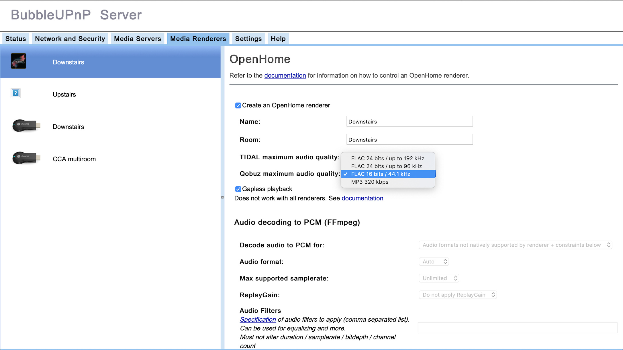

3rd time trying Qobuz vs Tidal (transcending to WAV), this time I noticed even when I select 24bit tracks, they still show as 16bit ???

Have you definitely not got 24 >16 bit conversion on in the bubble app and server? Also Qobuz is quite noted for getting the sample rate info wrong on albums and tracks. Have you tried the same the tracks via Qobuz app and ChromeCast to see?
Check your Qobuz login details on Bubble to make sure you have selected the correct subscription.
Have you got the Qobuz max audio quality set to 16/44? Depending on what device you’re running it on, you should be able to set this to 24 bit:
Many thanks all, @Guinnless got it, I forgot/thought I’d set it correctly, obviously not.
Thanks Chris will also check that, maybe a mismatch between the app and the server
