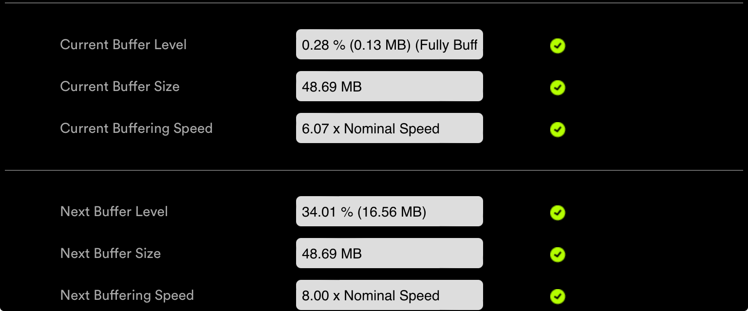

How much buffering is used seems dependent on which interface the music is played through. As far as I know, the players share the same digital board so it should apply to both.
The web interface Diagnostics page shows:
Current Buffer Level
Current Buffer Size
Current Buffering Speed
with Current Buffer Level and Size decrementing as the track is played:
After a track has played in a play queue it briefly shows Next Buffer Level, this is the same behaviour even when it is the same track repeated in the queue, so true buffer not caching.
