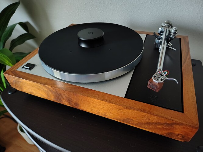

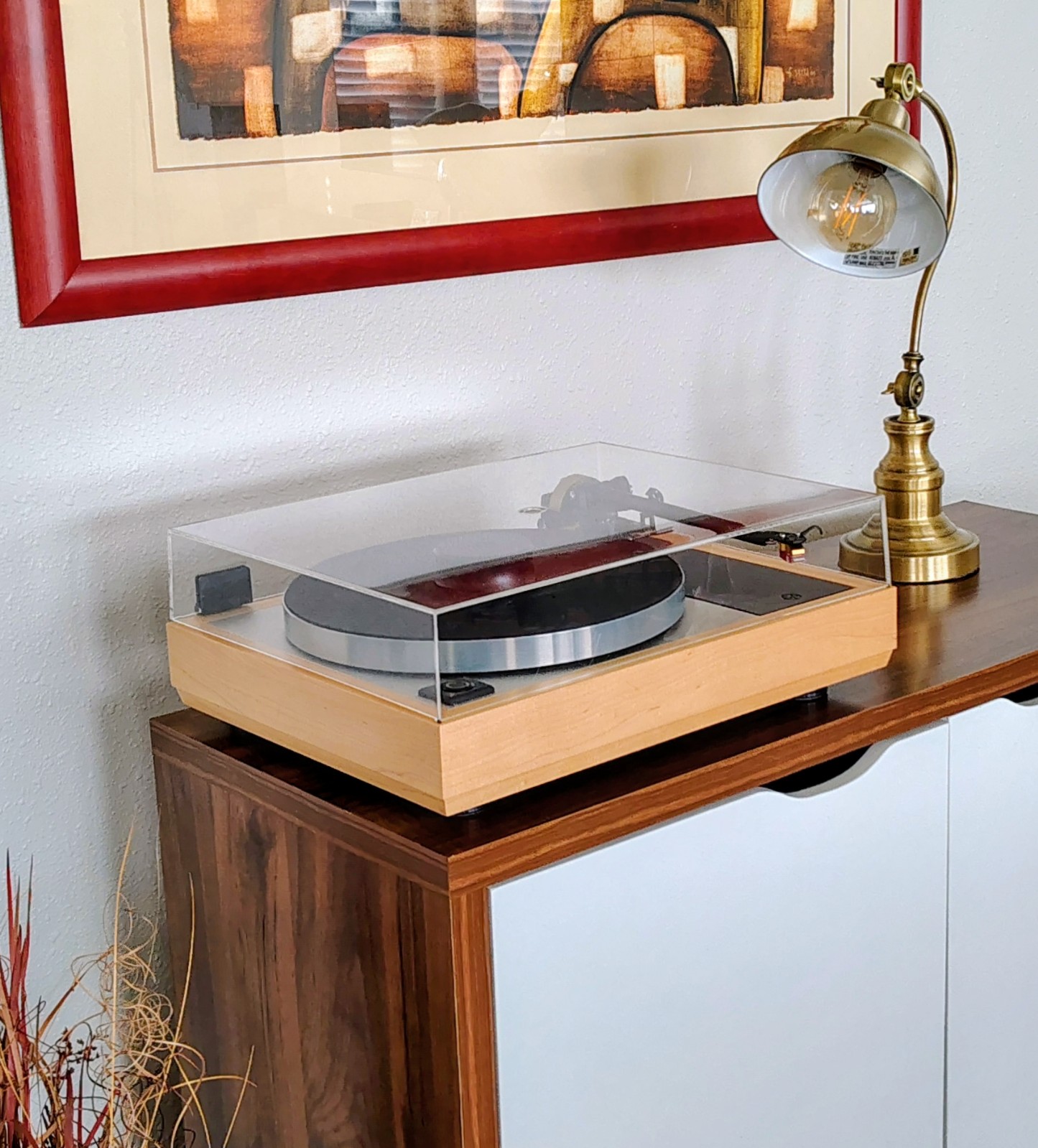

Yes, twice. Both of my LP12s started with a plinth of my liking. This is how they look nowadays:
This was done back in the days when StackAudio was still selling Serene parts, which were reasonably priced and outperformed everything out there, including Linn’s absurdly priced upgrades. But there is still Vinyl Passion and LP12 Bits, and eBay if you are patient enough. I would also strongly recommend to toss the springs in favor of the Taika Gel Bushings, which will not only make the deck easier to put together, but easier to use and sound better too.
Word of caution, do not listen to those who have never even taken the base board off. They are easy to identify as they will try to discourage you from embarking on the project in every way they can. Also, they are always bragging about how smart they are for overpaying their dealers for such work. In reality that’s about 9 out of 10 people here, so maybe you are asking the question in the wrong cyber space.
