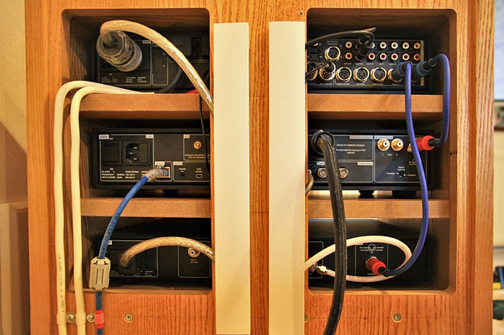

Naim have the signals on one side & power on the other with most all the full case range, so this makes cable routing a more structured affair.
In my case I have my own signal cables made to the correct length so there is no slack (yes I know DIY cables is not something for all users for various reasons).
Power cables are run in a conduit thats attached to the rack as are some others such as FM coax. The Burndy hangs free. Speaker cables & ethernet are clipped to the rack.

The SNAIC cables carry the signal after the pre-amp, the power is 24vDC & relatively clean. But I consider them to be signal, My SNAIC cables in my photo are inside the right side conduit together with FM coax & a record out.
Yes, PSU’s for SN & NDX & power distribution board with DC Offset filter.
SNAIC’s & Burndy go straight out to the rear of cabinet, the power cables are just made to run tidy as best as is possble.t
