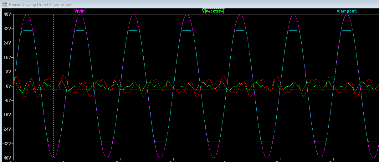

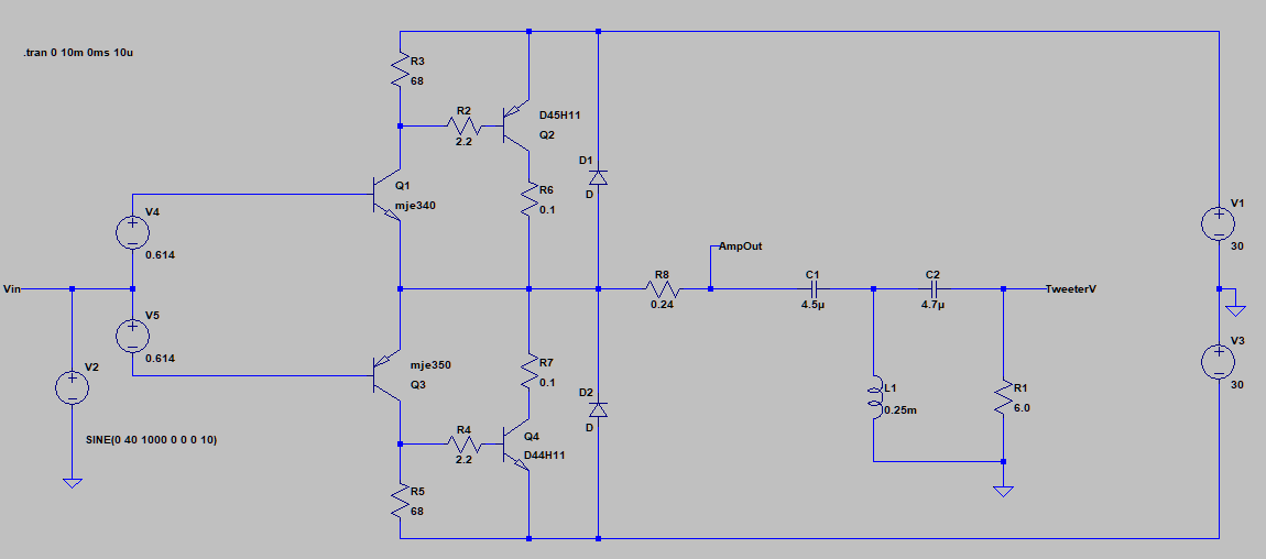

“It’s complex” looks to be a pretty accurate description. It took me more than just overnight to knock up a working simulation for what goes on. I thought a nice little single-ended CFP stage would be ideal to test it on, but that misbehaved on the negative swing as it ran out of current, and I couldn’t get it to clip cleanly anyway. I ended up with a full push-pull stage which is almost symmetrical but even that needed output diodes to clip where one would expect it to.
What seems to get through are the harmonics produced by the clipping, which I should have realised at the outset. The amount of harmonics produced depends on how hard you are clipping and in this simulation it’s going pretty hard; 40V sine into 30V rails on a 1kHz signal into a very standard 3rd Order crossover at a little above 3k. We still don’t get much more than a couple of volts swing each way coming through. The red trace is the voltage at the node before the second capacitor and is kind of indicative of what one might have with a 2nd Order x-o. That peaks at around ±6V which is about as much as I’ve ever seen going through a tweeter and might be said to be pushing it pretty hard.
This is an area that seems to be ripe for a good deal of proper research work but the takeaway from this tiny bit of simulation seems to be, slightly contradicting my initial assertions, that there is scope to do damage to tweeters if your voltage response is below 3rd Order and your x-o frequency is too low. Both of these aspects have been encouraged by the path of loudspeaker development in general - first with the “acoustic” Butterworth (now usually LR4) and later with the directivity matching - so it probably should not be a surprise to find some designs hitting the stops of what a tweeter can manage. It’s certainly a good argument to use a 1" tweeter rather than a 19mm and a waveguide will help not just with the directivity but with the power handling problem too.
Have a look for yourselves. Though there are a lot of qualifiers, and this is approximately a worst case scenario, more gets through than I initially imagined. What I don’t believe happens is that an amplifier clips at a frequency inside the tweeter passband because that’s not how the spectrum is distributed in recorded music. It’s actually fairly hard to believe it might clip at 1kHz, which is what is used here.

Nor was I definitive in this post, and said that I find clipping at 1kHz hard to believe. If we drop that clipping frequency to 100Hz, the ripple getting through to the tweeter falls to millivolts - 100mV peak to be precise. It’s still pretty hard to believe clipping is blowing tweeters in general, but I qualified the whole thing by saying that it was an area that’s ripe for some proper research and stressed that there were a lot of qualifiers.
