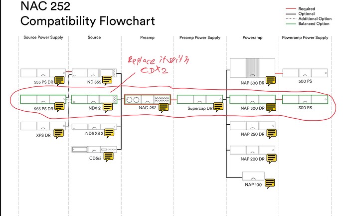

I am considering either the aforementioned 252 or an NSC222 connected to my 555DR.
Would a 222 with a 555DR be better in my 300 system? The advantage of an NSC222 is that it will simply replace my 272 with a better streamer section. But will the combination of 222 and 555 surpass the preamplifier section in the 252?

Hi Stuart. That’s what I’m aiming for, a long life with the best sound, after servicing the units… Thanks for pushing me a little further in that direction. It will be too costly to go down the NC route as suggested here. I think I will get a fully balanced system with 252/300DR. 555/CDX2 as the source.
But in the other hand I am also very happy with my streaming component, and it will be difficult to do without it. Incidentally, is it possible to connect the CDX2 to the 252 with roughly the same output if I later will make room for a NDX2/555? I am considering this combination to keep the number of black boxes down. I don’t have room for more boxes. Hope you can see the picture

Thanks Stuart, that helps a little. If you look at the overview, I want to replace the NDX with my CDX2 after 555.
In my opinion, this would create a balanced system. But if I decide later on that I would like an NDX2 after all (I think I will miss the features I have on the 272), where should I put it? I have an XPS to spare, but can I avoid using the XPS to keep the number of boxes down? Perhaps at the risk of poorer SQ, most likely. You say that I can program the 252 to receive the turntable, which is what I am doing now on my 272.
