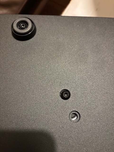

When I got home and unpacked my Supercap, I noticed a small detail under the Supercap that I hadn’t noticed at the seller’s when I was there. Maybe I was too hasty after all…see the photo
Is this something I should be concerned about? Does anyone know what it could be, and is something missing? It looks like this. I’m thinking of a transport screw… no theres no transport screw on 252, but on 552 there is as I have understand
Do you have any ideas?
Edit deleted post, as my reply was for the 252. not a SCDR. Though the same answer may apply, I know they use the same sleeve for different Pre models, so the same may apply for the SCDR & the extra hole is to accommodate this.
