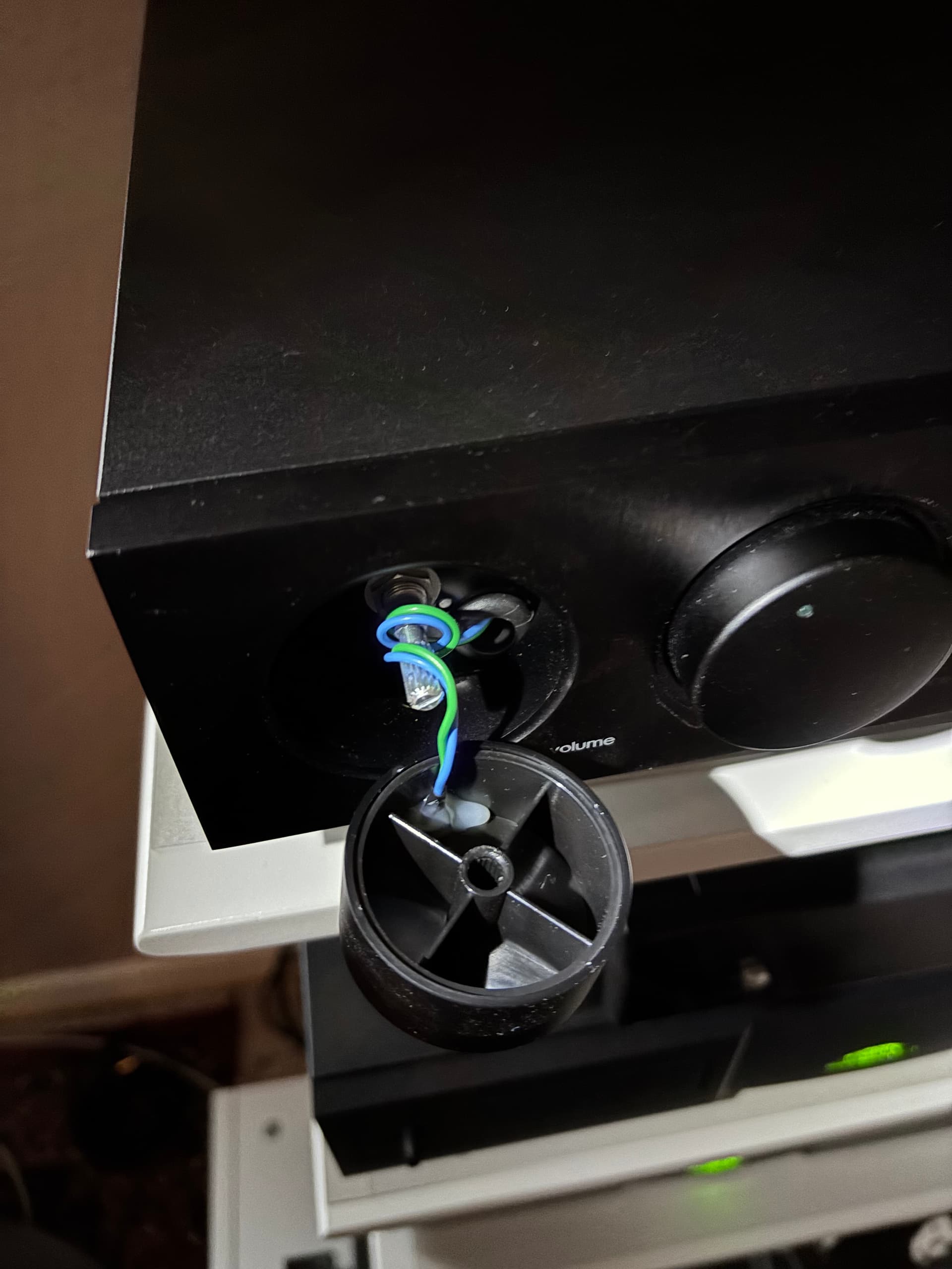

As you know, I have just purchased a 252, which is now playing and settling in. The volume knob suddenly fell off when I turned it manually. Is this something I should be concerned about? See photo. I see that there is a small slot in the middle of the metal piece on which the plastic volume knob sits. I carefully widened it a little with a screwdriver and put the volume knob back on.
I have an additional question. How much resistance should there be on the knob when I turn it, for example in comparison to a 272 volume knob? I think there is more resistance on the 252, which makes me think that it can slowly work its way off again when I occasionally turn it down in connection with lifting the pickup on my TT. Do you understand what I mean? I can turn it, but it doesn’t turn easily.
Am I overreacting again a little bit?
Kind regards, Peter

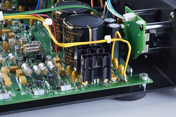

282 posted above but the 252 is basically the same, the 272 is the bottom pic.
Just falling off isn’t great. I know there is a way to make it more secure, I think by pushing something into the little slot in the spindle, to make it a bit wider. Perhaps @NeilS can advise on exactly what to do.
The control will feel different in use, as it’s a different potentiometer, so that’s not something to worry about.

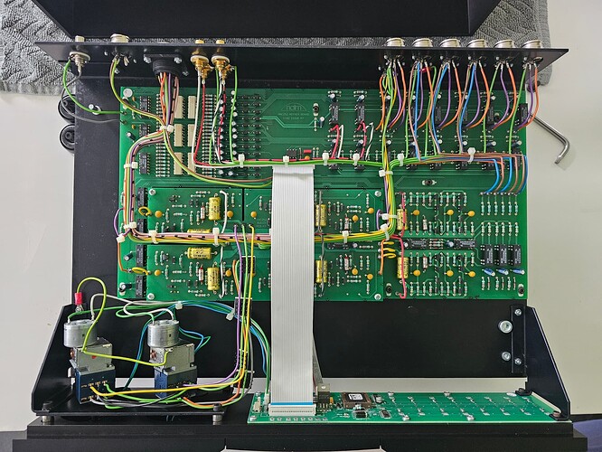

Should be my 252 if that helps?
The “ fix” is to splay out that slot before refitting the knob. It’s not a great way to fix something that you want fixed until you need to remove it.

It helps, thank you :slight_smile:

We stopped using the screwdriver down the slot method, as it’s difficult to control an even spread & the knob can end up rotating eccentrically.
See this post:
