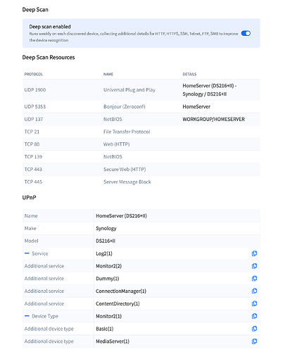

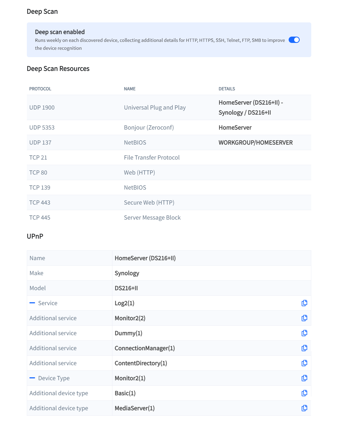

Apologies for some of the noise. Even though there has been some genuinely informative and useful replies here - yourself included. It feels as though some have jumped the gun little and are merely making fairly broad suggestions - such as checking the Media Server is running. This indicates some haven’t really read my original post. I appreciate your piecemeal approach; as we don’t know exactly what the root cause is yet - so this seems prudent as a strategy. I have followed your advice and drilled into the specifics on UPnP for the Synology, within Fing - please see below. I’m no networking expert by any means, but it looks as though the UPnP section is displaying the existence of a Media Server function?

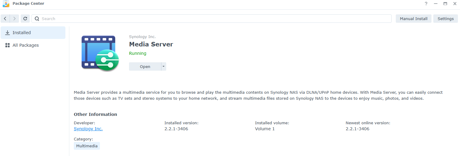

I had checked if the Media Server was running. Maybe I’m missing something readily apparent, but it looks like the service is installed, and running - please see below.

Indeed it does, and your other post indicates the uPnP server is running. Haven’t used the Synology server for ages, but clicking Open would usually get you some sort of config or browse interface?
Port 1900 UDP is correct.
