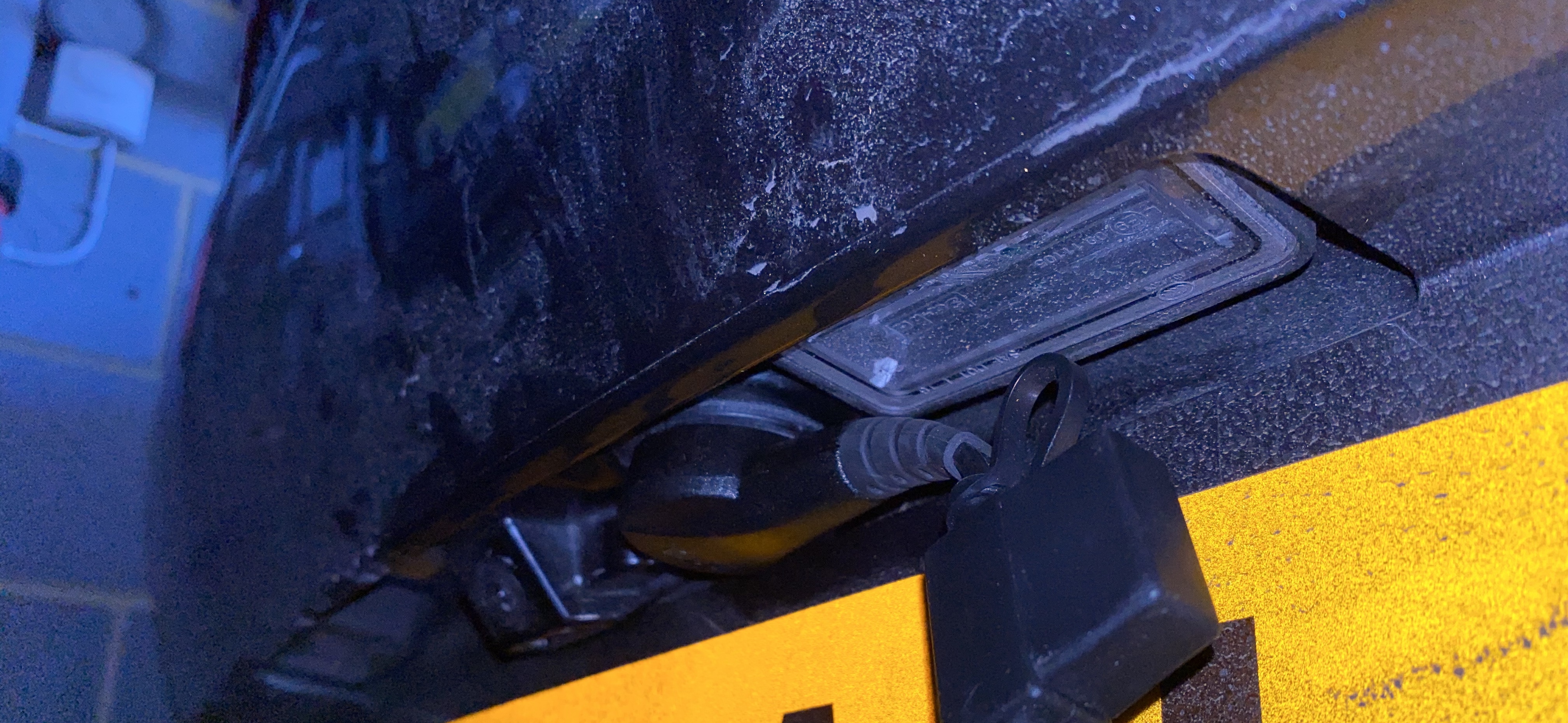

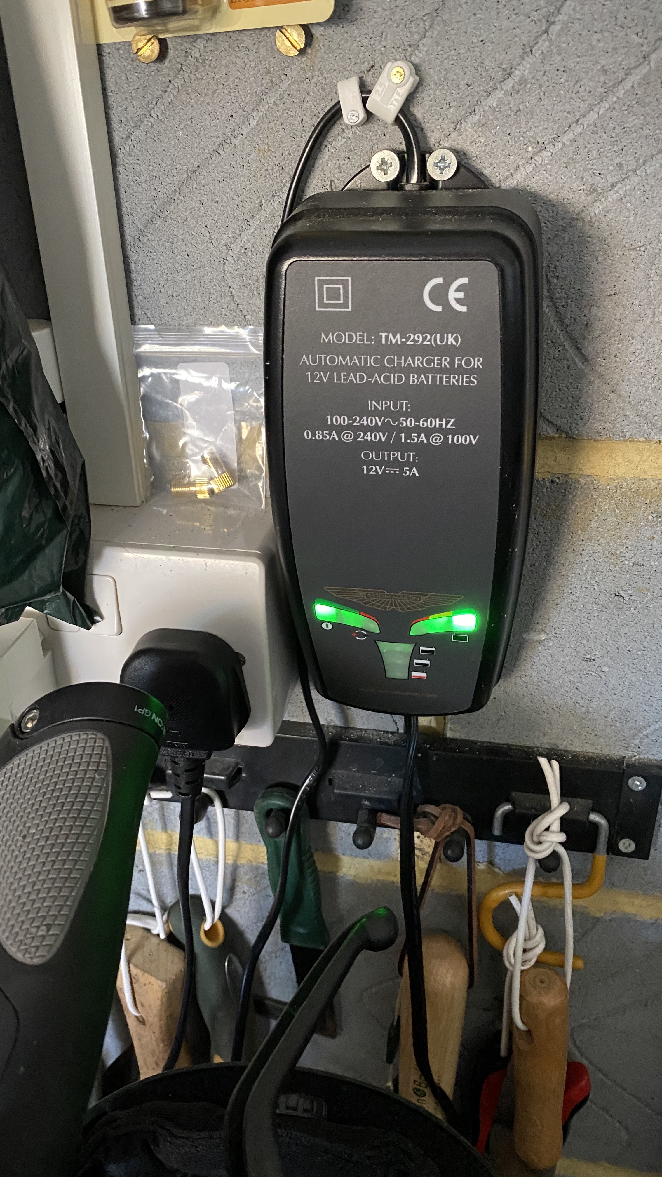

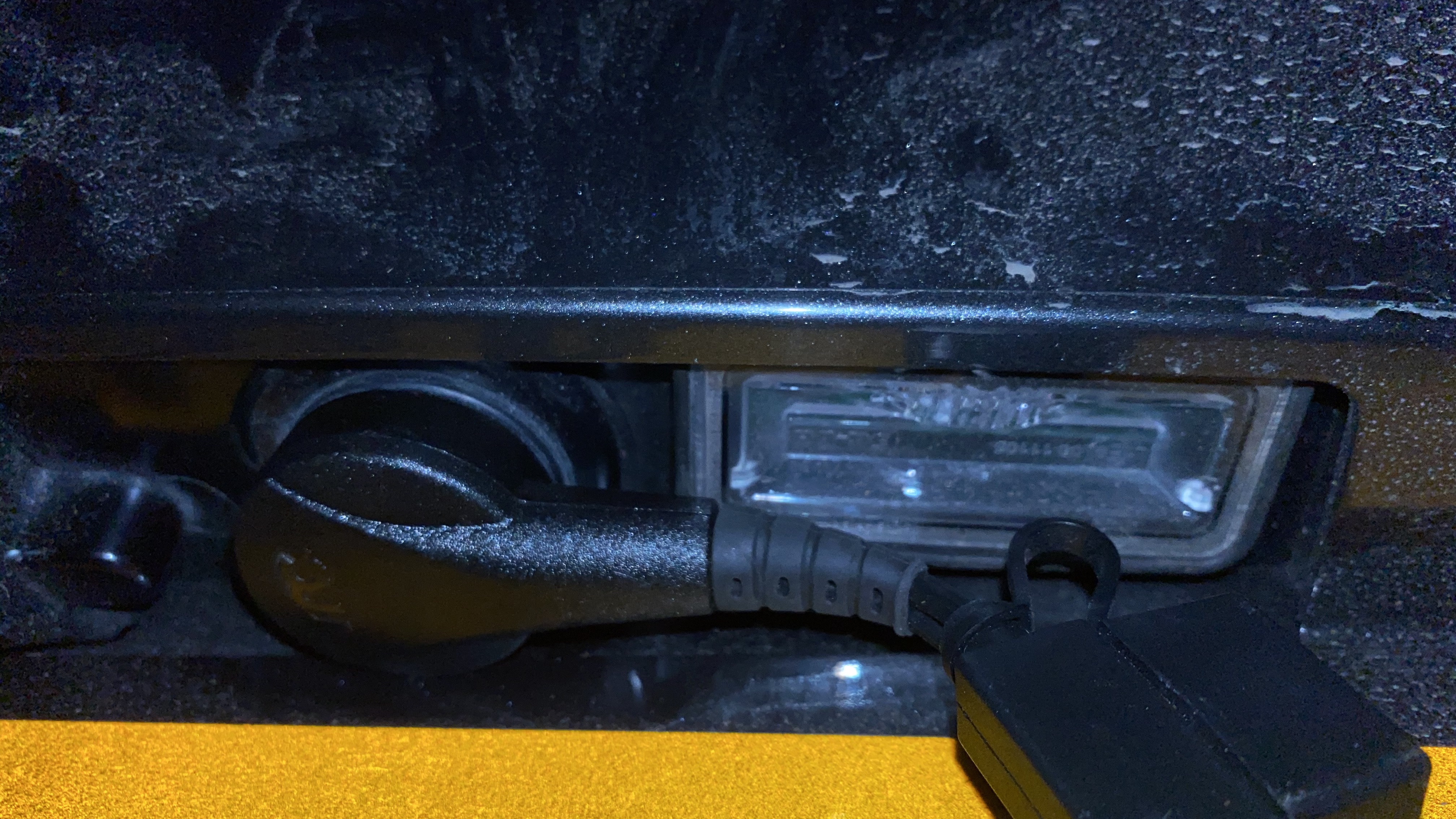

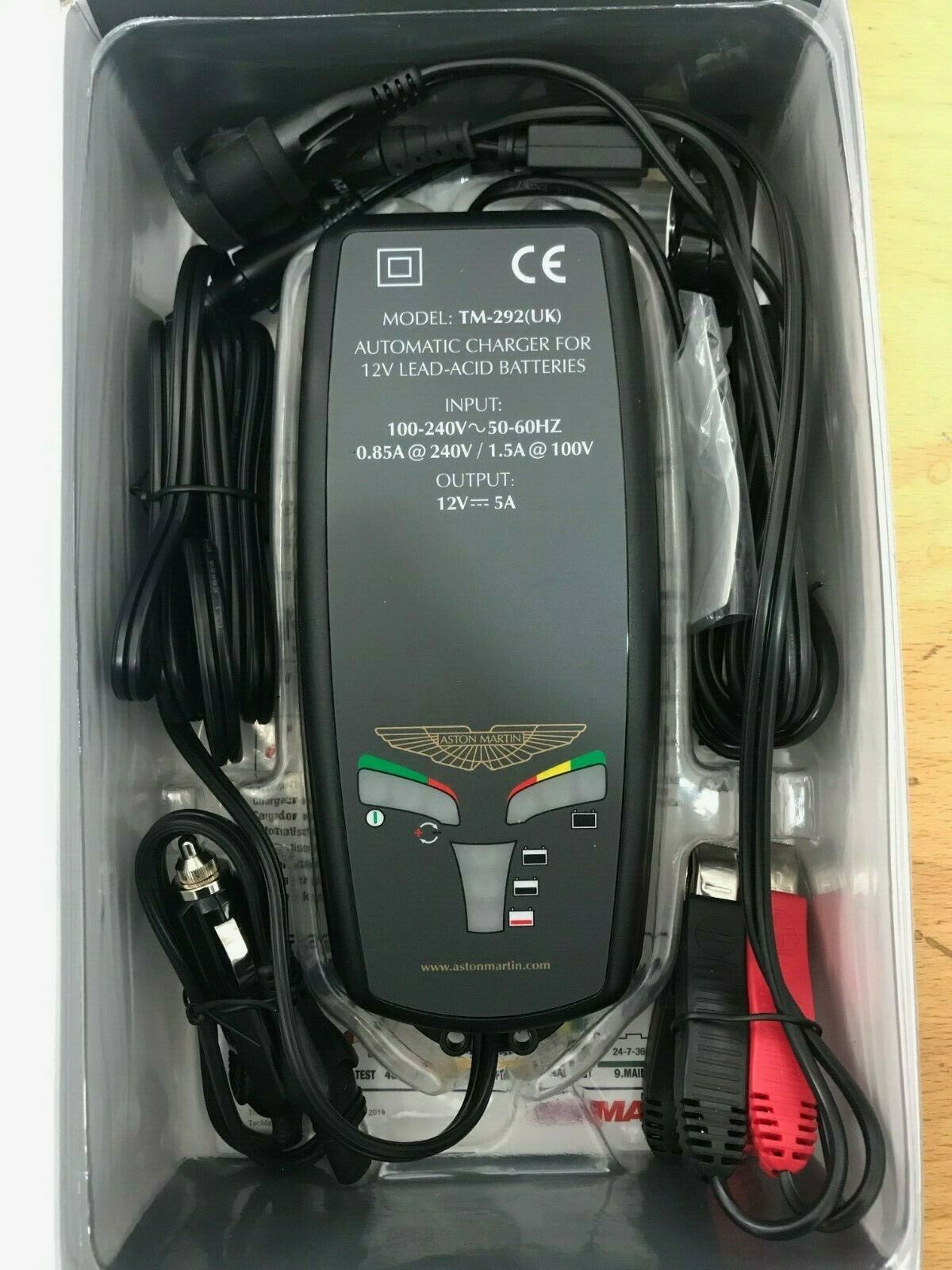

Whilst our Mini Clubman JCW is currently being trickle charged with the CTEK 5 charger, I thought I’d share what I’m keeping the Aston charged with. This dedicated charger has a special magnetic clip (MagCode PowerClip (R)) under the rear number plate that allows easy connection of the charger to the car without opening the car.
It’s a very clever solution (also used on Bentleys and some other cars) and will only connect the correct way round.
The other advantage is that if you forget to disconnect the charger before driving off, the MagClip simply (& safely) detaches.
George.

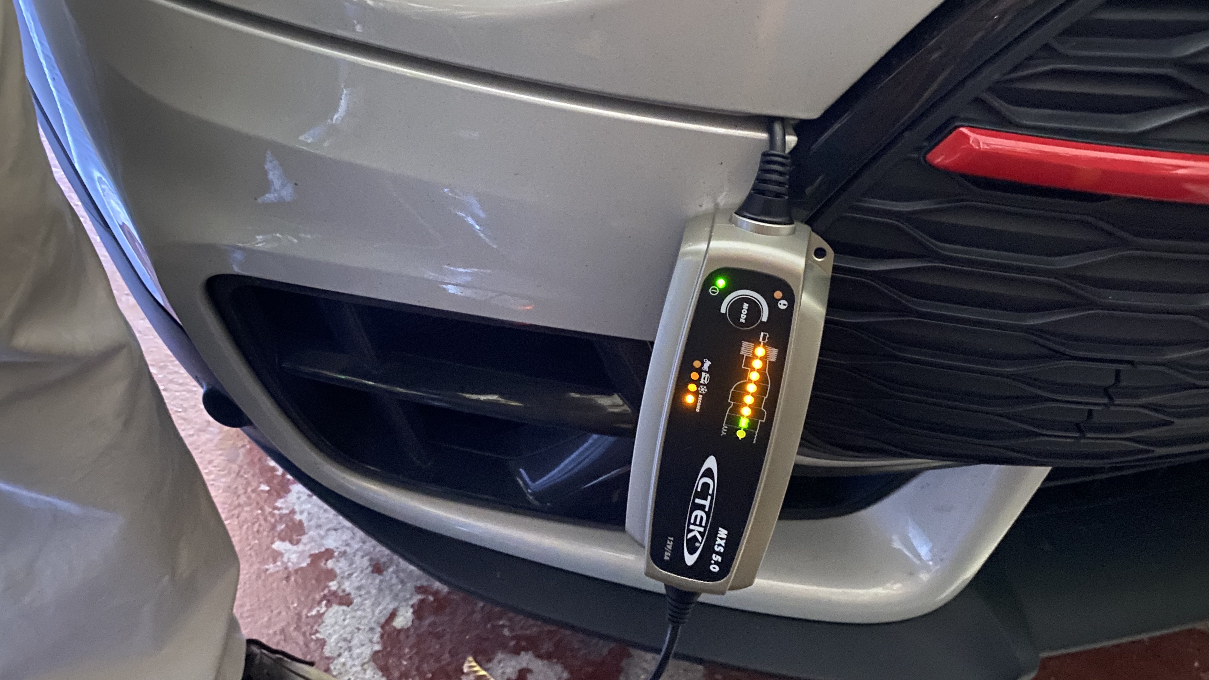

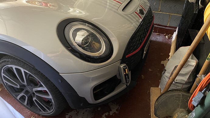

Checked on the battery chargers in the garage today, so thought I’d take some photos. Here’s the CTEK on the Mini;
…and some photos showing the Aston charger & close-ups of the MagClip (R) connector (above the number plate);
Yes, I know, the cars are dirty - on the ‘to do list’!
George.

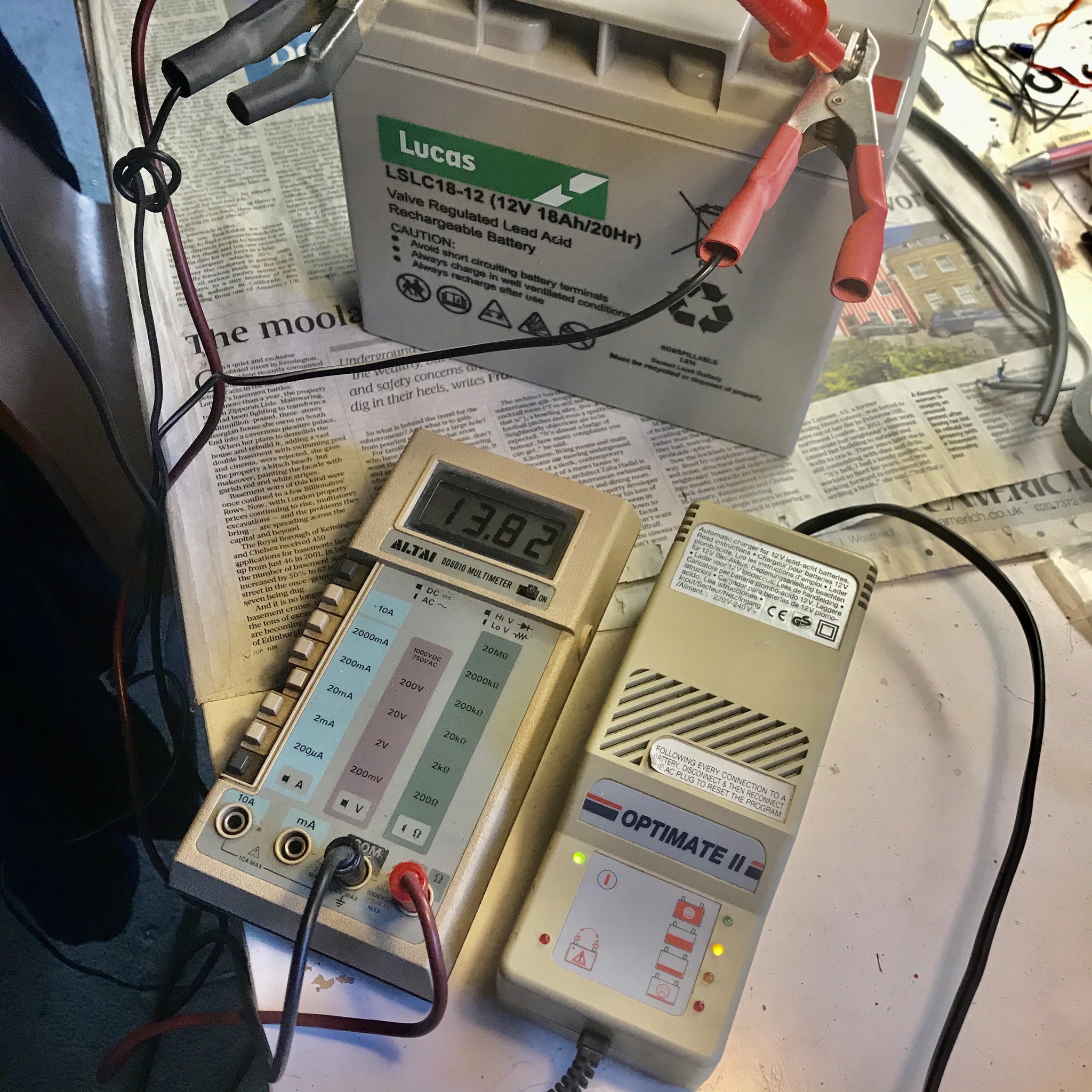

My trusty old Optimate charger (with equally trusty old Altai DM) at work getting a neighbour’s new ride on mower battery off to a good start. She had been going through these (expensive) batteries at a rate of 1 every 2-3 years, because she wasn’t aware of the need to bring the battery to a state of full charge before the winter layoff. Even heavy duty cyclic batteries do not like being left part charged for long periods.
Added audio geek plus point of this charger - it’s got a linear power supply, so one less cheap smps dirtying up the mains :wink:
