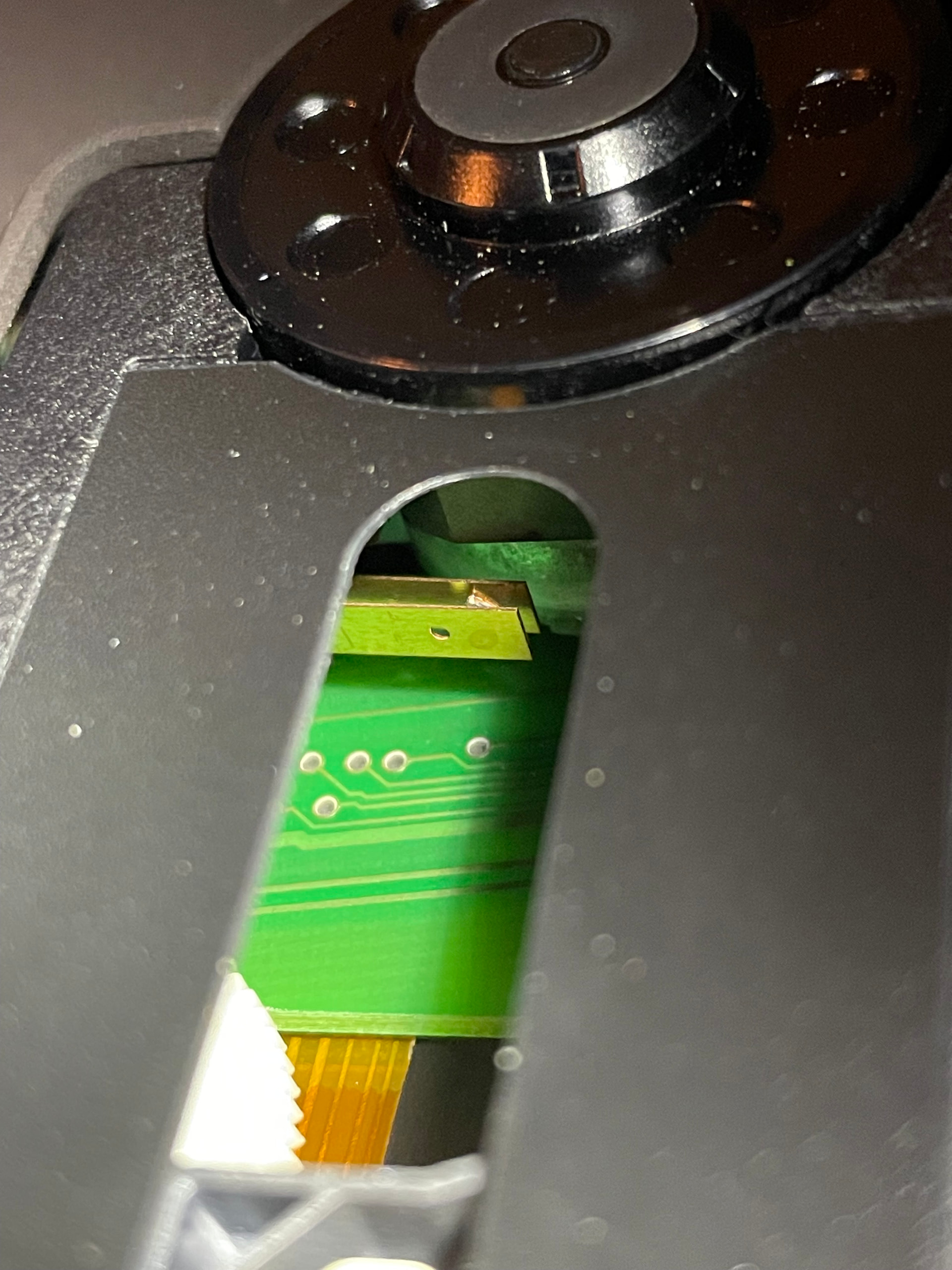

If you index a disc & listen to the sled’s travel, open the drawer when the sled is at its outermost position. Remove the disc & have a look with a torch through the sled slot. Ensure the ribbon is sat completely flat on the bottom of the tray & not snagged on the embossed part.

Not the greatest pic but I’m hoping this is how it should look:
Thanks Chris.
@wardy if you get the timing right, you should be able to get the lens into this position, which will give a better view of the ribbon.

Best pics I could take suggest that there probably isn’t a problem with the ribbon cable.

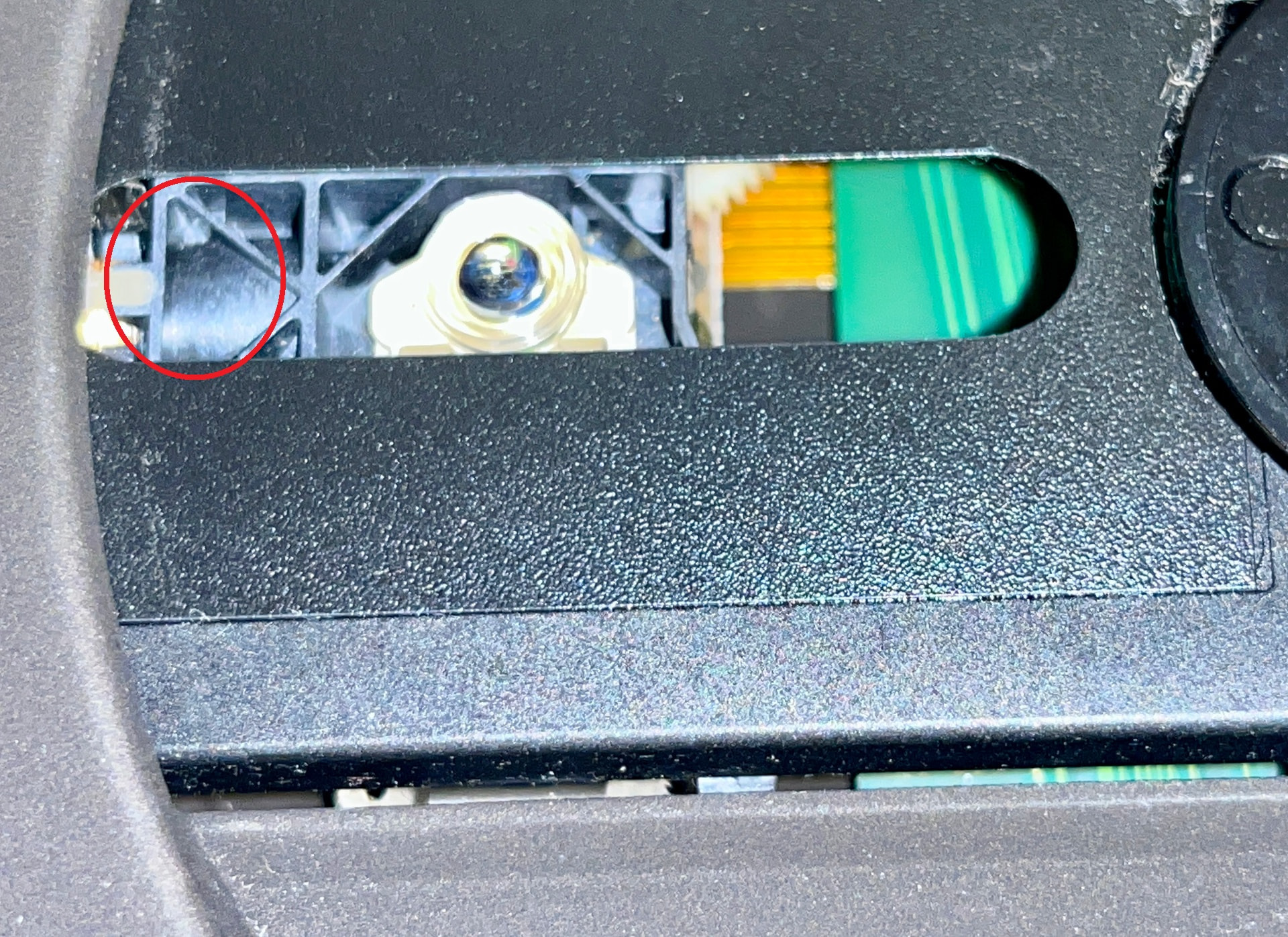

However, something doesn’t look right with that limit leaf switch. I’m not 100%, but it looks like there may be a plastic piece missing.
Any chance you can get another pic focused on that (the copper bit just above the green PCB)?

Is this what you mean @NeilS ?
I did wonder what that bit was for!
Yes - I believe there should be a little plastic buffer on the front leaf.

A quick check and mine looks the same.
Yes, it’s correct - I was thinking of the 1205 last night!
