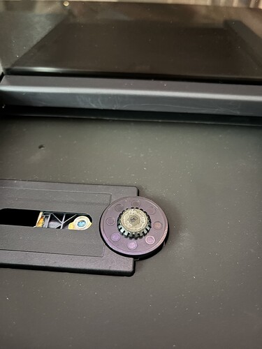

Hi all, I’m new here and recently been purchasing some classic Naim gear. Got myself some mint sbls and recently got the CDs mark 2 with xps.
Simply stunned by the results. I want to check something with you all.
Couple points that might be completely normal and probably me being pedantic.
  1. The puck doesn’t quite perfectly centralise on the spindle so it’s slightly off centre when spinning
  2. The spindle that the puck snaps to looks worn to me and almost as if there is a something missing like a washer, again it’s probably fine.
    Picture attached

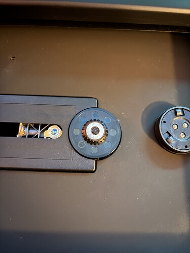

The spindle is missing its metal cap. See here (image thanks to @Graeme , posted on another thread). That’s likely why it’s not self-centering.
Thank you so much, do you (anyone) know how to get a new one. I can affix this on myself i am sure.
thanks again Richard.
You would probably have to buy an old VAM1205 mech and use that for the part. But I’m no expert here so would defer to @NeilS

Originally it would have looked just like in the picture I posted above.

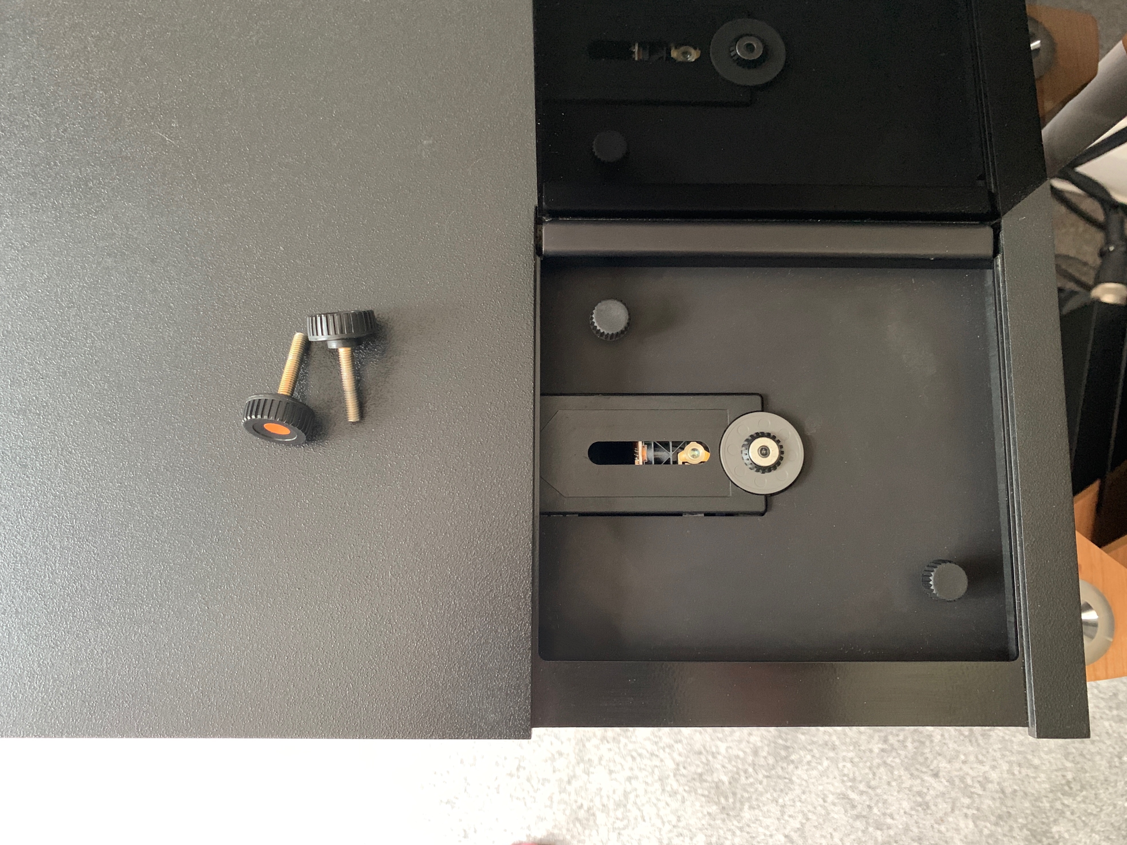

i have managed to order a wheel from the mechanism only from a very helpful & knowledgable person @ quickcycle. just google it as not allowed to add links here.
is it just a case of gently prying off the existing wheel from the motor spindle shaft. i see that the existing wheel has slots in it that i assume there to gently prise off the wheel.

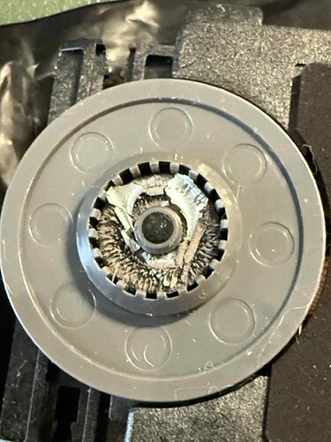

The plating on the magnet ring has flaked off, leaving the ferrous magnet material exposed & wearing down.
The picture above that Richard posted has had a CDM12.4 platter transplant for this exact reason.
You have to be very careful when removing the old platter - the VAM1205 is normally very well glued on, sometimes the entire motor shaft pulls out with it & then you’re really screwed. I would normally cut the platter from the edge through to the spindle once the magnet ring has been removed. Brutal & not for the faint hearted, necessitating removal of the transport from the tray.
Setting the height of the replacement platter is also critical for lens focus.
Not a job I would recommend taking on if you aren’t confident!

Currently I’ve gently sanded the top and sharpied it. So far it’s a simple but effective solution.
0.1mm steel washer works perfectly to protect from anymore wear to the magnetic surface. Cost £2.00!
