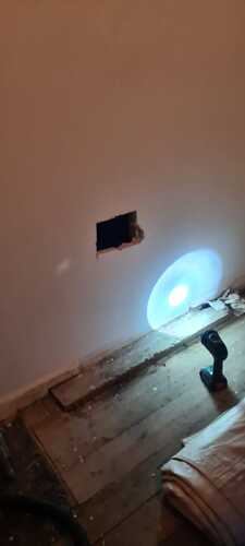

The fireplace is actually boarded over at present, no vent needed as it is open to the loft upstairs, I could even dangle the ceiling speaker wires down it rather than chase up walls:
I have thought about your idea of simply hiding the centre (and maybe even a subwoofer) in there, there is a redundant pipe which will leave a convenient hole for cables once removed too.
Finally yes I have been tempted at times to sell the entire lot, make the fireplace look nice and get nice floor-standers but the lounge is also used for TV based entertainment a lot of the time and we enjoy watching films with ‘proper sound’ as well as music.
