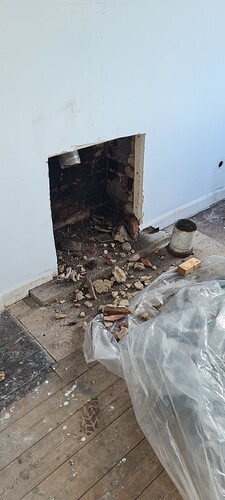

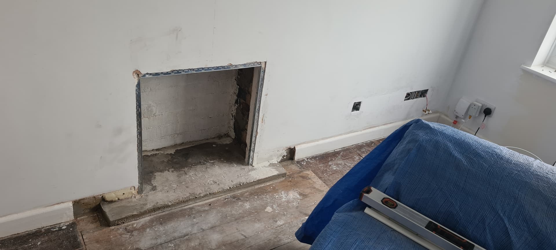

Hi All, I have small living room in my house that I am renovating and thought I would experiment with a space-saving idea for my home cinema using a redundant fireplace I found (chimney has been deconstructed down to ceiling level and sealed off). This option also allows me to have the subwoofer centered between the speakers and sat on a solid concrete pad instead of the suspended wooden floor.

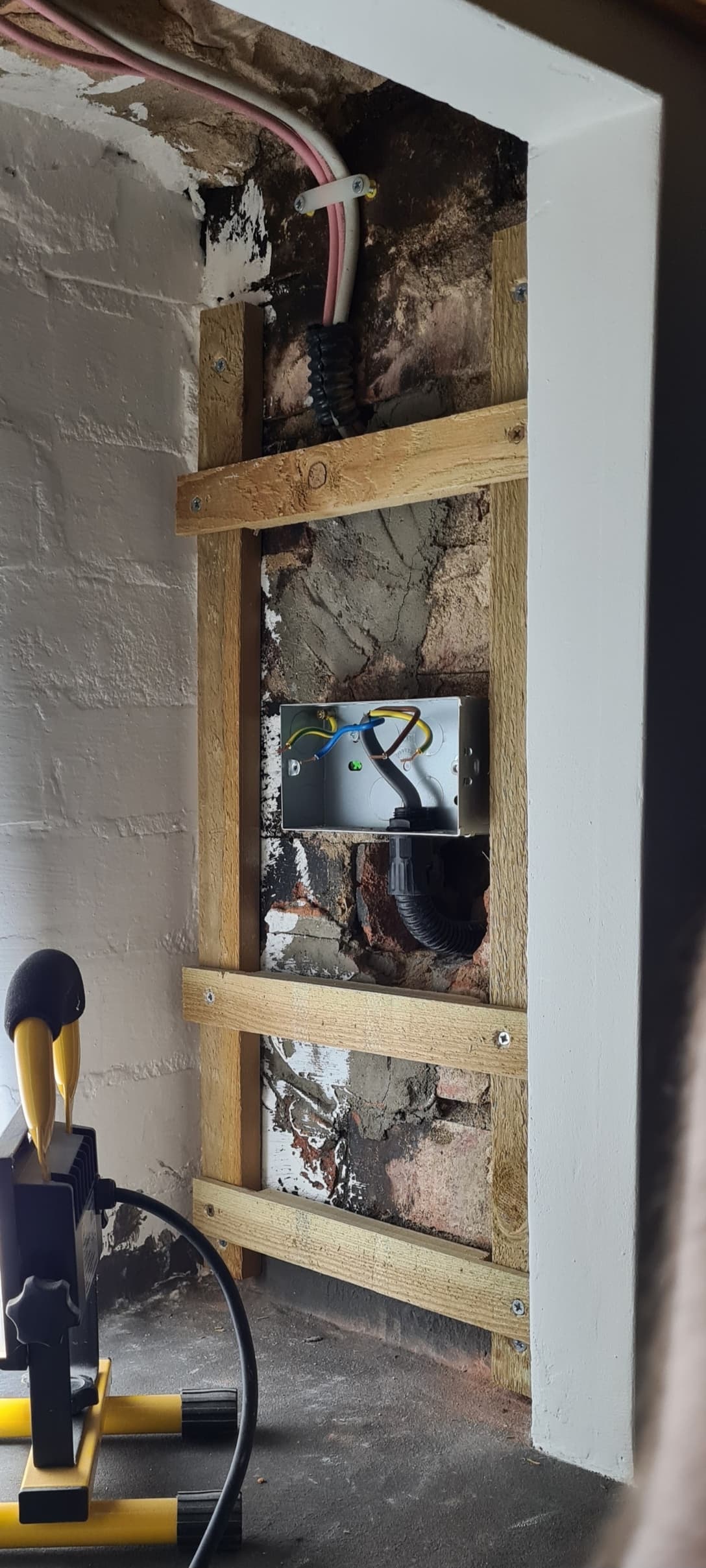

Having opened out the fireplace and tidied it up a bit I realised I could repurpose some of the holes left from the old heating system to hide cables and run them into the chimney:

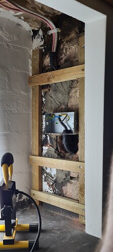

Socket added (fused spur) and mini stud wall framework to support the plasterboard, ceiling speaker cables and ethernet running up above:

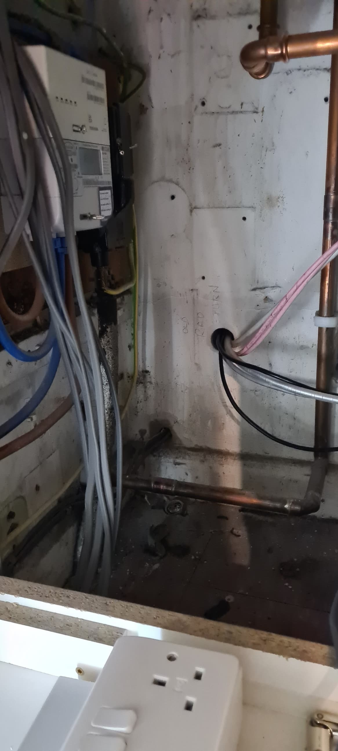

Floating centre speaker added, mounted on wall brackets attached to the chimney brickwork, interior decorated :

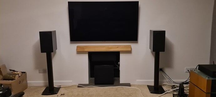

Tested and all works fine, now it needs finishing off:

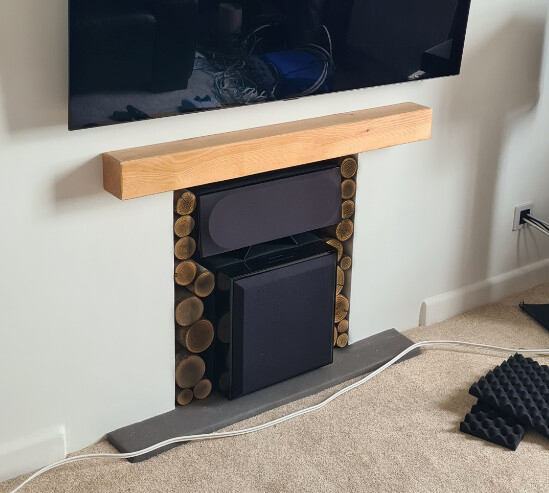

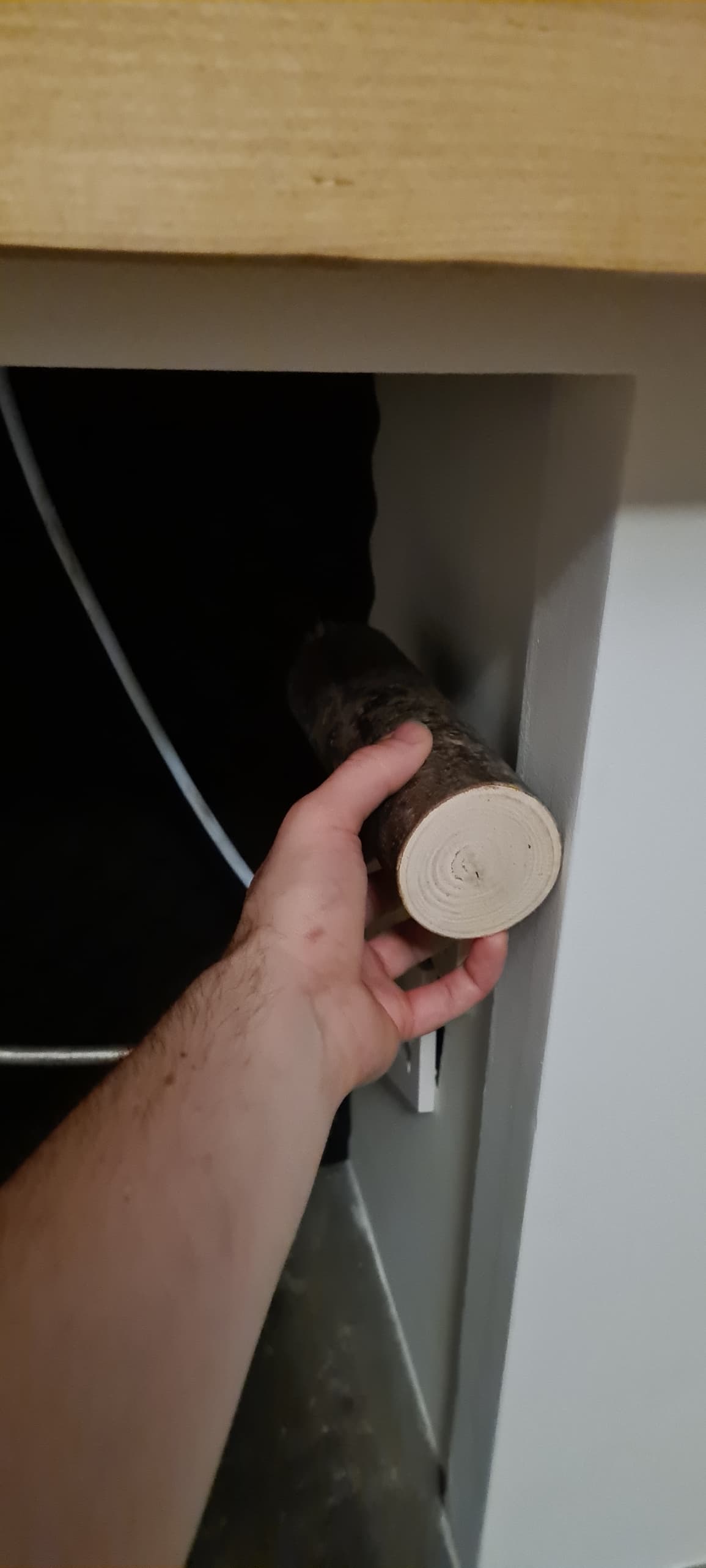

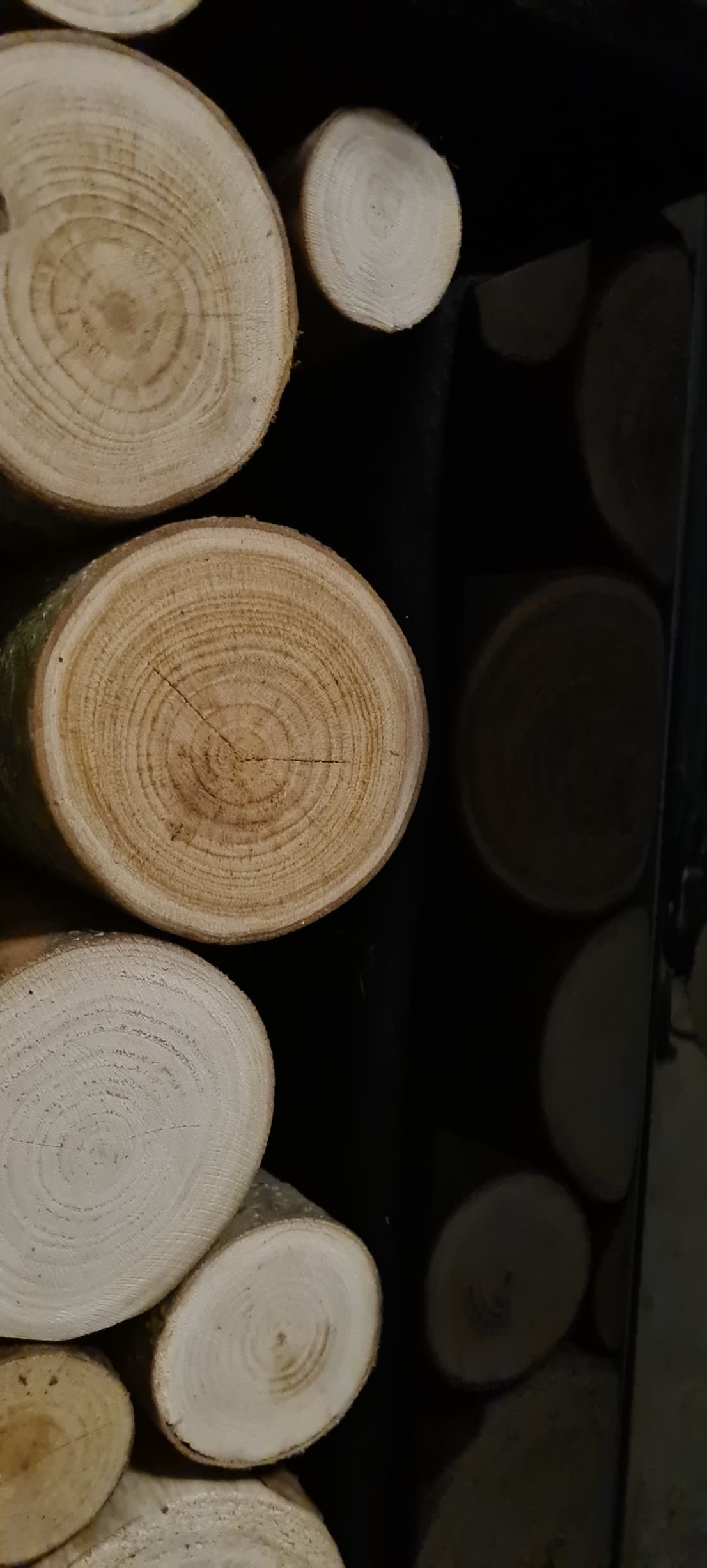

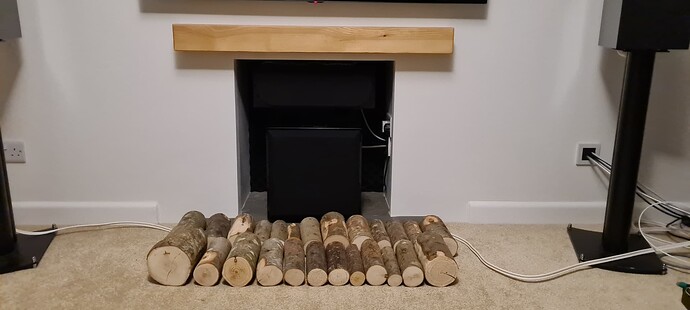

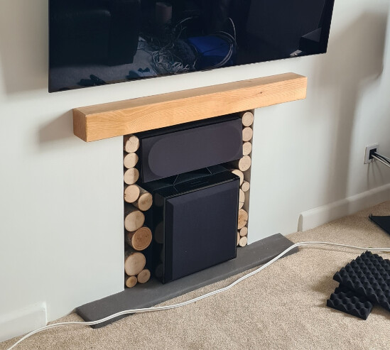

I’m planning to line everything with black felt to protect the paintwork of the cabinets then fill the gaps with some decorative logs so that the cabling and acoustic foam isn’t visible from the listening position:

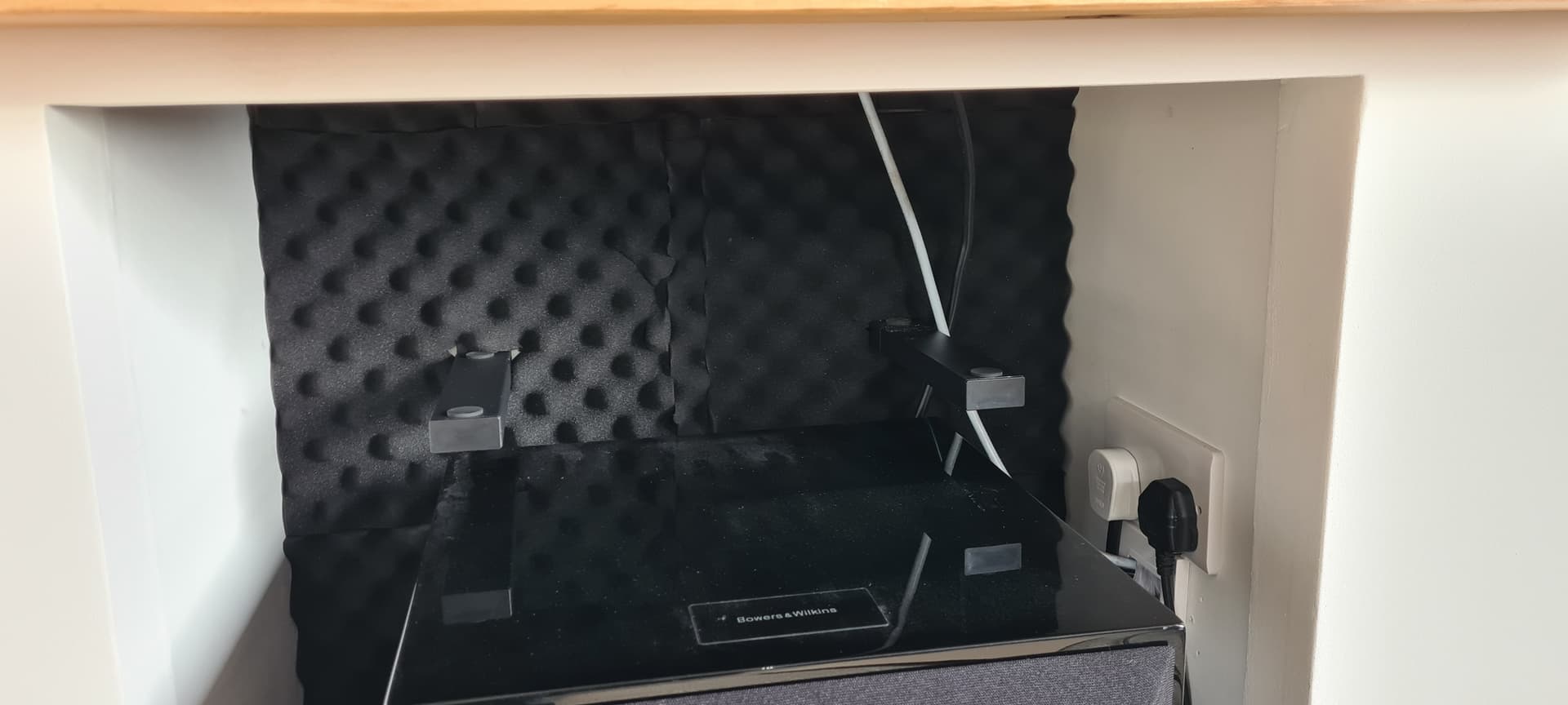

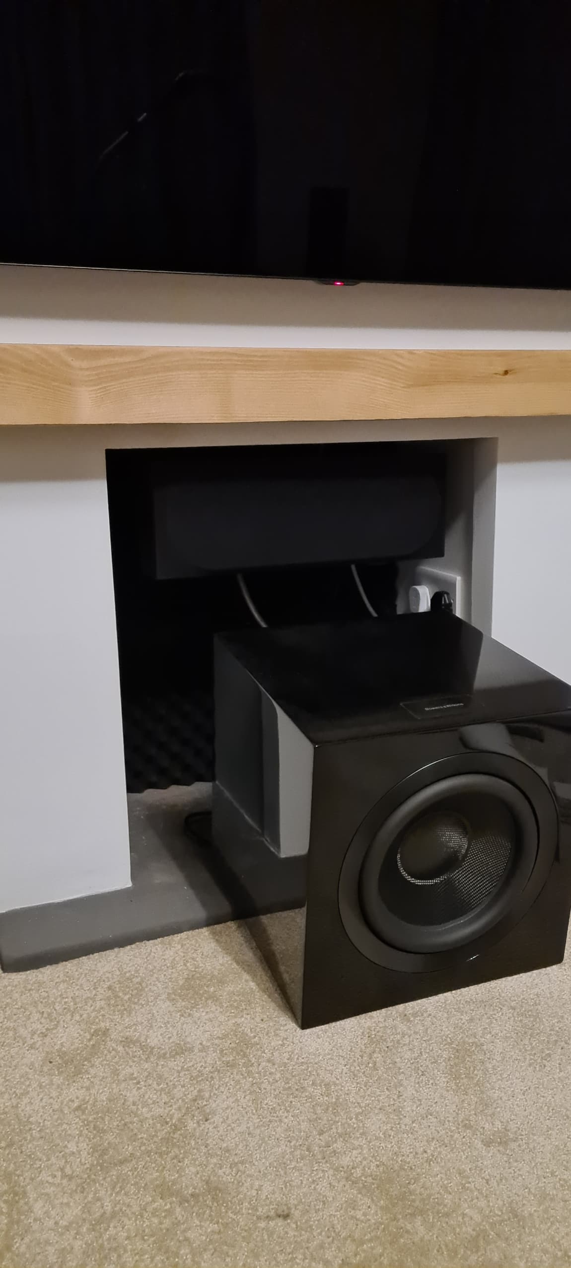

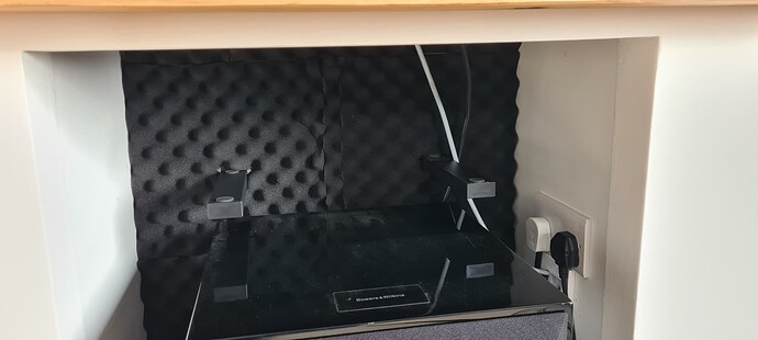

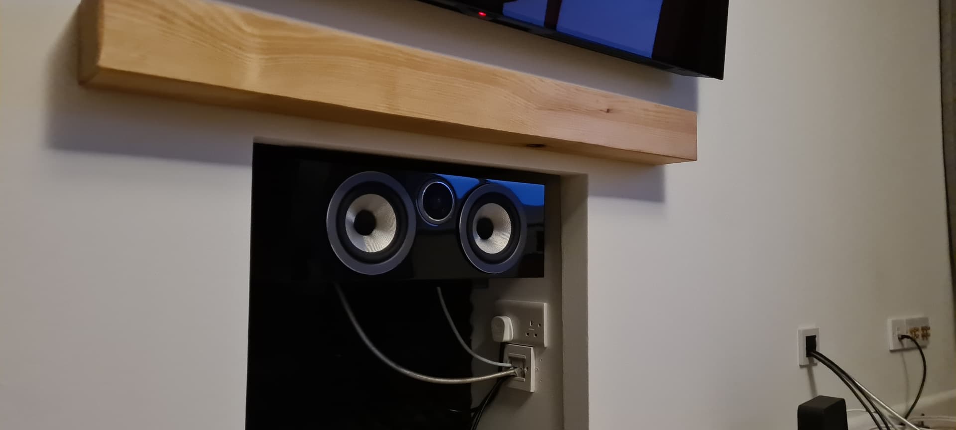

However I have encountered a problem, the centre speaker brackets I fitted are sagging, even though they are meant to be able to support the weight of the speaker I am using so I am wondering if anyone has better solution apart from simply reinforcing the brackets and refitting? Would a old turntable wall-mount be better perhaps? Maybe microwave brackets if doesn’t look terrible?
I suppose another option might be to place the centre speaker on the subwoofer on some acoustic foam but might look a bit naff. If anyone has any thoughts on how to best mount the centre and finish it off I would love to here any suggestions as I’m left scratching my head at the moment.
I thought this thread was going show a DIY speaker utilising the fireplace and chimney cavity!
Regardless, in answer to the support problem, you could fit a full width shelf supported by a battens screwed to the sides and rear? May need sound deadening of the shelf, whils shelf material could be timber or composite board which could also be screwed to the battens, or aluminium sheet, or glass sheet, whatever is available/affordable.
What’s the purpose of the wooden bar across above the opening?
If you want to disguise looks, you could fix a piece of very thin fabric across the hole, rather like a grills cloth, whether black, same colour as wall, of anything else.
Nice idea. The subwoofer on the concrete will make a big difference.
I like the idea of the centre speaker suspended by the bracket, so I would be strengthening it or changing it, rather adding than any shelf. Definitely don’t put it on the sub.
I would have tested the sound before adding the foam behind.
I think adding materials on the inside would look tacky. I would be lining it with some sort of natural black/charcoal wood paneling. It needs to look professional and part of the room, not some sort of velvet material.
Ideally, I think the inside of the fireplace should be plastered just like your wall.
You could install a light behind the sub and that could look good.
As I say, nice idea and it could look very slick. Don’t ruin it with a cheap diy finish.

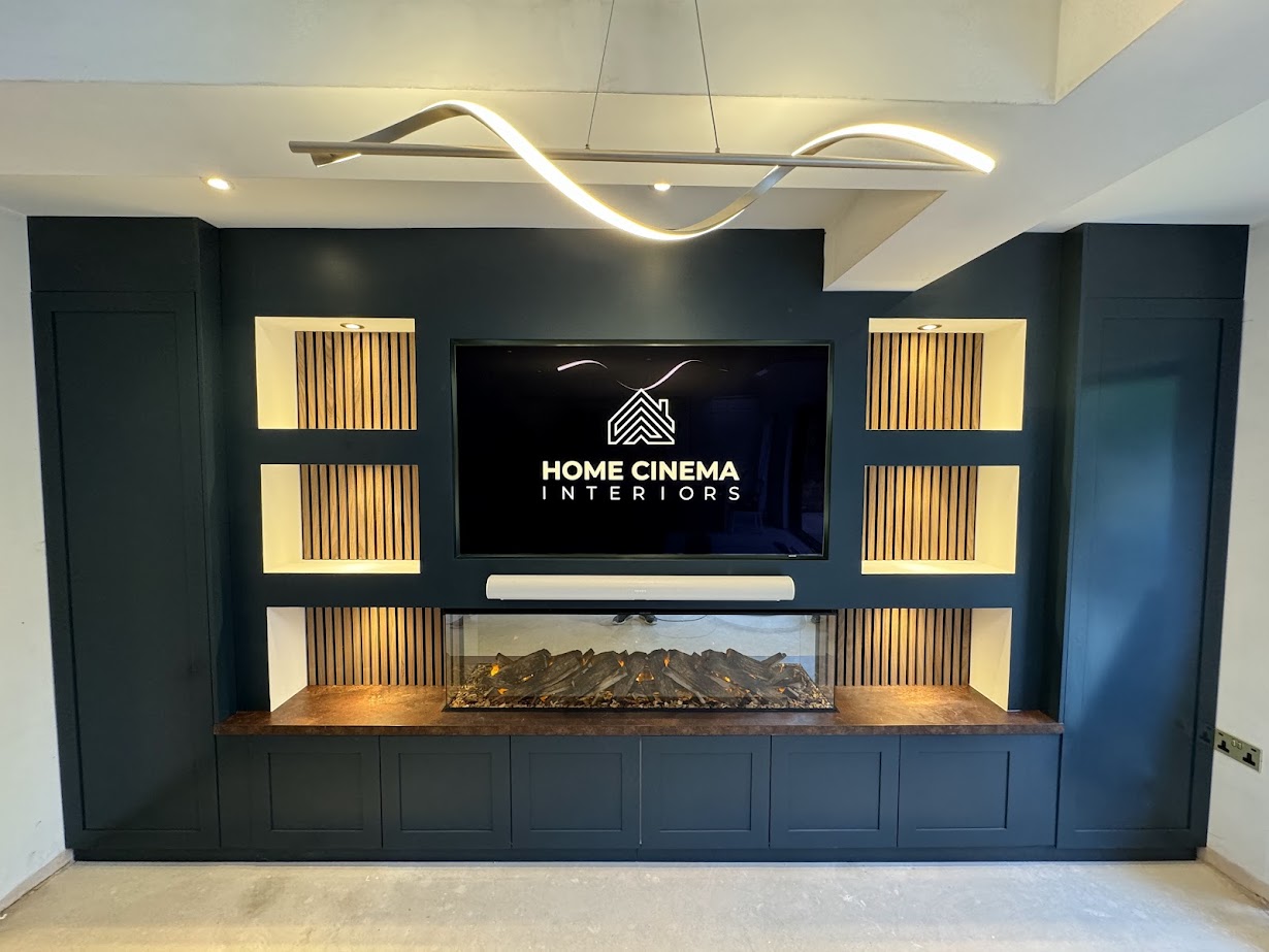

These sort of images give you ideas. There must be loads of ways to make it look great. I wouldn’t rush it. It could either look great or naff.
The wooden bar is just a decorative mantelpiece. I have already plastered & painted to match the room the inside of the chimney but I’ve just stuck the acoustic foam to the rear to prevent it being an echo chamber as the centre speaker is rear ported. I did consider switching the subwoofer out for a build-in one, not a completely custom one but an ‘in-wall’ type with a back-box as I don’t know much about designing a speaker cavity.

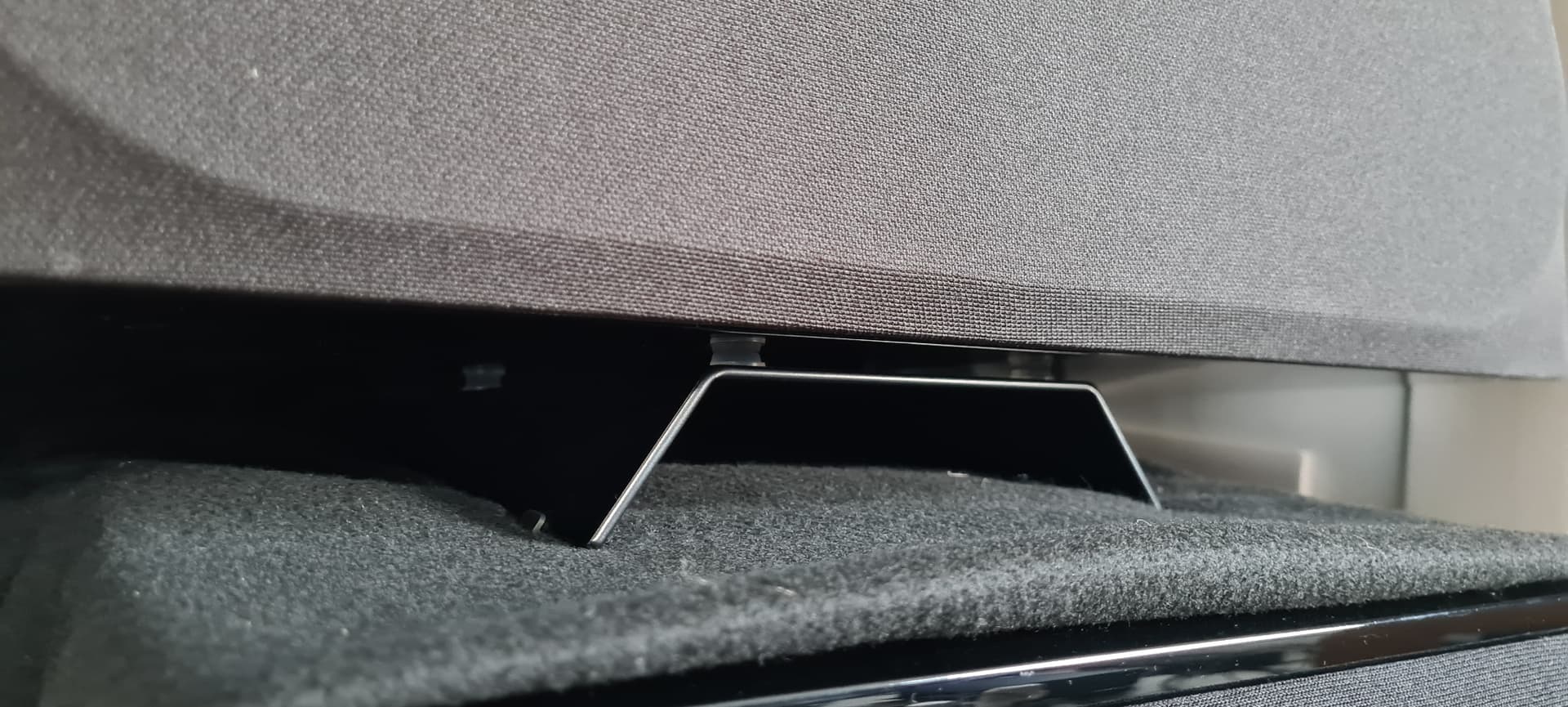

I experimented last night with the centre speaker on a speaker stand (Dynaudio SF1) on felt on the subwoofer which allowed good clearance and the centre speaker to be angled up towards the listening position. The subwoofer (DB4S) weighs 26 kg (57.3 lb) and seems to be a pretty solid platform - what are the problems with placing the centre speaker on a stand on the subwoofer?
It sort of works, you cannot see the felt in the evening when the room is dimmer but I think the whole setup it sort of looks weird at the moment, back to the drawing board!
I shall give some of the suggestions a go, thank you! I might simply put in a sturdy shelf, remove the logs and hide the cables some other way - Monitor Audio say they will sell me a glass shelf that matches my Blok Stax hifi stand, maybe that would look better.
As you asked for ideas, I’ll give you my preferences and taste.
I don’t like the logs.
I think it should look clean and professional as per my previous posts.
There should never be anything sitting on a speaker/subwoofer. If it’s a decent sub, the cabinet is part of the sound.
If it’s just a rear venting port, there’s no real sound coming out of that, no matter what you read. It just vents the pressure.
I appreciate the honest opinion! The logs are a bit of an experiment but don’t work in reality like I thought they would in my head, too many odd gaps etc.
A proper shelf that looks smart I think is the option, I’m leaning towards installing some much heavier duty brackets then adding a tempered glass shelf.

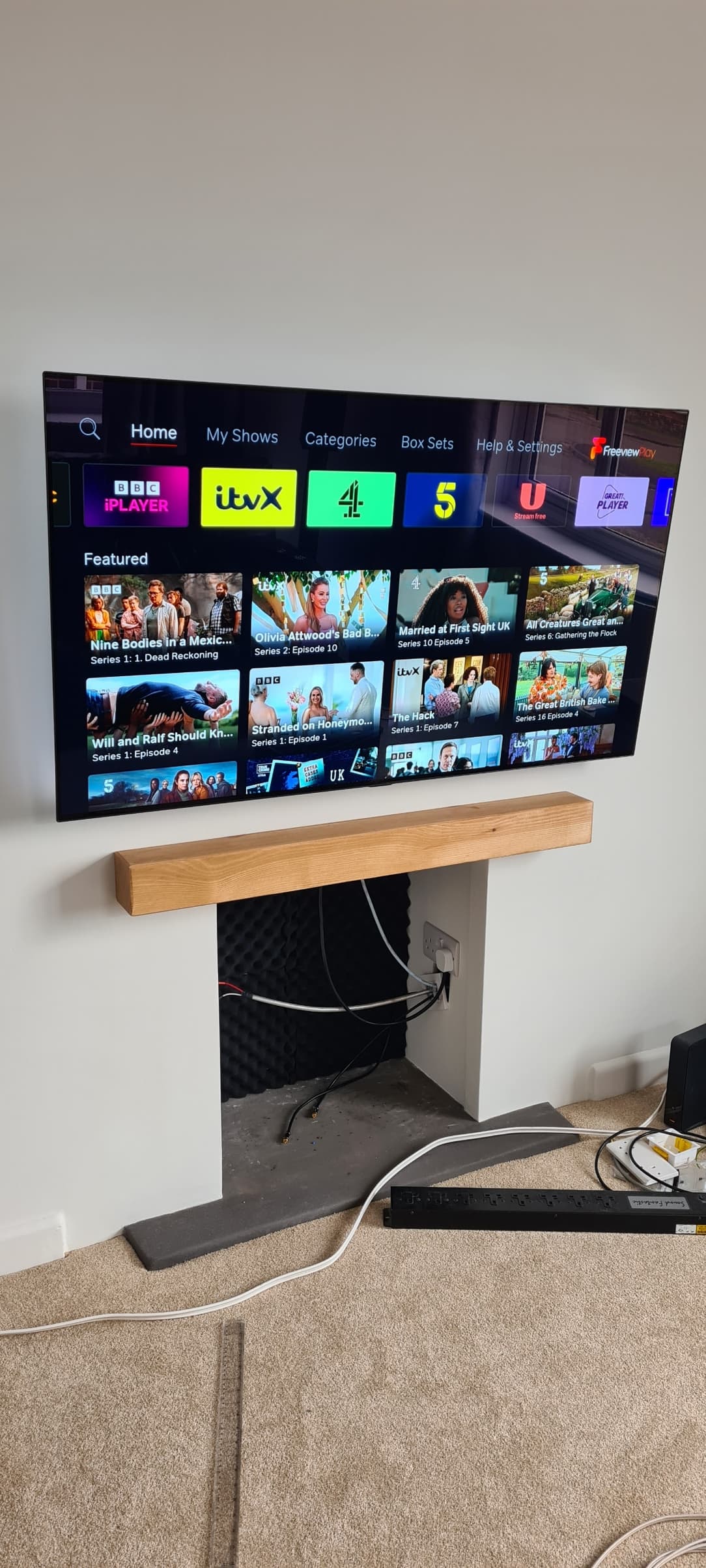

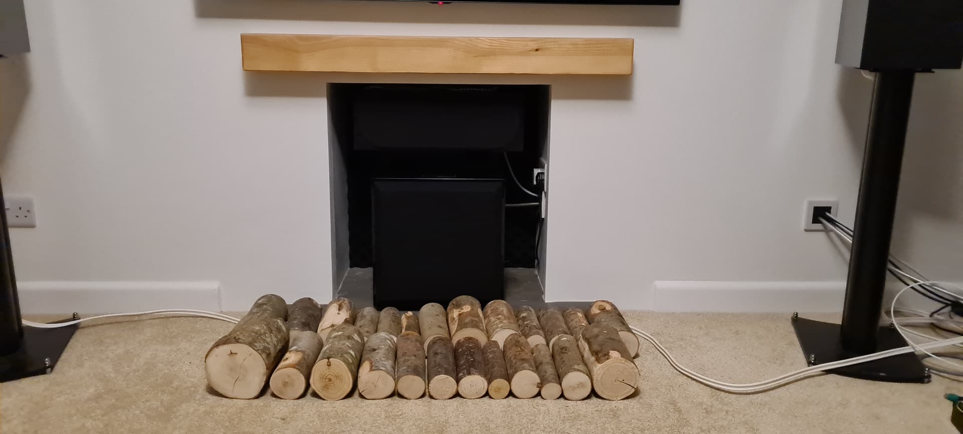

Question is how to make this look clean and professional like you suggest (I agree), might move the cabling and socket around to the back so it is hidden behind the subwoofer, tidy up the brickwork and paint with black masonry paint. I’ve got plenty of plasterboard offcuts and matching paint for the room left over to play with:

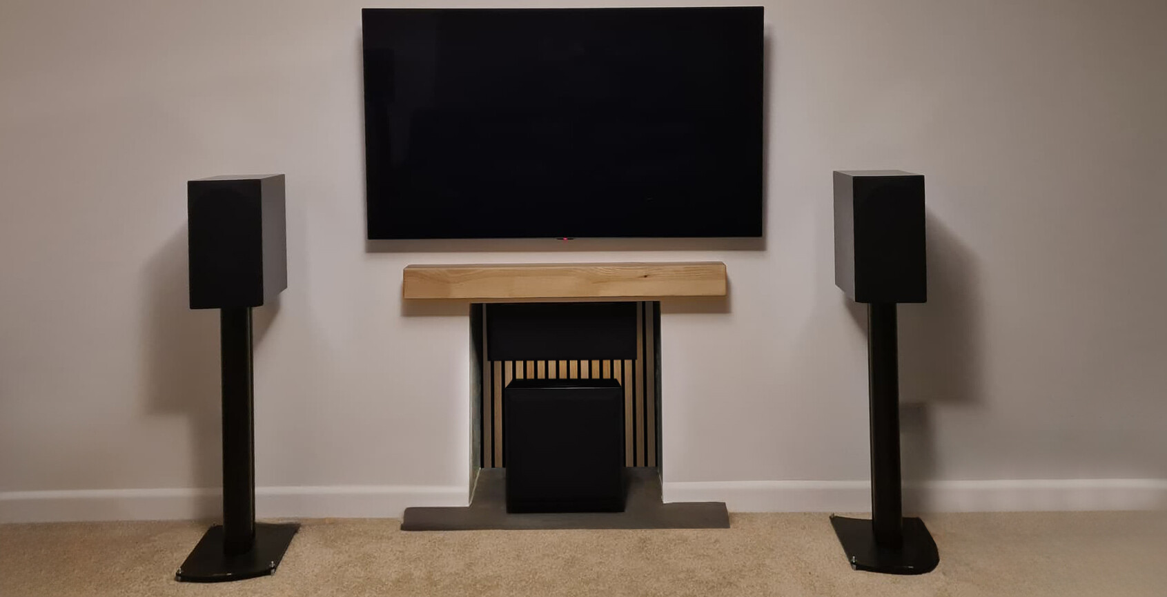

It’s quite a long way off at the moment from something like this but with the centre floating and sub on the concrete slab!
I thought you could perhaps try darkening the logs - e.g. with a blow torch, but after a quick photoshop, suspect not
Just looking at one of those pic references I posted, yours could look a little like this. Obviously I’ve just stuck any old panelling behind with some brightness added for a light, but it gives you something to think about.
I think the not quite mantlepiece and the logs create an odd impression, a sort of imitation fireplace. I would have thought better not looking like a fireplace at all, otherwise perhaps if there’s enough space put in a metal fire basket cut shallow with a couple of logs in it front of sub if there’s space, a hearth stone in front (which to look right I think would need to be deeper than the one you have) bearing a basket with logs one side and a set of fire irons the other. Oh, and in my view a more realistic mantlepiece(sorry!).
One of my sons has used a fireplace of similar size for AV electronics, which looks fine just appearing as an open inset cupboard in the wall, painted matt black to sides and behind so you only really see the fascia of the electronics. He also has the TV lower, actually slightly overlapping the top of the opening, making for more comfortable viewing.
Outstanding. You even tided up my nasty cable nest thank you!
I appreciate the effort with the alternative look, thank you!
Thanks. I do like the idea of the log basket or something fireplace themed for aesthetics. I’ll probably keep the pretend floating mantelpiece, I tried it without but I thought it looked odd because I didn’t remove the hearth. I was wondering whether to remove the mantle and move TV down a bit. I mounted it on a tiling bracket so it is angled down slightly to avoid reflection and is viewed ‘square-on’ from the listening position. All useful ideas/feeback thank you.
