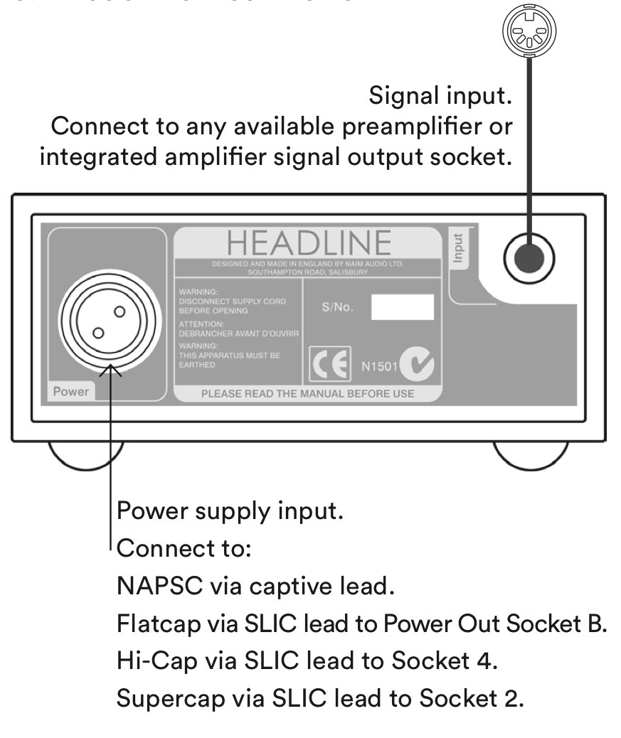

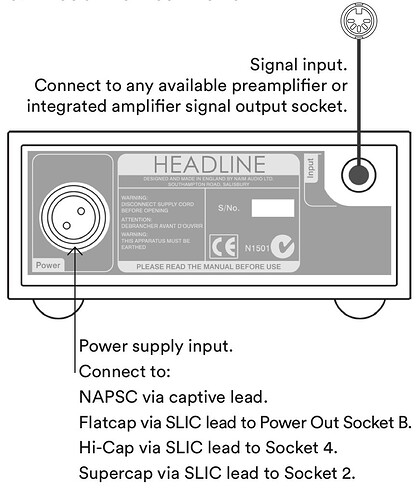

You can’t get any cheaper then the Supercap DR you already have @Lipper , you just need to add a SLIC lead if the Headline doesn’t come with one.
That goes directly against the headline manual.
And also forum advice going back eons.
Also some more recent threads
Ahhh, yes your right @IainO :face_with_hand_over_mouth:
NAPSC is the cheapest option then.
