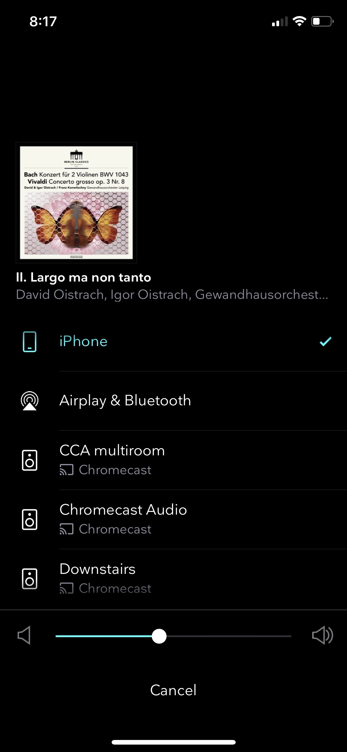

I do not think that this is the case: the Idagio app under iOS, for instance, supports both AirPlay and Chromecast. By contrast, the same app under Android only supports Chromecast.
I stream to chromecast from Tidal from IOS with no problem. And it accepts Master quality.

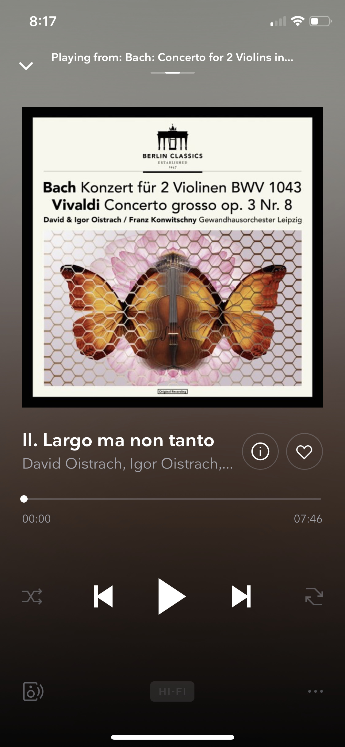

This may be stating the obvious but you know the
Cast option only appears if you have the track youâre playing on your screen right? If you stay on the home/option screens, or an album with track
listing youâve opened, the cast box doesnât show.

An iOS device will, unsurprisingly, default to AirPlay rather than Chromecast, but it still works. I can use it with a number of apps, including BBC iPlayer, Soundcloud and Tidal. I think the Tidal implementation is poor in that you canât select a Chromecast or AirPlay output until you have started play. The icon you tap to select external outputs will only then appear in the screen. Shoddy, but it works.

The problem is that the chromecast icon does not appear
With the same version of the same app?
