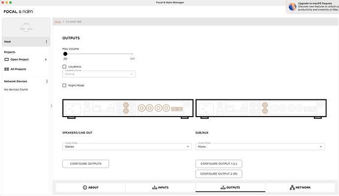

CI102 party tricks - it has a really nice processing chain. Couldn’t spec it better myself :slight_smile: Dual output, fully configurable filter set, output limiters, time alignment, subwoofer filters, night mode, it goes on and on. Plus had I mentioned 64bit processing which makes this super transparent when dealing with the lower and higher frequency extremes.
The benefits of this precision processing is that if you have the patience is make a so-so set of speakers sound pretty good based on tuning with the dealer app. It can dial out so many issues.

How awesome it would be if Naim could made a HDMI input 5.1 DAC… @Stevesky
https://www.naimaudio.com/focal-naim-manager-ci-uniti-102
Is the link to the Dealer App software mentioned above, including the user manual, for folks interested. Seems optimised for Focal speakers, but also hints (IIUC) that the profiles are just pre-sets for parameters that are individually configurable for a non-Focal speaker… if you know what you’re doing.

@Stevesky, what exactly does the night mode filter do? Suppress loud sounds? And is this selectable with the user app?
No idea what it does, or if it is selectable with the user app, but it is selectable with the focal naim manager software. The manual for the manager software doesn’t really tell you all that much. I wonder if dealer training is provided, or there’s more detailed instructions available to professionals.
